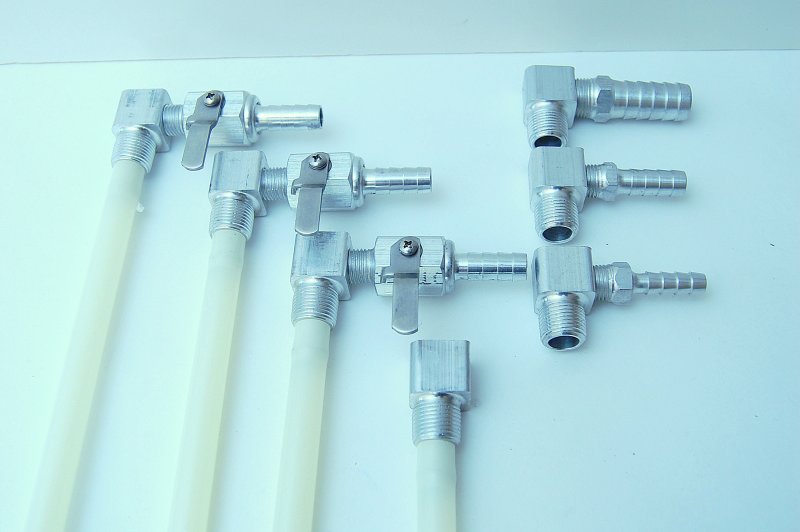

#7 Do not use copper alloy based tank fittings threaded directly into the tank. Not only is against the ABYC standards it can accelerate corrosion issues. Aluminum tank fittings are available from Luther's Welding in RI 401-253-5550 for a very, very reasonable sum.
