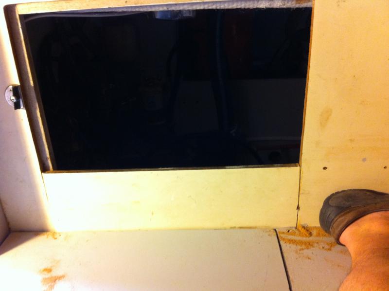

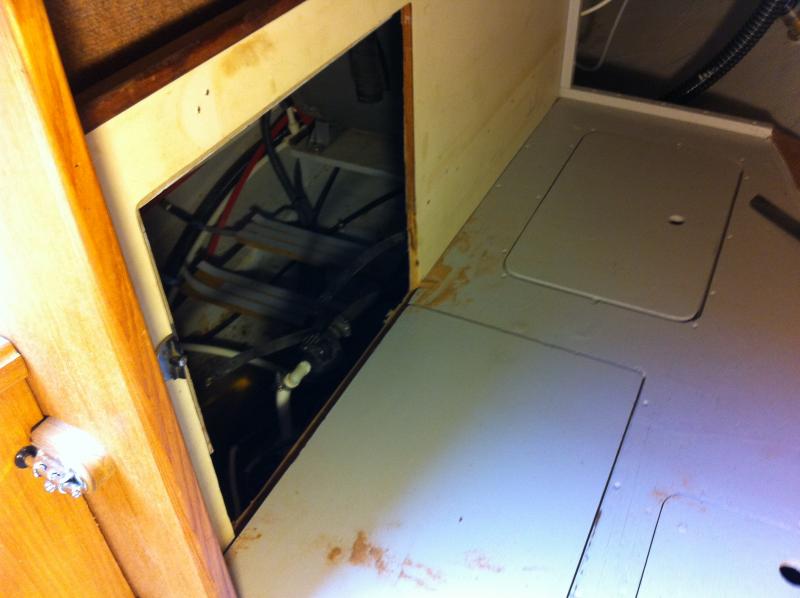

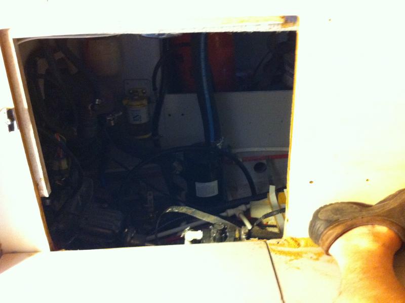

the access hole in the quarter berth to the engine room is to small in height but wide enough if you take out one of the backing flanges on either side and cut the area below the hatch hole to flush with deck of the quarter berth....this take a little carpentry and some innovation on my part but it is a lot easier than any thing else
...so now the tank is out and in my shop weighting my decision on repair or replacement ....
the repair work on the bulk head is no big whoop ...i will just cut a new door and reface it with plastic laminate and be done with it ...
i will try to get some pic's of this for all some time this week end...oh and another thing by doing the cutting of the panel it also makes it better for working on the stuffing box and shaft coupling ....its about 5.5 inches more room in the hole and when bent over doing the work you don't have that panel cutting you to shreds laying across it .....

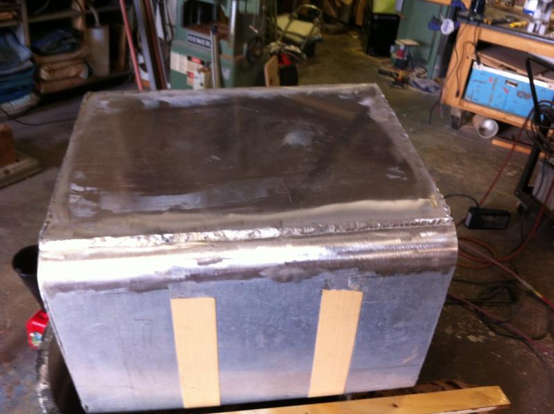

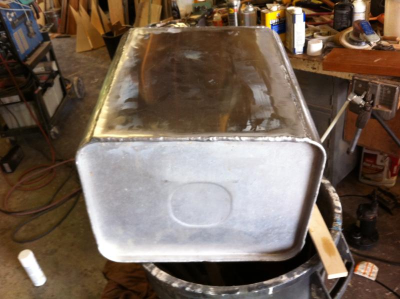

thanks for the sound advice Ralph.......thought about this a lot over the last 2 days and inspected the tank with a goose neck camera ....all the corrosion was in the flat bottom part of the tank ....so i got a 15 x 20 inch 3/16 inch aluminum plate from a fab shop here and welded it on the bottom of the tank 100% all around ...then i tested it with 5 psi air pressure with 2 gallons of fuel in it ....had no leaks and and everything seems to be good to go so for now its repaired and in the boat as i type this ...the corrosion i found was only where the tank sat on the supports........ pics attached...

Mine leaked where it was in contact with the support. There was a clothlike material between the tank and the strap which likely supported electrolysis. I would eliminate that and substitute something else.
