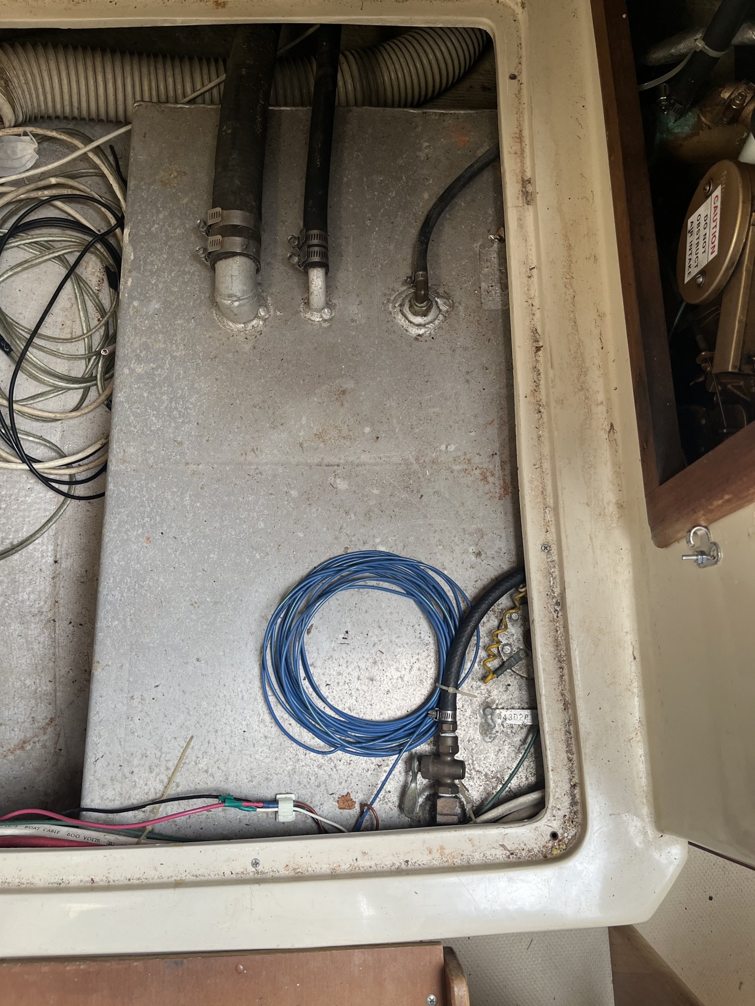

My engine died due to lack of fuel (my assessment). I put in biocide the prior week (and once before about 1.5 years ago), and either that loosened some crud or maybe it was just time. I have had flawless engine operation for the 2+ years of ownership. The prior owner let the boat sit idle for 5 or more years. The 15 or 20 gallon tank is 1/2 full if the gauge is correct. I bought new filters at end of last year but 'deferred the maintenance'.

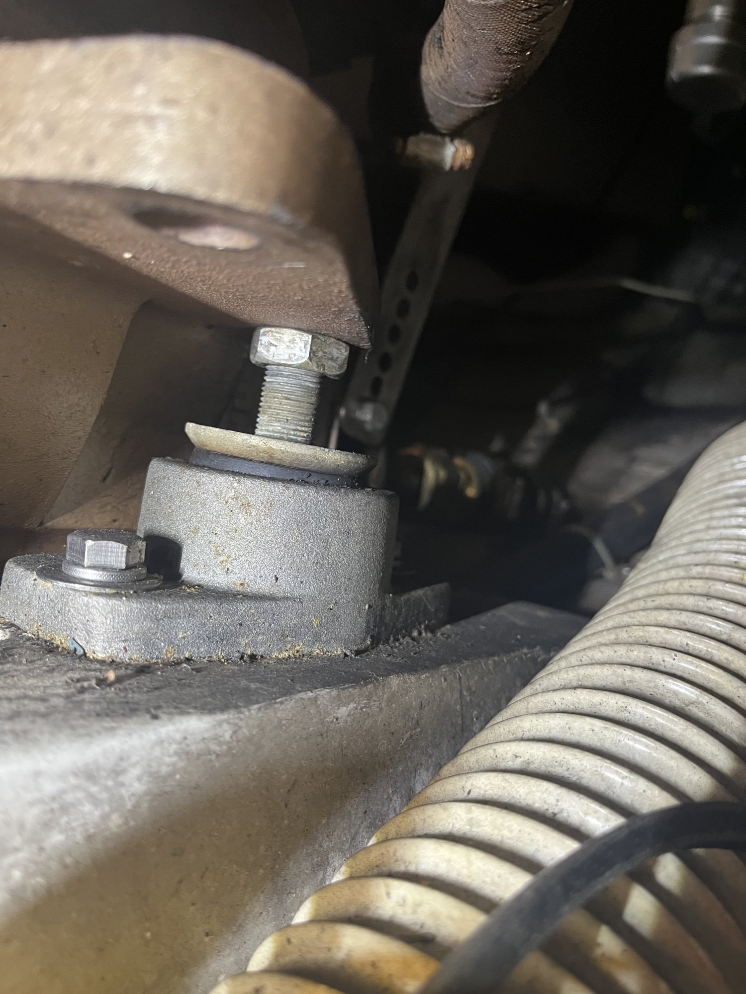

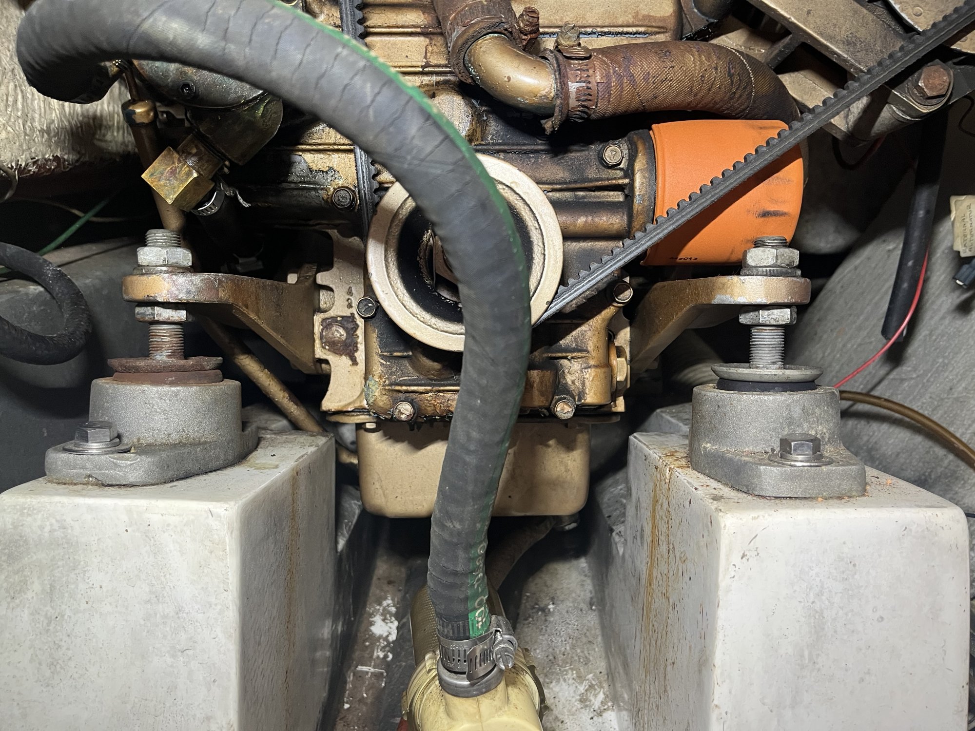

My second concern is the condition of the engine mounts. See pics below. I have lots of vibration at high throttle and believe I did not align the engine well enough. One reason on the alignment is the fuel tank is so close to the aft starboard mount, I get maybe only 5 degrees of throw on a wrench.
I will replace the fuel filters in all cases. I am on the fence regarding the mounts and worried tank crud will re-clog the filters.
Possible solutions are:
1. Remove then restore the tank. Easier cleaning. Maybe add access port. Provides room for engine alignment.
2. Replace the tank with smaller. Same as above. Boat is on lake. 5 gallon tank gives well over 15 hours of run time. leaving and returning to slip takes minutes. Smaller tank, less fuel, less breathing and condensation, less bio growth
3. Leave the tank, and dump in some Sea Foam (recommended by my nautically knowledgeable nephew who has worked on every engine out there). Shift the tank an inch or two away from the motor mount to accommodate replacement. I will have to cut a fiberglass lip that is meant to keep the tank from moving. Can restore that after.
4. Dump in some sea foam. Ignore the engine mounts
It is quite possible the filter replacement will solve the issue. But I cannot see in the tank. I might be able to borescope it.
This is an old C27, so there is no room anywhere, and options 1 and 2 might be too much effort.
Thoughts are appreciated.

We'll defer to you to research the manufacturer of those engine mounts and see what they say regarding replacement. Without anything else to guage by, I would suspect it's based on the current thickness of the rubber pad.
14,127
To peer into the tank, remove the fuel level sender. There are 5 bolts securing it and a nitrile gasket. You won't see the whole bottom, but a good portion of it. That can help guide your decision.
Other wise, continue using a biocide, BioBor JF is probably the most effective as rated by Practical Sailor several years ago. Look for sales on fuel filters and keep a couple of spares.

24,696
Just above the tank serial number near the fuel valve, there appears to be a fuel gauge. It is secured with bolts/screws that appear to be removable with a 6-sided socket. This might give you access to look inside the tank.
Applying Occam's Razor to the question of why the engine died, fuel starvation is a logical conclusion. The easiest fix for this symptom would be to replace the fuel filter. Note, there may be more than one filter between the tank and the engine injectors. Additionally, there may be a screen on the bottom of the intake tube for the fuel line that is clogged
If alignment is the issue, then new mounts may or may not resolve anything. I would look to properly align the engine before replacing the mounts.

Engine mounts only last about 1000 hrs, then require replacement. They are likely due.
A lot of manufacturers recommend every 5 years which works out to about 1000 hrs for me. Not sure mine were ever changed before I got the boat but I did change them. Engine is just over 7000 hrs. Having said that about mounts I have never changed one on a car in 65 years of driving .

If you plan on having the alignment checked do it after you change the mounts.
High RPM vibration may be a cutless bearing ( another thing to check)

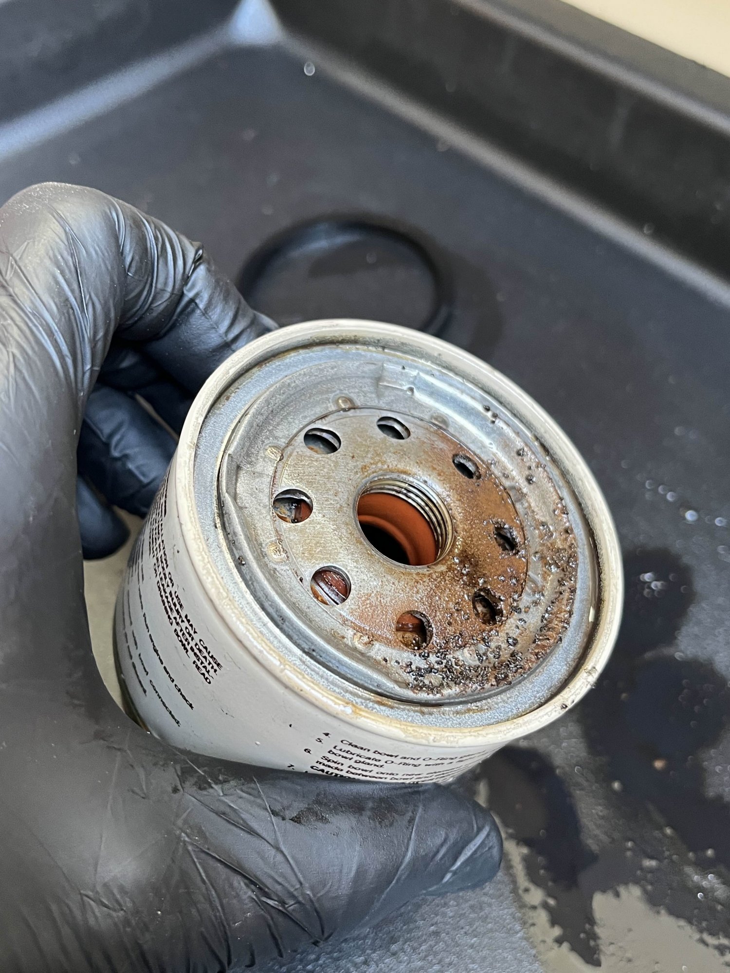

I replaced my filters, added fuel, and cranked the engine. I had to crank for a while, and I had to bleed at the second filter and the injector pump. I am thinking the combination of low fuel, old filter, and a biocide treatment caused the problem.
Notes:
The dirty side of the first filter (raycor) had bio-gunk. A particularly large slab of it in the lower water bowl.
The clean side of the first filter looked clean.
I borescoped the tank. Poor lighting and limited access. I could see some (edited) diesel with black floaters. The walls looks very clean though.
I removed the hose from the pump to the second filter and ran the pump. The fluid looked clean and flow rate looked good, but I don't have a measure or feel for it.

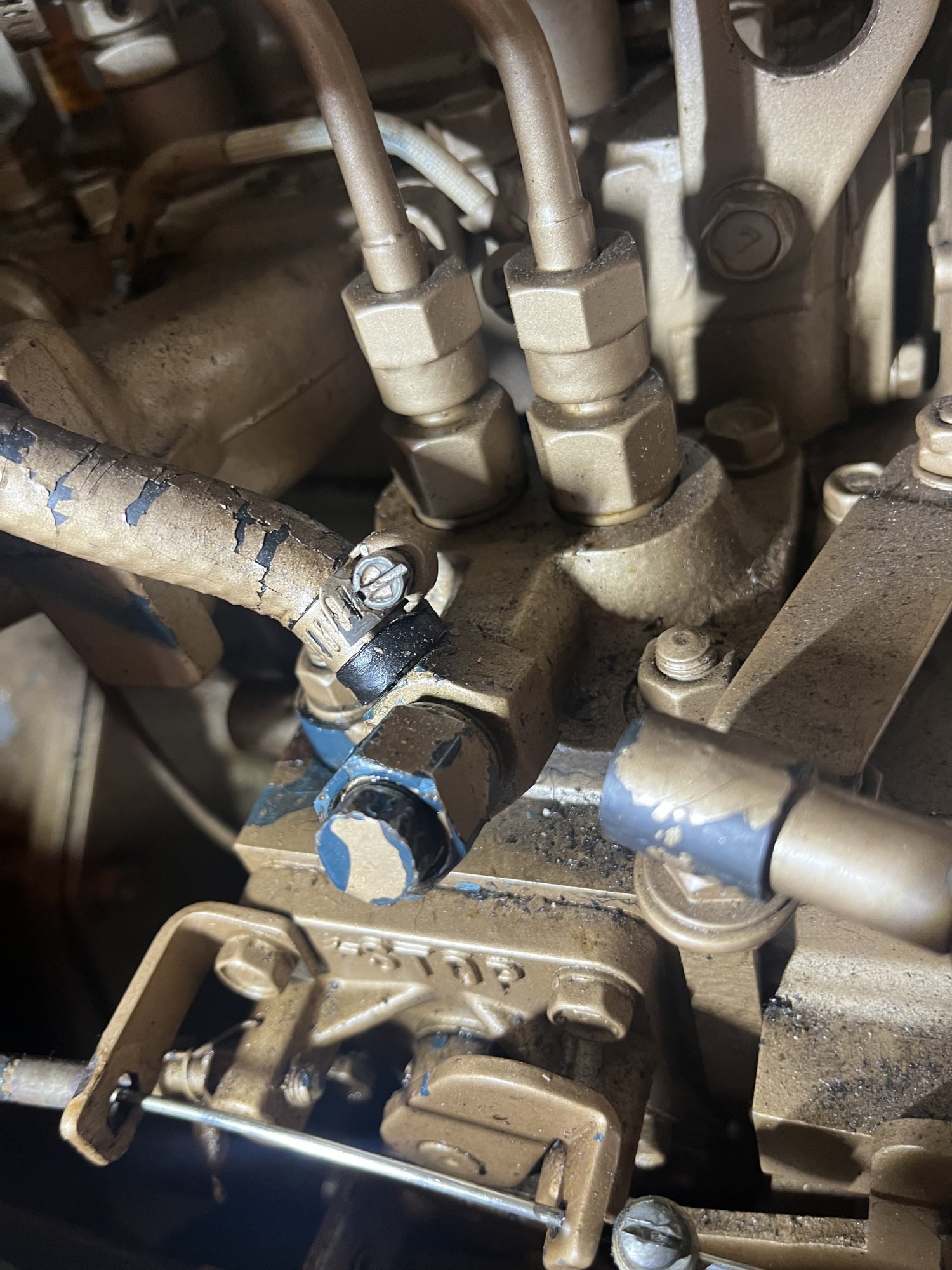

I do have a question about the bleed valves. The pic here shows the injector. The bleed valve does not have any gasket. I was thinking the blue material was sealant, but maybe it is loctite? Should I put some more on?
I’ve not yet met a bleed valve requiring sealer. The bio growth on that filter indicates to me that you should carry a couple of extra filters when you go sailing and always use a biocide in your fuel.
24,696
:plus:
My guess is that the filter clogging may have triggered a bypass of the filter medium. Filters are not a 100% closed system. A good rationale for a two filter design. I use a racor design as my primary and the on engine fuel filter as the secondary (inline filtering). The racor like system catches 98% (an estimate) of the particulate greater than 30microns. The second filter saves most of everything else. So far the system has worked to protect the injectors from damage.
Have you tried ratcheting wrenches? I can't imagine doing engine work without them at this point.
I had to have my coupler overbored because it was impossible to install in the engine bay so this problem was exaggerated on my boat. I have an M-25XP. It had so much vibration that things would occasionally fall off the table in the cabin. The guy I hired discovered that as soon as the set screws on the coupler were loose, the spacing all around was even. The solution was to tighten the bolts holding the coupler to the transmission before tightening the set screws.
Do you feel any play when you move your engine by hand?
That valve simply needs to be turned open a little bit to bleed the engine. You do NOT need to ever crack injectors on a Universal engine. Later M25 series engines replaced that nut with a knurled knob, but the concept is identical.
Bleeding 101 http://c34.org/bbs/index.php/topic,6377.0.html

It appears I would need to pull the tank out, clean it, and install an inspection port to access anything inside the tank. See pics earlier in thread.
