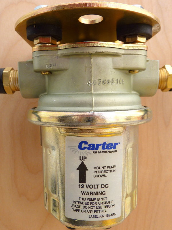

The Carter rotary vane pump below has about 1400 hours of polishing on it. It can move 70+ GPH through our Racor 900 and other than being a little noisy, and drawing more current than the Walbro, it has proven to be very reliable and also inexpensive, got it at NAPA. These were originally designed for the US Military. We have started our motor hundreds of times, with it running, and suffered no issues. Of course I have not been able to measure any spikes on our system even with an o-scope, so this should not be an issue.
I know the Walbro pumps are very often used in these applications, many of the mega yachts use them, so perhaps Roger just bought the wrong one for his application. I know Rich H. also uses a Walbro. A call to the manufacturers tech department may be a good move as they could advise on possible reasons for failure and the best pump to use for the application..
