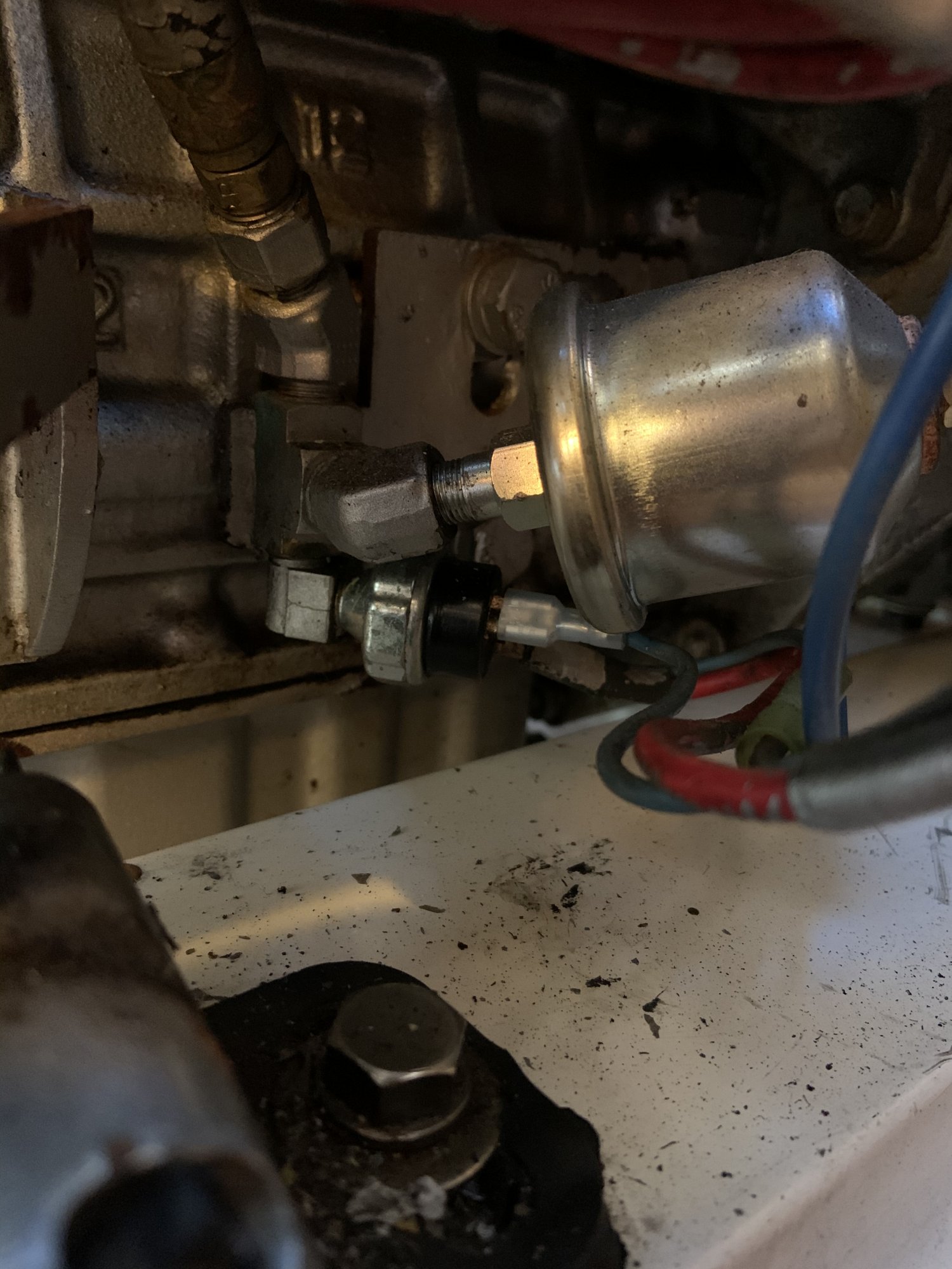

Les, there is an oil pressure manifold on the M25XPB. I installed a pressure sensor on mine and the corresponding gauge in the engine control panel in the cockpit. I thought I had a picture of it, but can only find this page from the parts manual. #15 and 16 are 1/8" NPT fittings. Not easy to get to, but real nice to be able to see the actual pressure.

Here’s a picture of the two oil sensors. The big one is pressure, and the small one is the normal switch.
