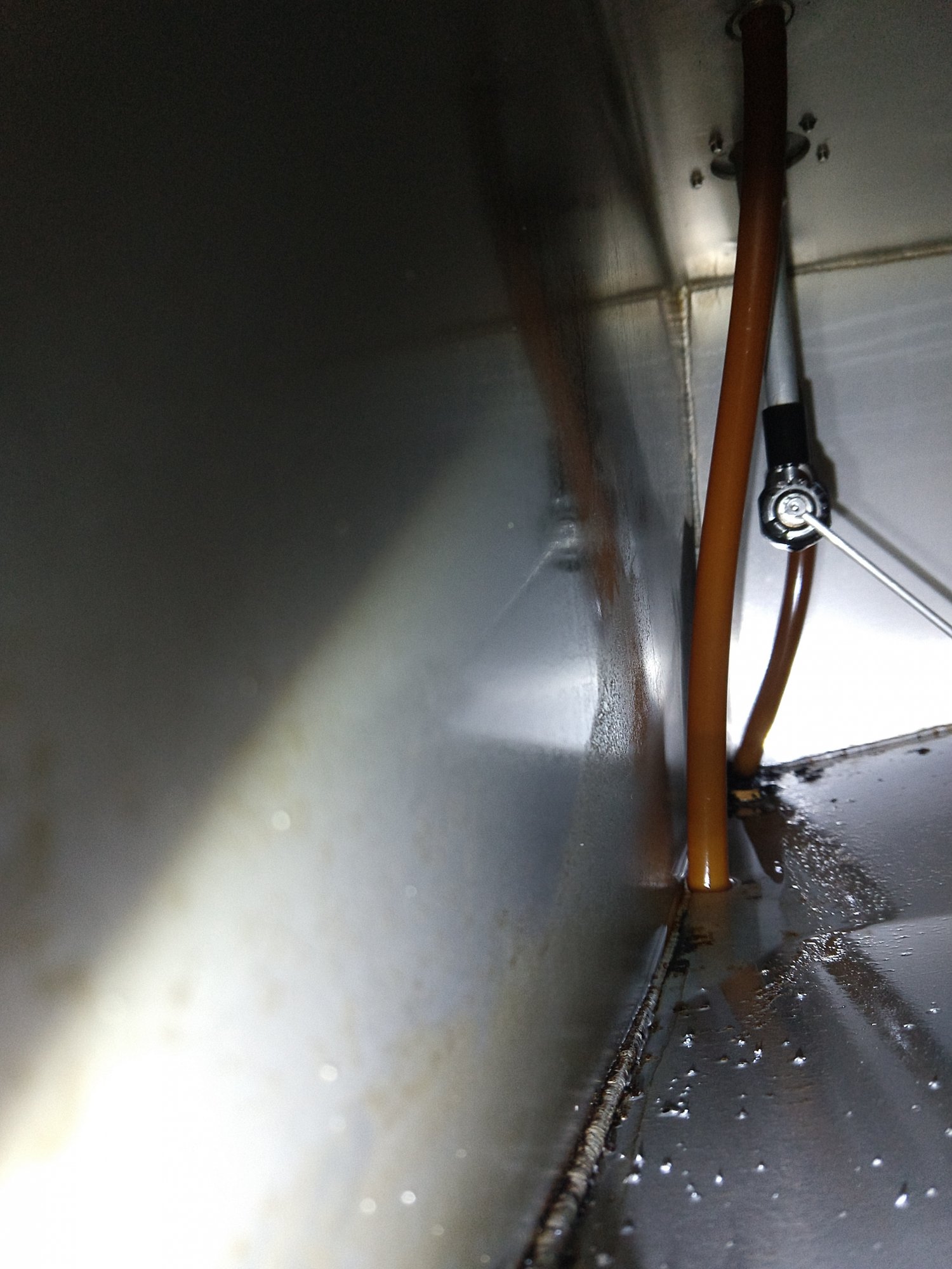

Another potential issue that could cause the problems you are having is related to the pickup tubes in the tank. Last week I finally gave up on the little fixes and cut a hole in my fuel tank. The tank was surprisingly clean but I did find the source of my problems. Not only did Catalina install the pickup tubes all the way to the lowest part of the tank, they actually cut them too long so they were pushing against the bottom of the tank. The tank measures 11.5 inches deep where the pickups are located. The pickup tubes were cut to 13 inches long. So the small amount of sludge on the bottom and any water was always being picked up into the line. In addition they had cut the tube so there was only a small opening so it could easily get clogged by the sludge in the tank. Replacing these tubes only costs about $25 each and if you cut them so they are 1 inch off the bottom of the tank you will not have as much issues with fuel. This will cost you less than 1 gallon of the tanks capacity, I did the math. I will hopefully get to a full write up on the tank issue this week.

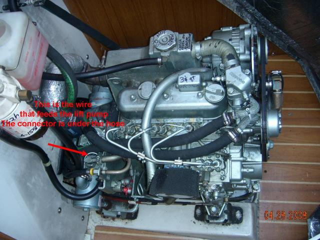

Check for corrosion on the shovel connector that feeds the current to the fuel pump. It is the wire right on top of the pump.
An indication of high resistant to the power feeding the pump (possible caused by corroded connections) is that your buzzer will not sound if you turn your key in the on position (not the spring loaded position). This a little known diagnostic feature letting you know there is a problem. The ground for the buzzer circuit is through the induction coil of the fuel pump. The fuel pump will not run until you have oil pressure, or if you turn the key to the spring loaded position. Once the engine has oil pressure then +12v will be applied to the pump through the oil pressure sensor. This also has the effect of turning off the buzzer as now it has no ground.

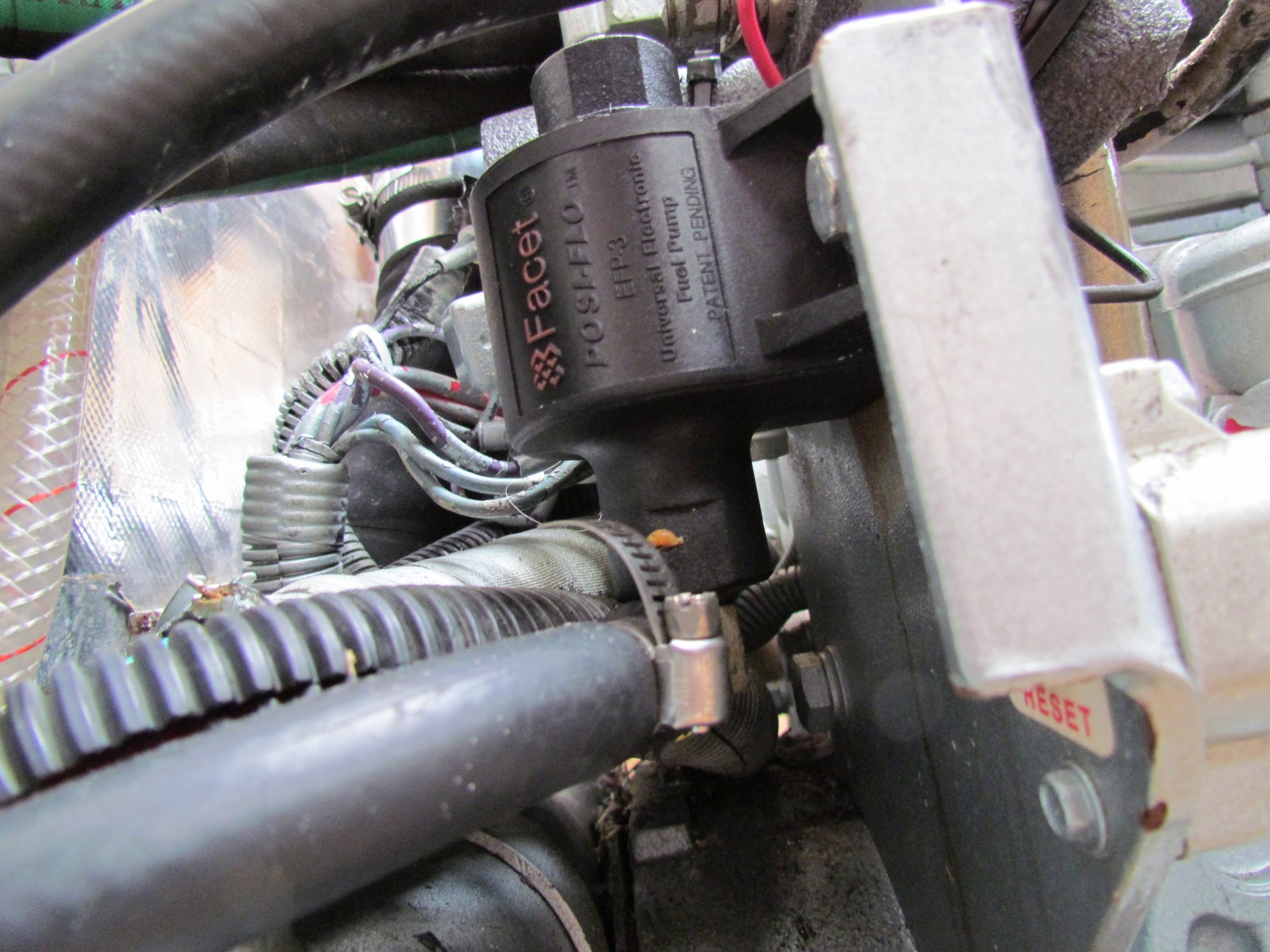

Just curious if anyone has the Facet part number for the lift pump? I've got the Westerbeke #, 039275, I think. Ours was replaced by the PO so I don't know how long it's been working, or if that was the first replacement, but having a spare on hand seems wise.
Hope this helps.

this is the one i have used over 15 years replaced twice.
Thanks. Ordered one to have as a spare.
