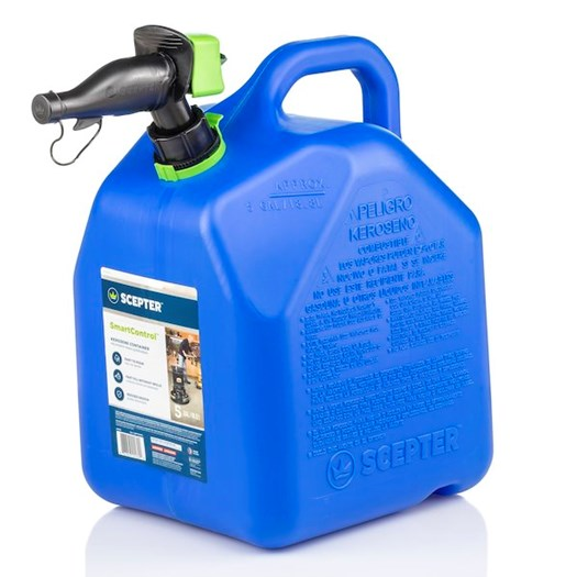

I'm starting to lean towards a separate tank. I had a half pint of diesel handy and used that to run it on the bench. Went through it pretty fast. Granted, the shop was cold and I wanted to see what full output was iike (very satisfying). But I only have 17 gal of fuel storage to begin with. I don't motor that much but a separate tank would act as extra fuel storage and allow the occasional fill up with kerosene. It would also keep the fuel pump in the lazarette.
Something like this container, well-secured. Make it removable so I'm not sticking the fuel hose down in the lazarette to refill it.
I'd install the fuel tank tap in place of the pour spout.

Thanks for the maths! I think the numbers support a separate 5 gal fuel jug. I could see drawing the main tank down very easily. We do like to sail in the winter occasionally. The weather is mild compared to Idaho and it's uncrowded and peaceful in most anchorages. And there's wind. Sometimes too much!

You are over thinking this. Why not go with your original plan? Your Plan “B” seems like a lot of unnecessary extra work and potential trouble. Not only will the container have to be well secured, which in itself is not trivial, it will need a venting system preferably to the outside so air replaces the diesel as it is used. Install the pickup tube in the inspection hole, buy the spare container, fill it with diesel, store it wherever (anchor locker, lazarette, lashed down on your life lines, etc), and when you get low in your main tank, whether it is due to engine use or heater use, top it with the spare container.
23,799
I would agree with Len. A whole lot easier to refill the fuel tank with a jerry can than to refill the portable in the boat.
I like the KISS plan.
