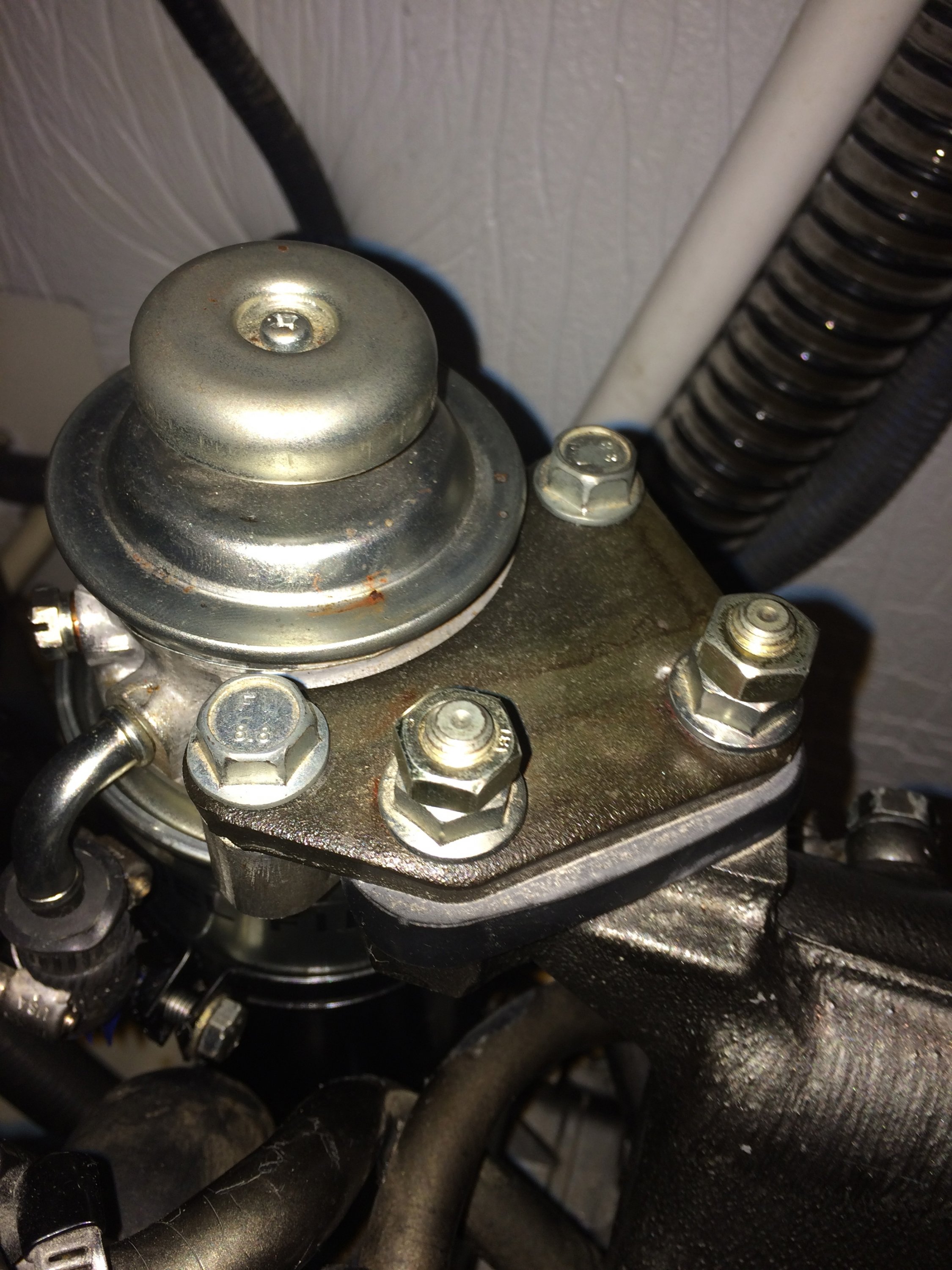

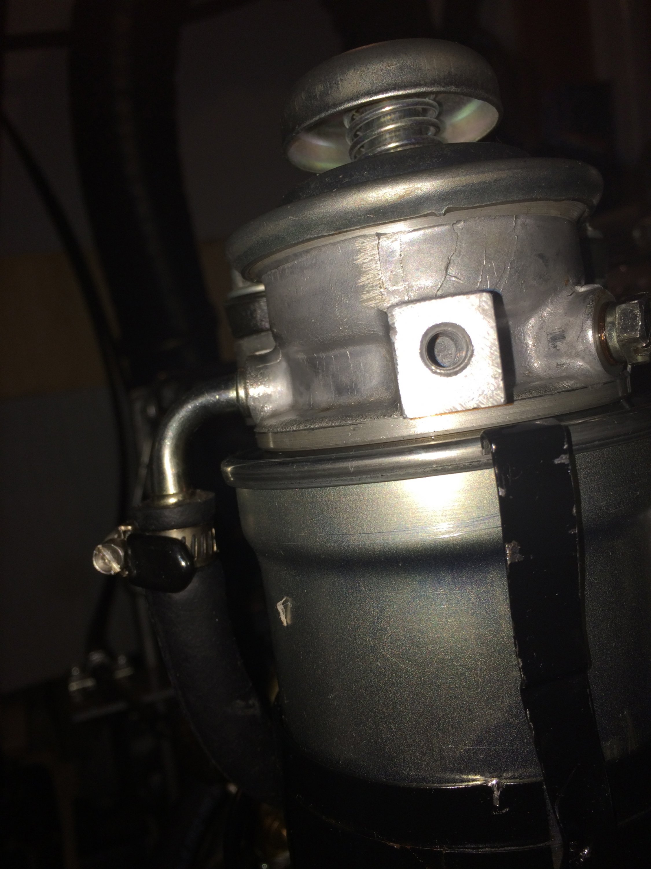

Please help! I have a hunter 45CC with a Yanmar 4JH4TX2 engine. The fuel filter on the engine has a cover which I cannot remove - the manual is not specific about that.

I have the same boat, 2006 Hunter 45 CC, and the same Yanmar Engine, 4JH4TX2, I believe that the bottom portion of the filter spins off and inside is the fuel filter element, that you replace The top portion of the filter housing is the manual fuel pump for priming, (filling) the filter prior to starting the engine.

Now that I think about it, the bottom portion of this filter assembly screws off, like a typical filter cartridge would. The replacement fuel filter element just screws back on, typical to changing the engine oil filter. The "button" on the top of the assembly is used to manually pump fuel into the new filter/cartridge prior to starting the engine.
