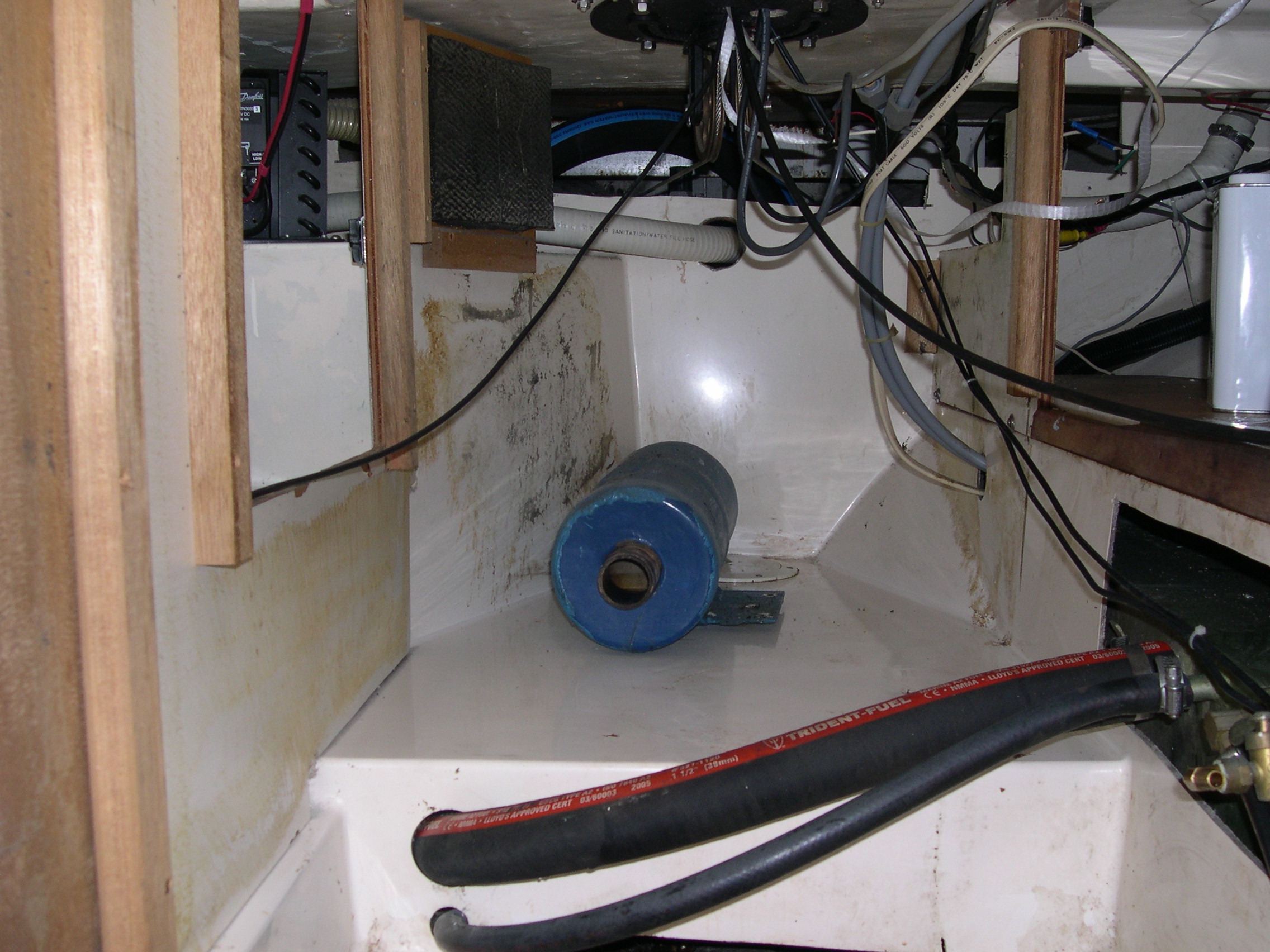

Mine is a 1983. Here's a picture of the fuel hose and vent, minus the engine.
I hope that the designers had a good reason for doing it this way? Or is this a problem on all 37's ?
