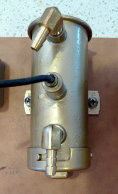

It probably is the exhaust fan that is turning on. Verified I have fuel coming out of the Racor. Do not have fuel coming out of the lift pump. Shorted the power lead of the lift pump to 12V and got nothing. No noise, no activity. Ordered a new lift pump and oil pressure switch. Let's see if that solves my problem. Thanks for all the advice
Maybe verify that the lift pump has a good ground. I recently found several corroded connections on the glow plug solenoid, next to the lift pump. When you go to position 1 on the key switch, do the warning lights come on and does the alarm start beeping?

Sorry about the late responses, was out of the country and just got back. I don't think I have a return fuel shut off valve. Will look to verify. I know there is a shut off return valve on the gas tank. No alarm sounds when going to position 1 on the key switch. New fuel lift pump and oil pressure sending unit were delivered while I was gone. Will look at installing them this weekend. Hopefully the new oil pressure sender will solve the lack of alarm sound.

If you don't have the wiring diagram for the 12v circuits, you can go to the s/vSmitty site and download the owner's manual. The circuit for the alarm is unusual in that positive 12v is fed to the lift pump to energize it, and the same 12v silences the alarm.
