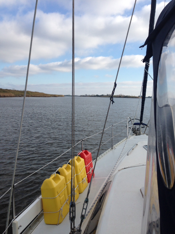

We are getting ready to do our first "extended" trip out into the Gulf and I would like to carry a few fuel cans and extra water on deck just in case.
What is the best method of securing these containers on deck? I have seen boats with wood attached to the safety line stanchions and the cans attached to that. Is there any better way? I would appreciate some suggestions. Thanks

I did not want to use wood myself. So I used plastic fence boards that I found on Home Depot's web site! They work well! And no painting or staining! I have one photo handy that shows them so I will add it here. If you would like more let me know!

Good idea T! Had not thought of that. Is it strong enough to hold them without flexing?

Dean,
This is the most esthetic installation I have seen. It appears that you have used one U-bolt on the stanchion and countersunk the plate. Did you find one this sufficient? Also, did you pad the stanchion where the U-bolt was attached? More photos would be great as well. Thanks.

I used a 1x3 and used stainless u bolts one per stanchion. I routed 1-1/2" linear slots for 1-1/2" nylon straps that went over the top and around the jerry can and also around the middle. I used the plastic 1-1/2 " connectors to strap them together. I put stainless acorn nuts over the exposed threads of the u bolts. Worked out great for 5 jerry cans and 25 extra gallons of diesel. I use a shaker type siphon and it will transfer 5 gallons in 1 minute and 40'seconds.

Bob I will try and post more photos when we get back to the boat! This has been working well for over a year. And we have been in some rough seas with waves hitting them and no problems!
