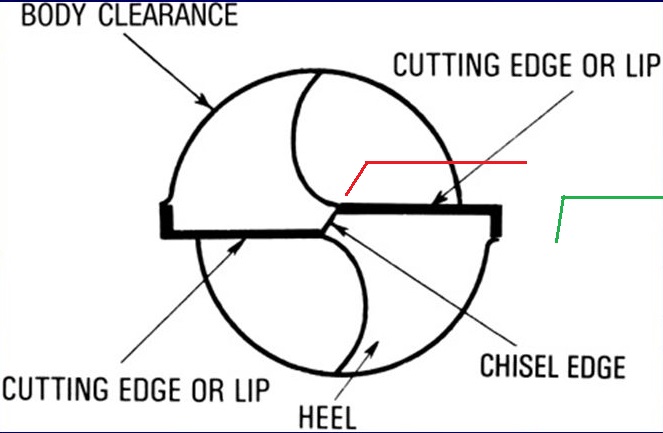

Aug 22, 2017
1,609
Hunter 26.5 West Palm Beach
That's interesting. I've never tried a dubbed tip. I always reground the front surface of the point until the angle between the cutting edge & the chisel came out to what I wanted. The real way to do it is on a proper radial pointing fixture, but I've had pretty good luck with just taking a drill bit to bench grinder & doing it by eye. I don't have pointing fixtures for bits larger than 3/4", so I've always repointed all my larger bits by eye.
The picture below shows how to read a drill point. The red lines shows the current angle of the cutting edge to the chisel. This is a general purpose cutting angle. The green lines show what I would want it to be for drilling copper. Basically, you add 90 to the clearance angle that you want & that is what you look for when viewing the point from the front. a 90⁰ angle would indicate zero clearance behind the point. Anything less than 90 would indicate negative clearance & that would not cut at all. Split point bits cut the chisel in half & don't let you see the clearance angle from a front view.
