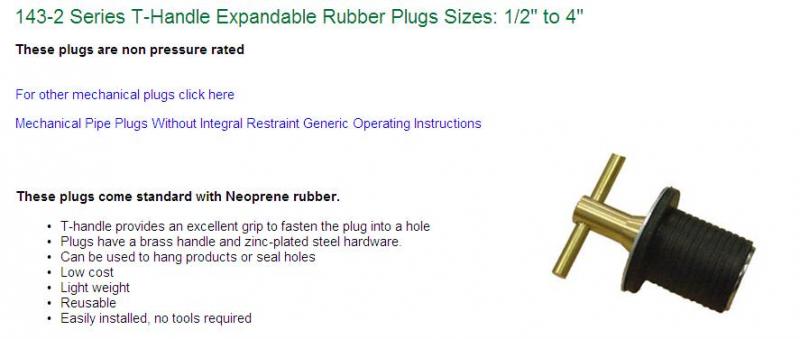

With your being in Fl., there's a CHANCE it can be done without without hauling the boat. You have to decide how much risk you're wiling to take.
Get yourself an expandable plug and dive under the boat and insert it in the thru hull. That SHOULD keep any water from getting in.
Make sure you have a suitable wooden plug inside in case thing go wrong.
Next steps are crucial. Grip the thru hull and then grip the seacock where the thru hull enters it. This wil reduce any bending forces. Try to unscrew the seacock. Apply a reasonable amout of force but if it doesn't come easily, STOP and call it quits. Haul it and do it on the hard.
Remember, this is me several thousand miles away in my armchair telling you what to do. Your boat, your decision.
