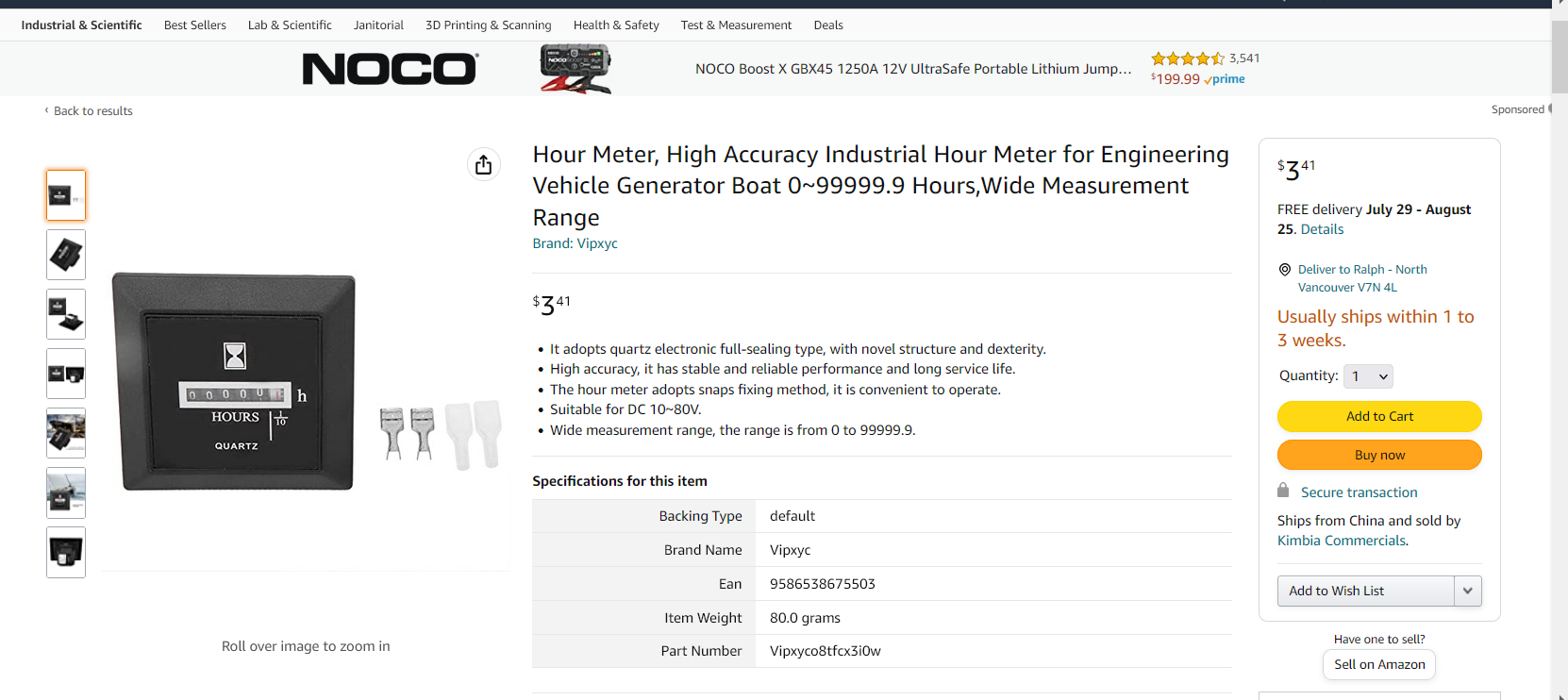

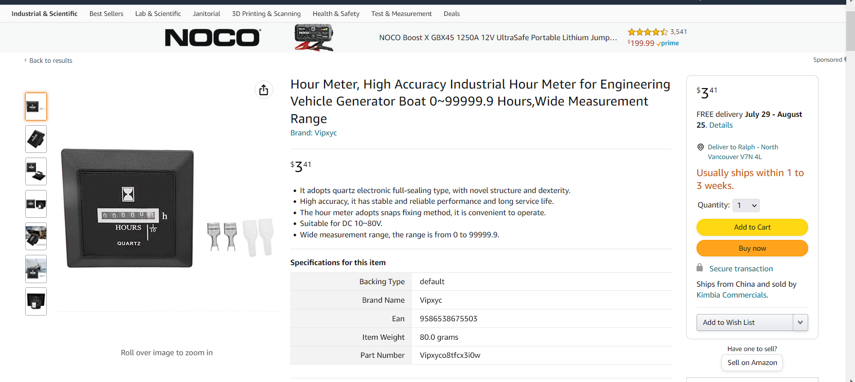

This gets cheaper all the time.
You can now measure you refrigerator's TIME ON during the day for only $3.41 CAN.
At that low price, better get several because the meter isn't going to last for very long :cuss: !
Nor will it give you accurate information. I had reason to test a similar product. It was around 20% fast.
