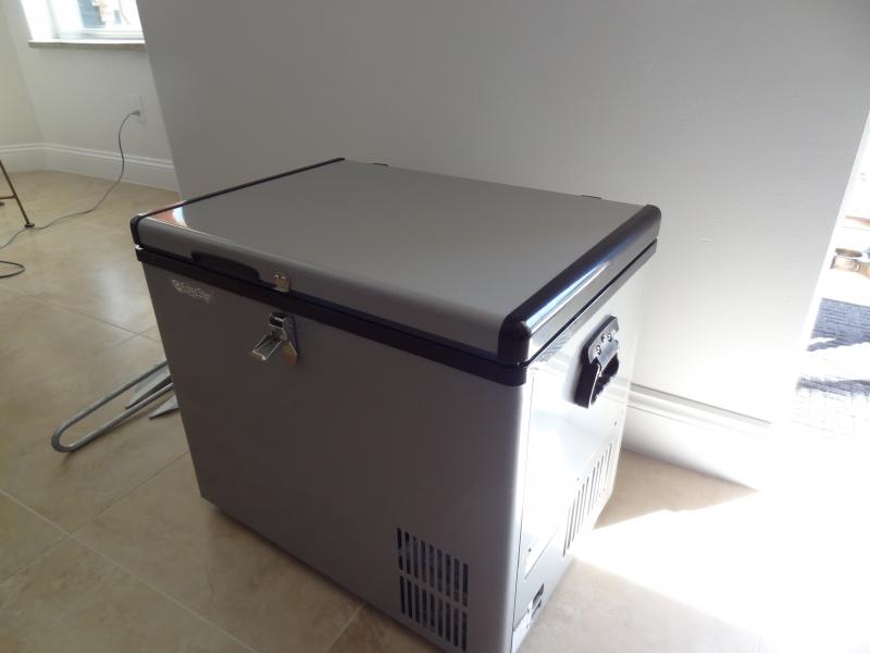

I also bought an EdgeStar 43 Quart Portable Fridge/Freezer ($479). It's small 43 quarts box but a real fridge/freezer. It comes with all cables.
Keep your foods and drinks chilled or frozen. Runs on 110V AC or 12 and 24 V DC.

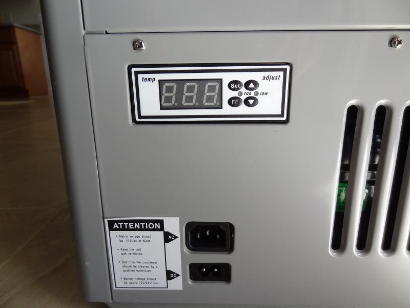

Has a full range digital thermostat, adjustable from -8 to 50 degrees F will hold a stable temperature under most conditions. The usage is 65 Watt when running or in Amps 5.4A @ 12V DC / 2.7A @ 24 DC.
It has a nice digital display outside showing the inside temperature and allows from there to adjust the temperature. But it cannot freeze or refrigerate to the same time.
I bought it recently, have no experiences at the time. The rating was 4.5/5. I think it will work for me in Florida. My electrical cooler was not working well. First I do not believe it cooled realy 40 F under room temperature. But even if it wood, by 95 F in galley the food wood be in 55 F.
Energy Balance:
I have two 12V batteries, group 24 and 27, 80 and 90 Ah =170Ah. When assuming the fridge runs about half of the time that would be 5.4A x 12h = 64.8Ah the day. Full batteries would last about 170Ah/64.8Ah=2.6 days.
To make it work over 5 days it needs some additional energy. Total need 5x64.8Ah=324Ah. Additional need at least (324-170)Ah=154Ah.
Assumed solar elements deliver 10h the day, 50h in 5 days. They had to add at daytime constantly 154Ah/50h=3.08A or real 12Vx3.08A=36.96Watt
I do not have solar elements on my boat yet. My outboarder delivers 12A and with that and hopping on longer trips all three days in a hookup marina I hope it will do it.
