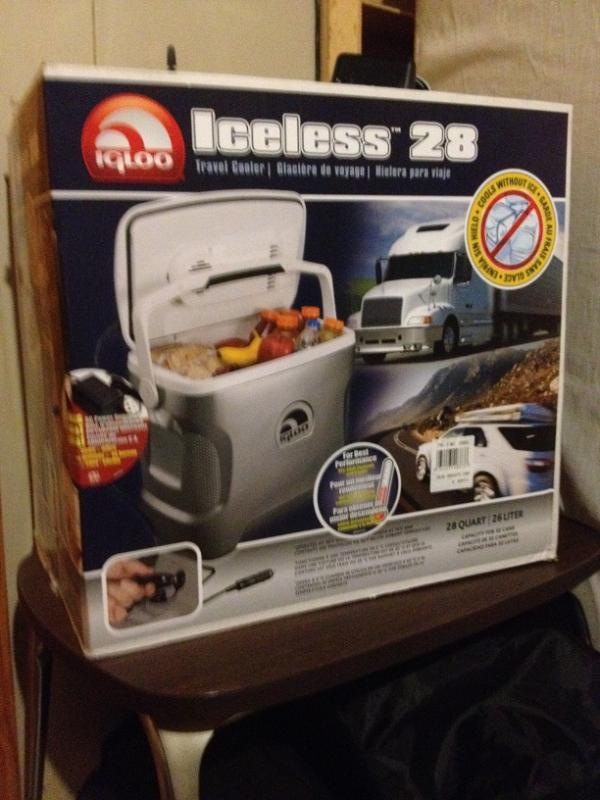

I do have experience with an Igloo Iceless 28 Qt. Power cooler. It runs on 110V and 12v. To make it work, I put a frozen Ice Pack in and pre cool the unit overnight using the unit on 110v at home. Before leaving the house, I pack my frozen foods on the bottom and my cold stuff on top. While on the 45 min trip to the marina, I plug the cooler into my car power. Once on the boat I plug the cooler into the 12 v system and go sailing. My 100w solar panel recharges my two batteries. In addition to my cooler I run the stereo, the vhf, the laptop and the autopilot as well as the depth sounder and have no issues with loss of battery power. By nightfall, I have LED lights on in the cabin, perhaps the stereo and the cooler. My batteries cover the needed output with plenty to spare.
My food product has remained frozen for three days, even with me going in to the cooler once in a while. It certainly does struggle when the ambient temperature is very high. It fits well on my 25.5 and for $90 at Costco, it is a low cost solution.

DC coolers such as the above mentioned Igloo draw current constantly with no thermostat control. Bear in mind that it draws far more current than my real reefer and only a fraction of the size with no freezer. These units of this size still draw 3 amps per hr compared to my isotherm only drawing .7 amps per hr. I own one of these as well and use it in my truck while traveling plus I plug it directly into a 75 watt solar panel and that works great! I keep my beer cold while RVing in Arizona each winter with one of these coolers and my old 75w solar panel. These are poor units for multiple day use on a boat. Chief
