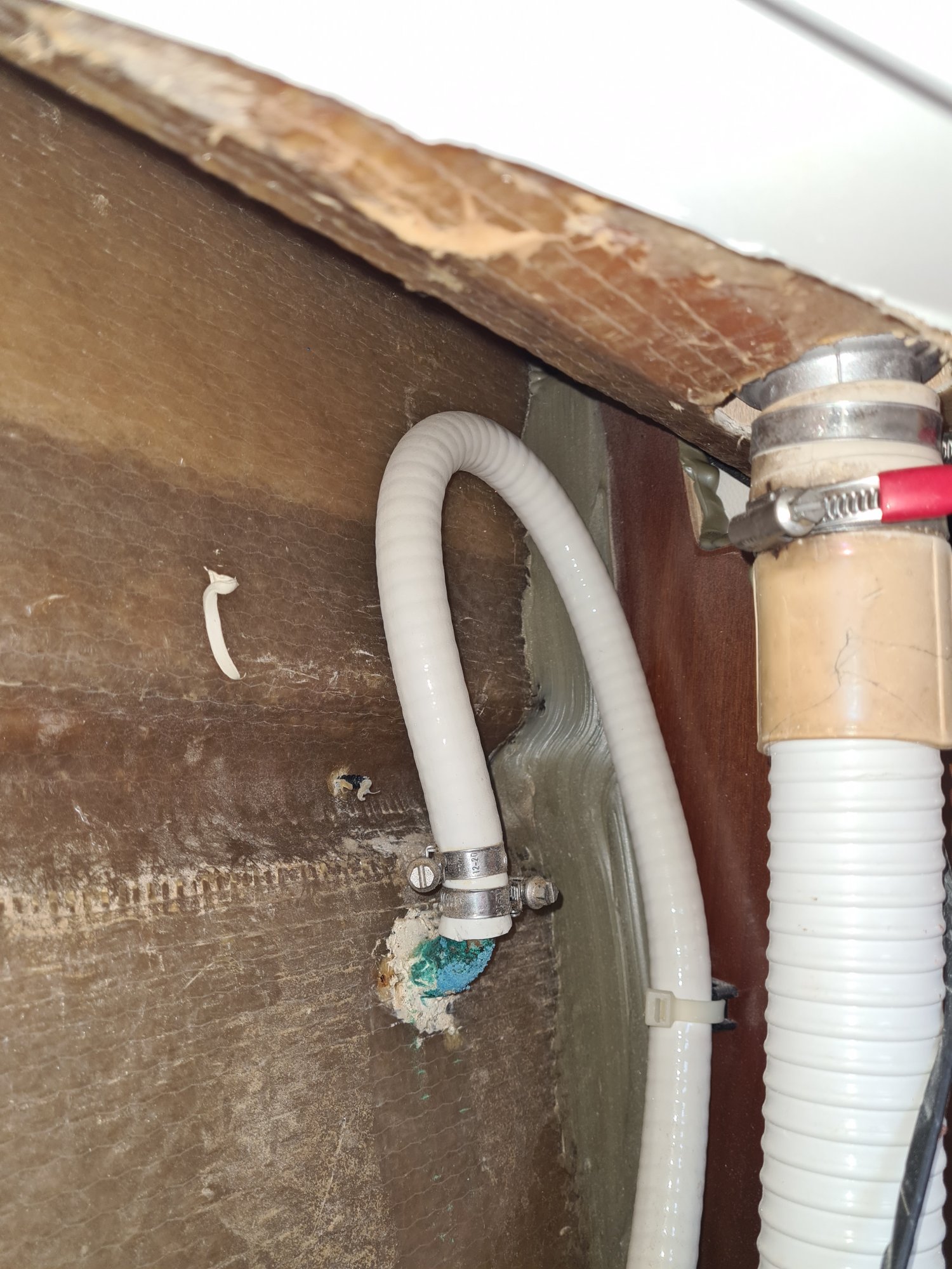

I have just purchased a Beneteau 42, I think the forwardmost water tank vents through the hull via a vented loop, my concern with this is sea water entering the vent and contaminating the freshwater tank, is this method normal or am I too cautious?
The small white hose is not a Vented Loop.
But it is a loop to prevent sea water back flow on a "heel" while sailing.
The sea water can be Forced into your tank.
It will depend on the connection on the thru hull.
Read above[ post #3] for one type of connection to hull.

I have just purchased a Beneteau 42, I think the forwardmost water tank vents through the hull via a vented loop, my concern with this is sea water entering the vent and contaminating the freshwater tank, is this method normal or am I too cautious? View attachment 215260
I am concerned about the corrosion on that fitting penetrating the hull.
