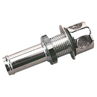

Two possibilities come to mind. Are there any fittings that could be vent openings on the outside of boat. Might look like this.
Some are vented inside of a stanchion. I traced mine from the water tank through the boat. Found the loop and opening.

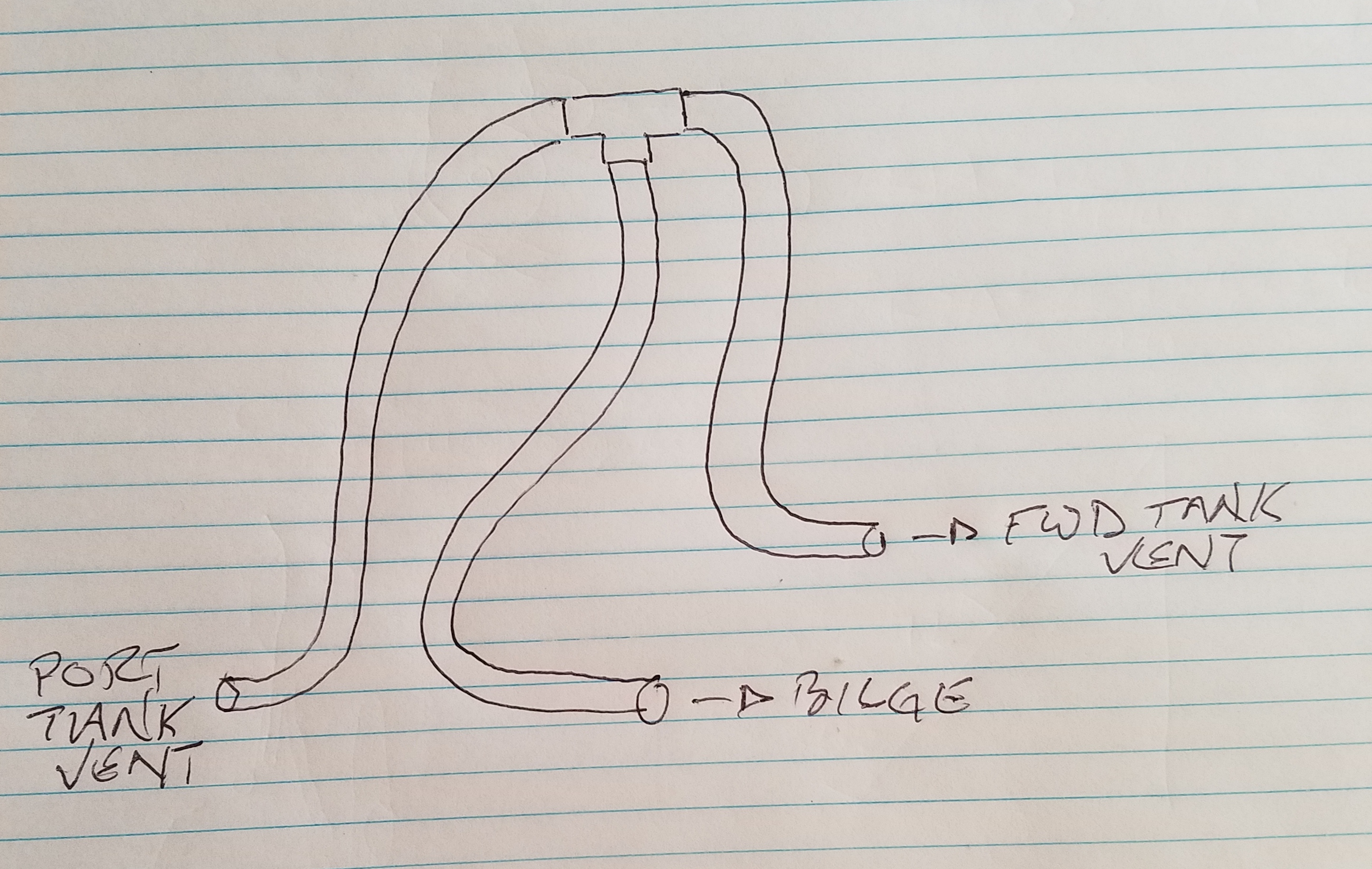

OK, solved it. There's a loop with a "T" at the top, to which are connected the forward and port water tank vents, and a line running to the bilge. The loop is behind the cedar lining of the port hanging locker. It had fallen down, kinking the port vent hose, completely blocking it.
I re-did the hoses, and pulled the "T" up with a string, which is fixed there to hold it, and also lower it if ever need be.

What's with the vented loop ?
Can't figure that one out no matter which way I rotate the drawing. It passes air, not water but it only passes water as an overflow.

There's no need for a vented loop in any vent line, only an arch in water and fuel tank vent lines to protect them from sea water contamination. NO tank--water, fuel or waste--should be allowed to overflow into the bilge.
It's not a vented loop, just a loop.

The "T" is high up, behind the cedar lining
Clever way to make sure overfilling of your tanks go to the Bilge and not the cabin.
The air drawn into the tanks when using water, will be essentially cabin air, if your Bilge is clean.
