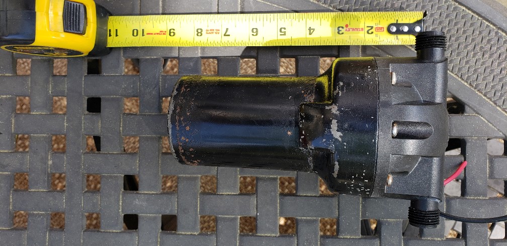

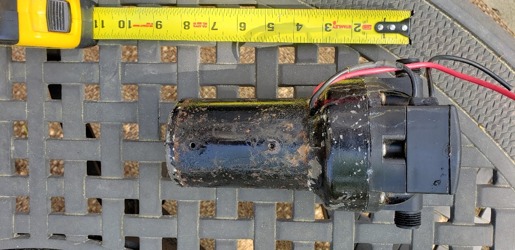

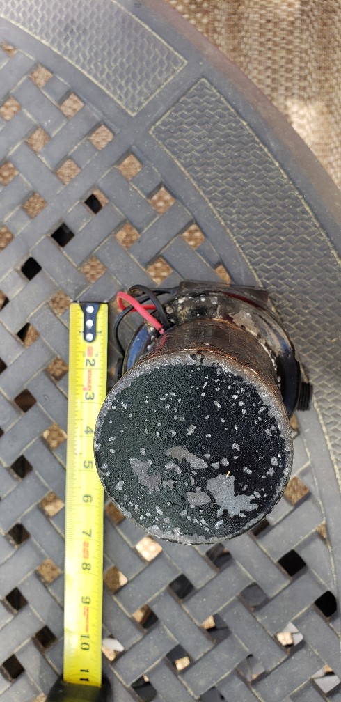

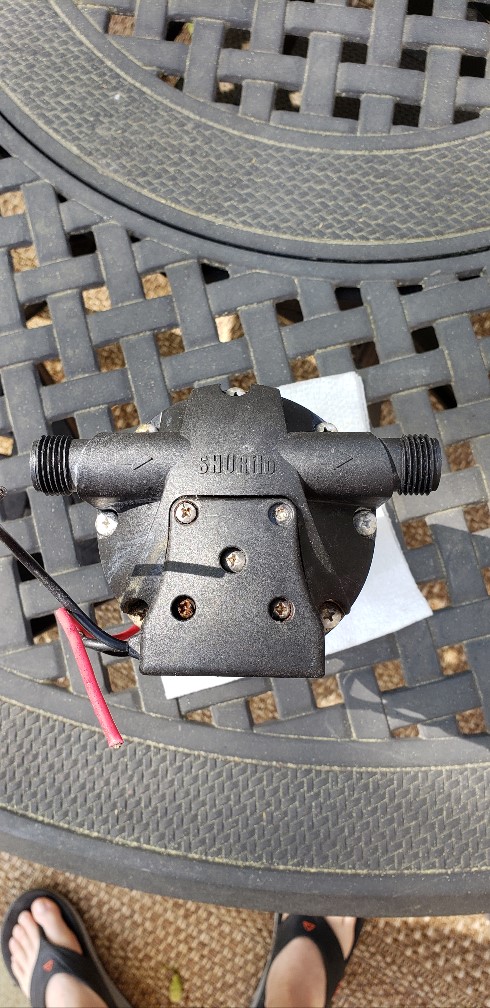

I've got a 2008 Hunter 45 DS. The primary fresh water pump went out. It is a surflow but has no information anywhere on the pump for me to get the same spec pump. Pentair makes the pump and they don't know what it is either. I sent them pictures to review, but they aren't sure what it is. Manual doesn't list anything. Anyone have any ideas. Pictures also attached here.
