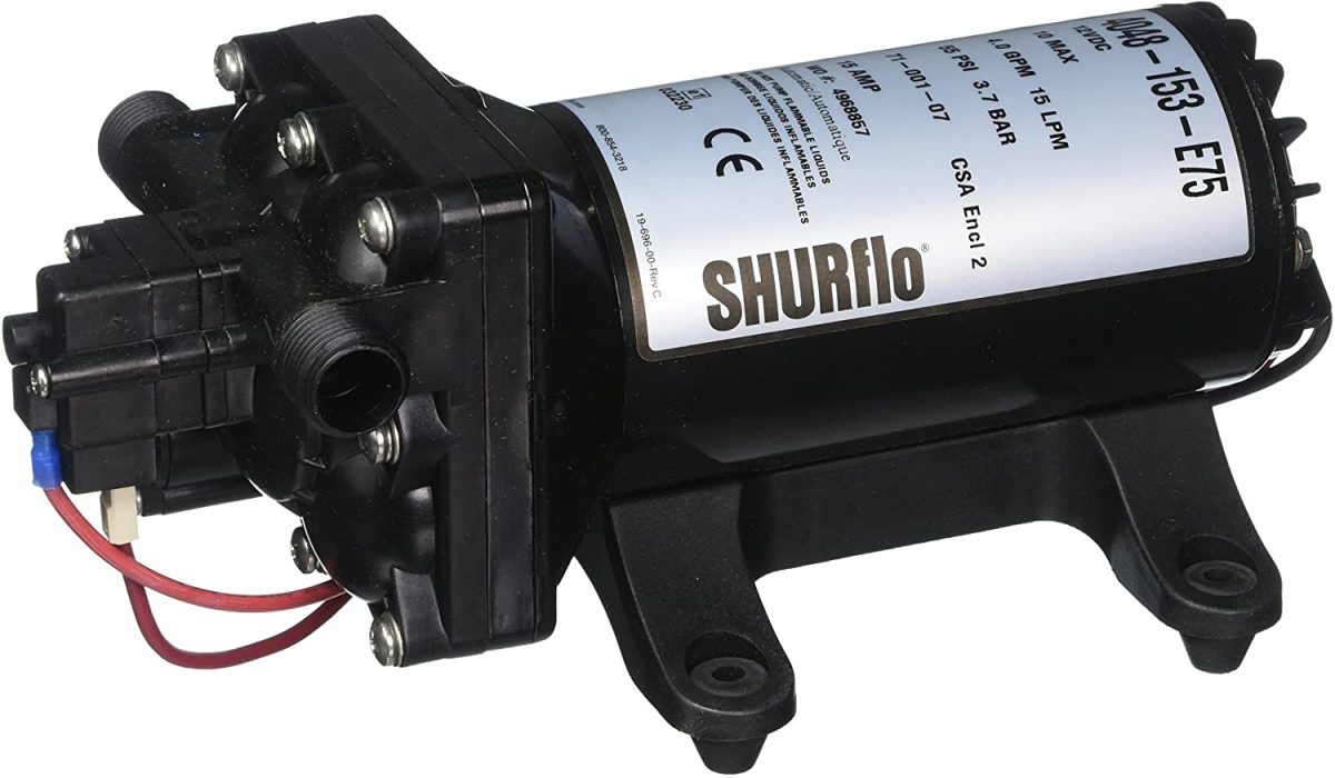

My pressurized system is a simple pump model in my Cal, such as this one.
In 74, they used polyvinyl lines to carry water about the boat, not copper. I installed a commonly found accumulator to better manage the pressure and reduce pump operating time. This has been moderately successful. The pump runs less if we don't open the sink valve wide open.
The boat came with an installed Seaward 11 gallon water heater that appeared to be a budget brand unit. Marginal insulation. Galvanized tanks. Rusting stainless sheet metal covering. I removed it the first year in use and replaced with a 6 gallon well insulated water heater with a fast recovery element and utilizes heating form the engine.
It is not intended to take long hot showers all night.
