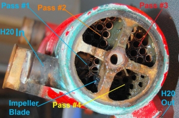

From Main sail’s site...
How A HX Works
If you follow the arrows you can see that the HX is broken into quarters and is a four pass heat exchanger.
Raw water enters & then flows to the opposite end, returns to the inlet end, turns and heads back to the opposite end and finally turns back towards the inlet end and finally gets ejected into the wet exhaust system.
If you click on the picture to blow it up you’ll notice a chunk of an impeller blade that took up residence in this heat exchanger.
https://marinehowto.com/westerbeke-universal-marine-heat-exchanger-cleaning/
