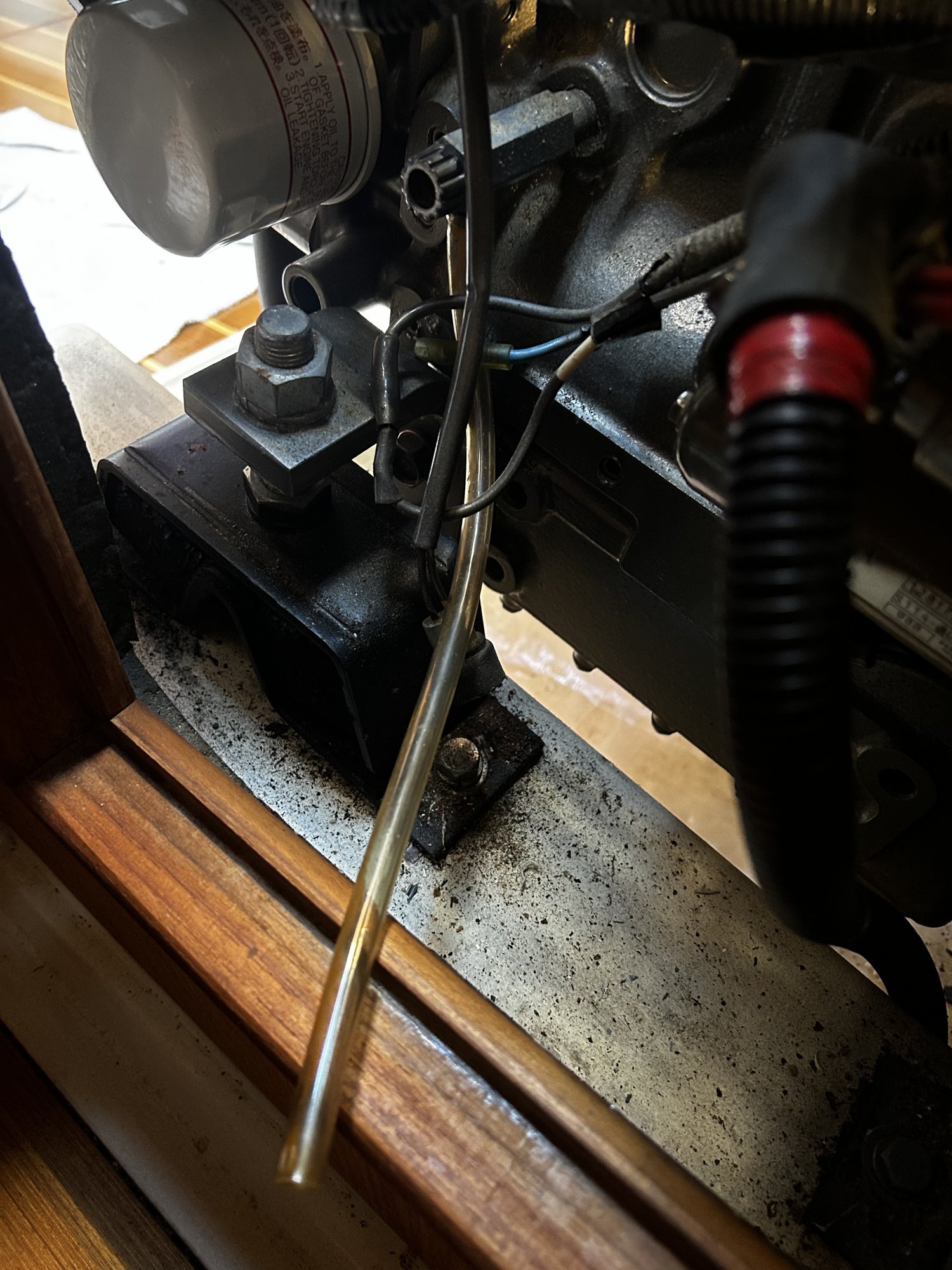

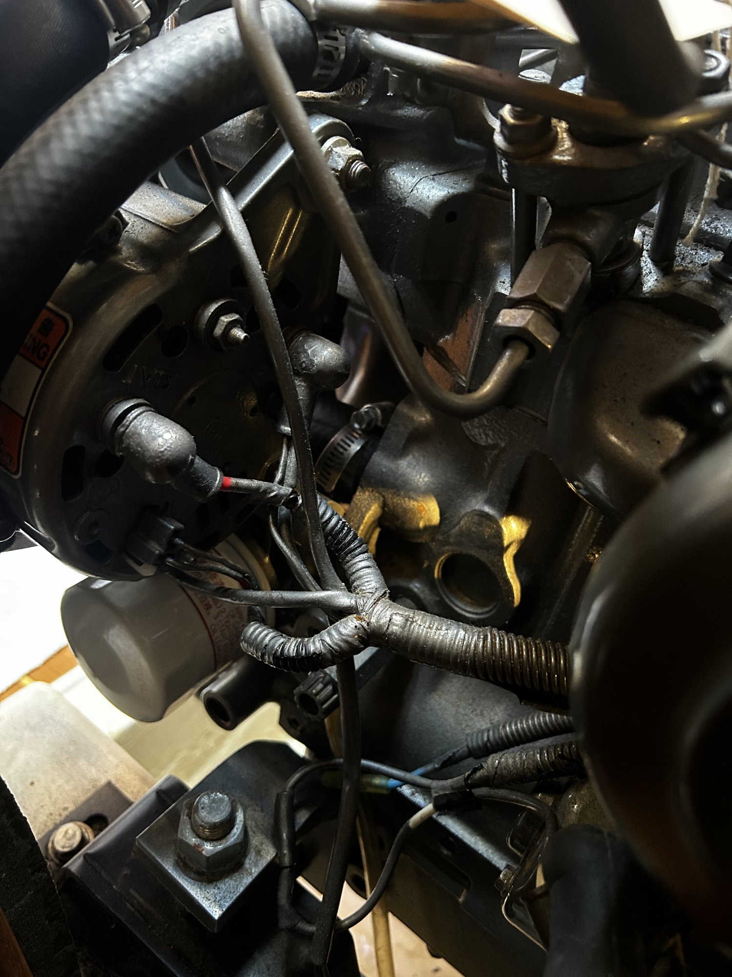

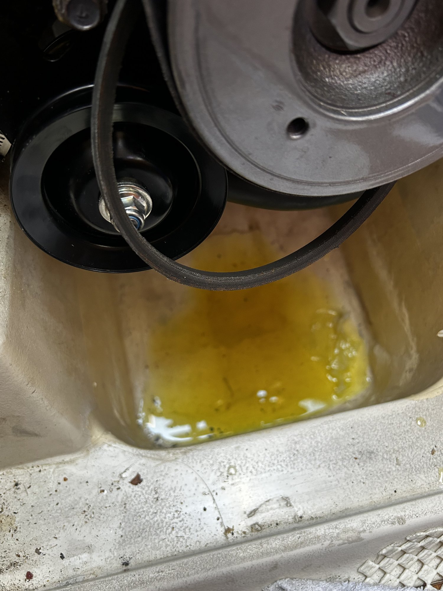

2000 Hunter 340….Today I found some antifreeze under my Yanmar 3GM30F. It cleaned up with some paper towel but I can’t find the source. This same thing happened last spring and was about the same amount. It never happens during the sailing and motoring season.
The only thing I do see is that the overflow container has lost some fluid. It is always just under the Full line, today its is about 1/4” above the Low Line.

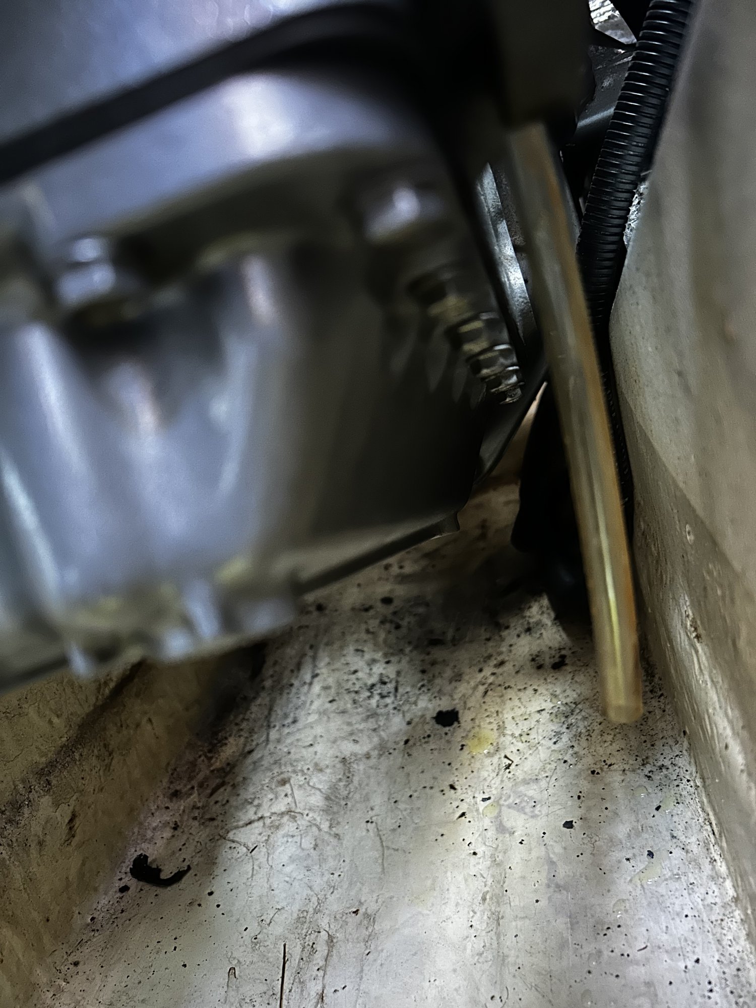

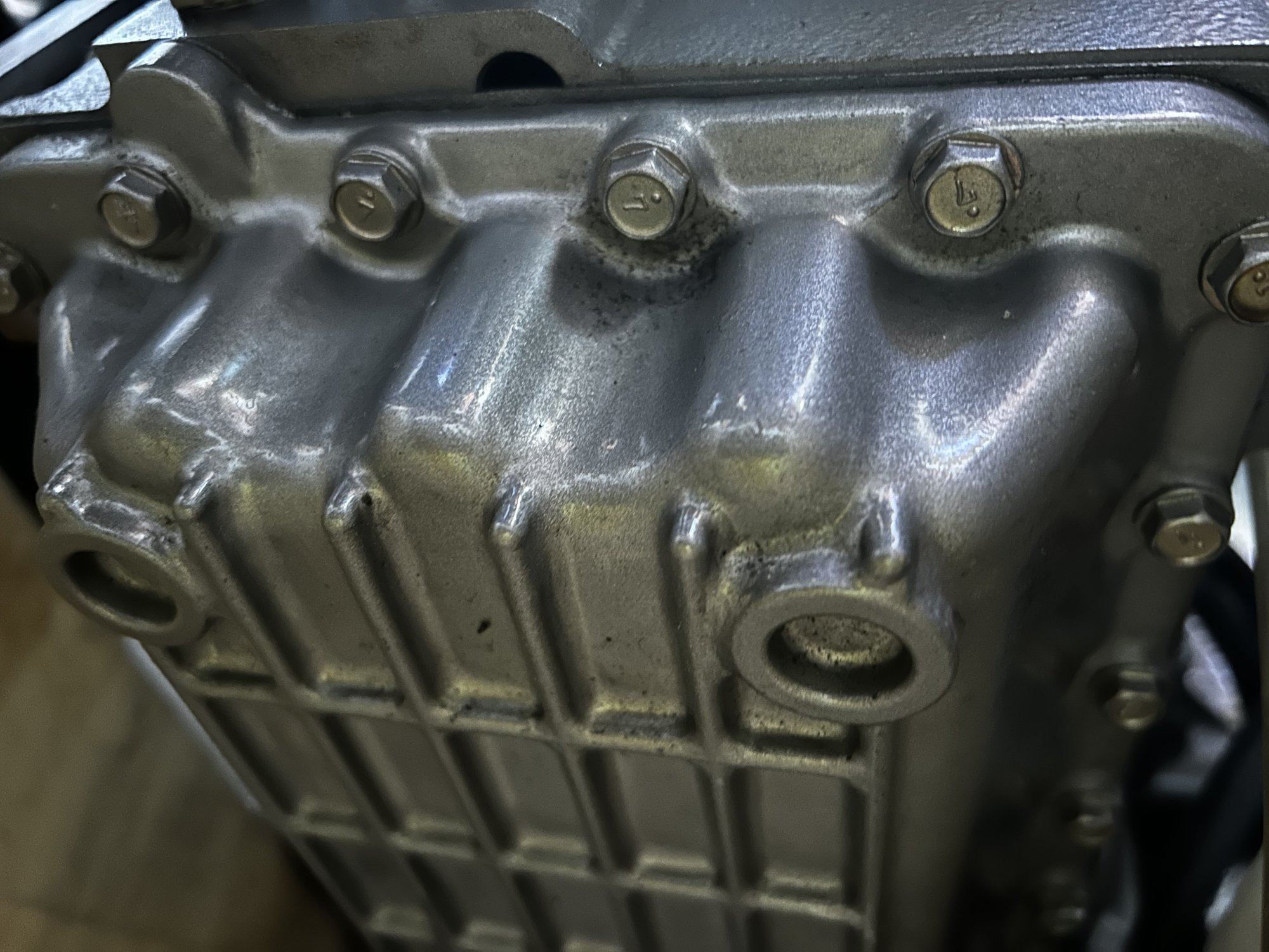

I looked for drips, signs of antifreeze stains all under and around the motor but there are none. The antifreeze level under the radiator cap is full. Checked the petcocks (2) on the sides of the motor and all are dry.
I loosen the fan belts at the end of the sailing season to lessen the tension on the alternator and impeller pump but that has different antifreeze from what I found.
It‘s puzzling to me that it only happens during the winter. This winter was very cold compared to others.
Any thoughts as to a cause. Thank you for the help.

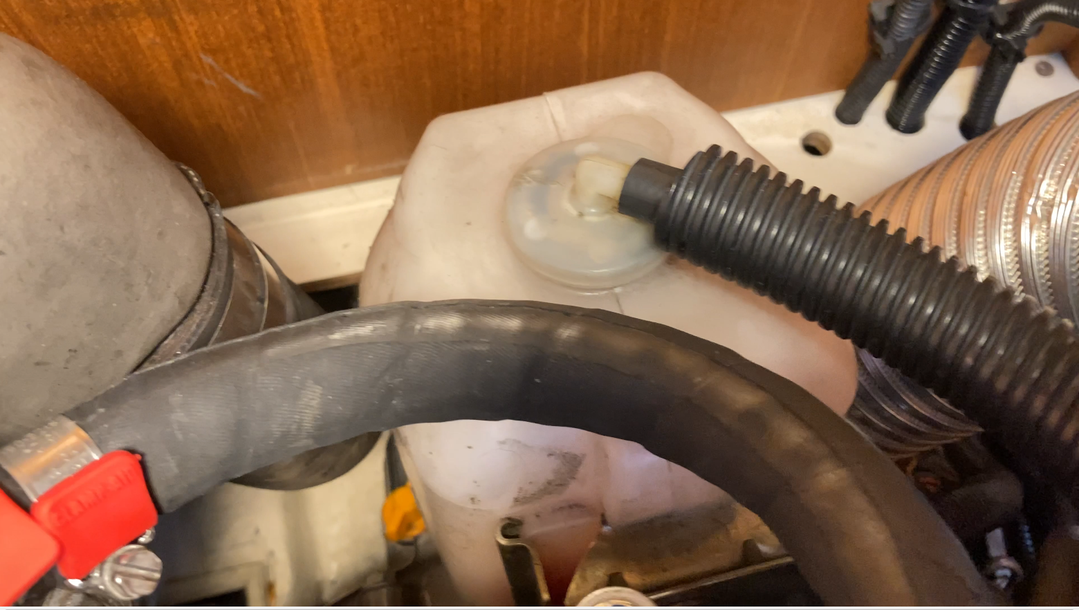

I went nuts trying to locate my "leak" and eventually traced it back to the overflow tank where the cap sealed poorly atand allowed the leak. I guess the bottle has to vent "somewhere."
Tape paper towel tightly around the neck of the bottle and check for wetness during the winter, which hopefully is gone for now.
The leakage is caused by the engine doing the shimmy while running at idle speed when coming into the slip. I finally solved the problem by stuffing a loosley wound scouring pad into the bottle to absorb the little shock waves of AF from hitting the cap.
That was over 20 years ago and the pad is as solid as the day I stuffed it in there.

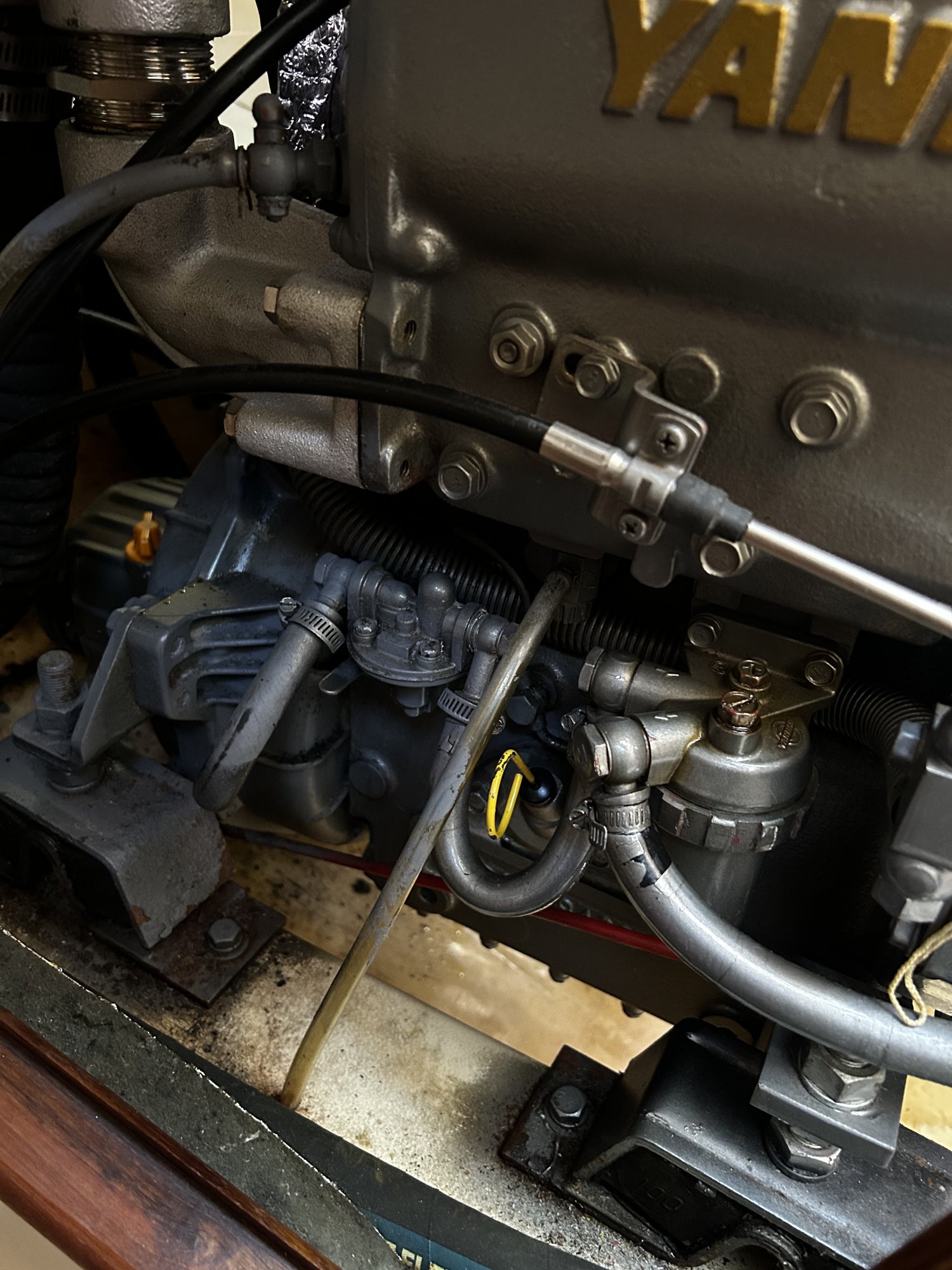

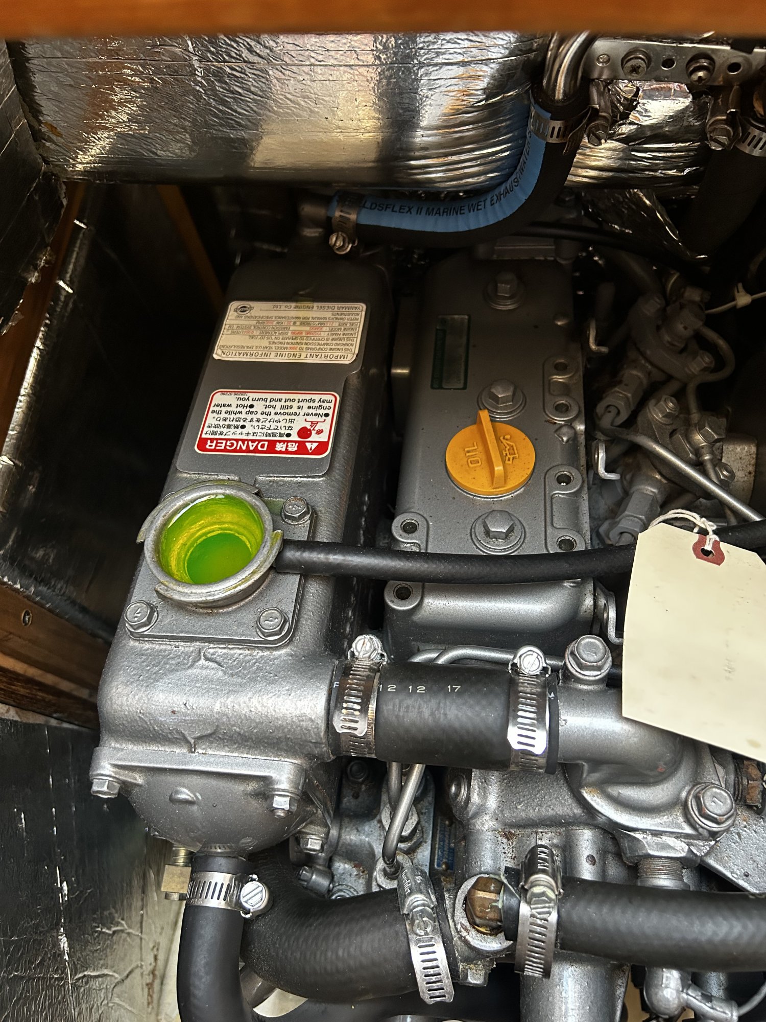

Looking at your coolant tank. It is overfilled. The black hose serves to send the overfill (as long as the hose is not plugged) down off the engine and into your bilge.
You also have a clear hose. Where is that attached? What is flowing through the clear hose? Does it also empty into the bilge?
Your engine looks very clean. You state that what is in the bilge is coolant. Could it also be oil? Attaching the cause to a cold winter would not be my first guess. You may have had a hose break, and that could be a cause. You did not mention that in your description of the problem. Such one-time-a-year leaks can be, but not always, connected to the engine. It could be how the engine is being serviced.
You might install an overfill tank and attach it to the coolant overfill hose. Much like the coolant fill tank in your car. This can prevent the overfill from emptying into your bilge.
8,102
Does that overfill tank have the OEM cap? Mack Boring told us unless the cap is Yanmar it is subject to leak. Mine did.

The picture makes the amount look worse than it is. It needed 5 paper towels, then a couple with a cleaner to wash the area down.
I check the oil and it is clean, so no water intrusion happening.
The clear hoses you see are connected to the petcocks on each side of the engine and to allow for draining the antifreeze from the block when I change it. And they are clear and dry. And just hang off the side of the engine and would drain to the area under the engine.
I do have to much in the coolant tank and that was a surprise to me.
I have an overflow that is attached to the black hose from the coolant tank. I’m leaning towards that hose being the issue. Either clogged or cracked.
Sep 26, 2008
792
Hunter 340 0 Wickford, RI
Yes it is the original cap on the overflow tank. Just a snap fit type. The tank itself is clean on the outside and not showing any signs of a leak. It really could be just a pin hole leak and given time it finds its way to under the engine. What does the cap on yours look like? I didn’t get a picture of it today but will in the next few days.
Sep 26, 2008
792
Same one as mine. Slides on a bracket fixed above the engine. I took it out this morning and flipped it over, thinking it may be cracked but it’s not.
I don’t have the scrub pad inside or the conduit covering the hose. I’m leaning towards the cap and hose being the issue.

What type of coolant is that (it should not be green)? Normally it would be orange/red if using the approved coolant types. Usually green coolant has silicates. Yanmar specifies a silicate and phosphate free coolant type. I find the Yanmar coolant is offered at a reasonable price. Otherwise, the Delo ELC is available almost everywhere. With the mix of metals in the our engines, having the right coolant is very important. Silicate drop-out could cause some serious problems / overheating.
