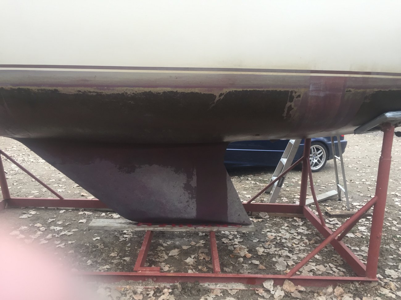

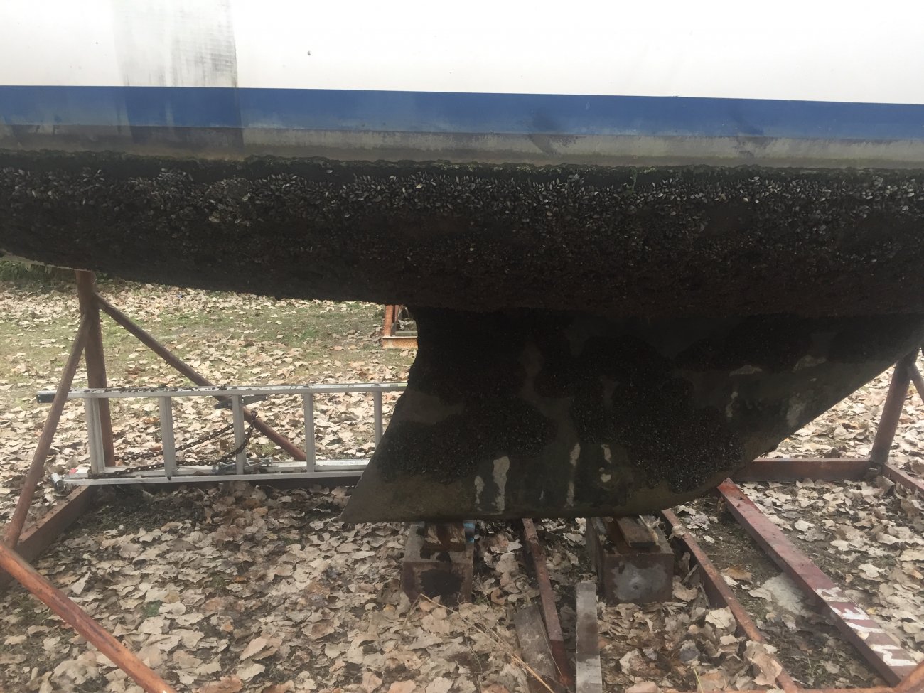

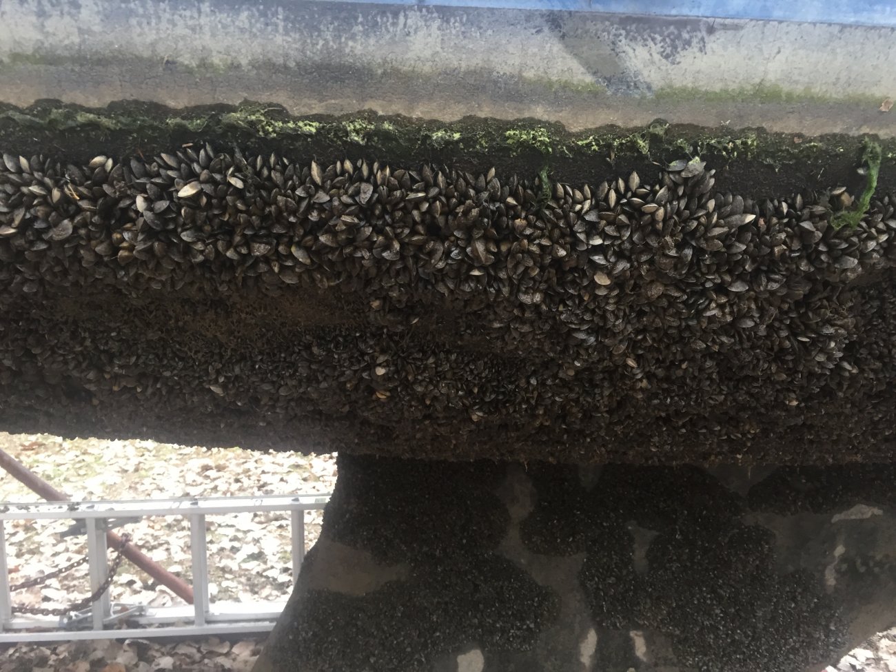

Boat is up on the hard. Glad I used VC17 vs whatever my neighbor uses !
FDL S2
Jun 29, 2014
485
S2 7.3 Fond du Lac

I use petit sr21 or vc17 (whichever is on sale) which I have always been told are basically the same. I paint the paddle wheel when I bottom paint and I have no zebra mussels on my hull and have only had a them on the speed paddle wheel twice in seven years of ownership-both times were after a few weeks of not sailing. I pulled the through hull, put the dummy plug in and cleaned it (once while sailing single hand).
