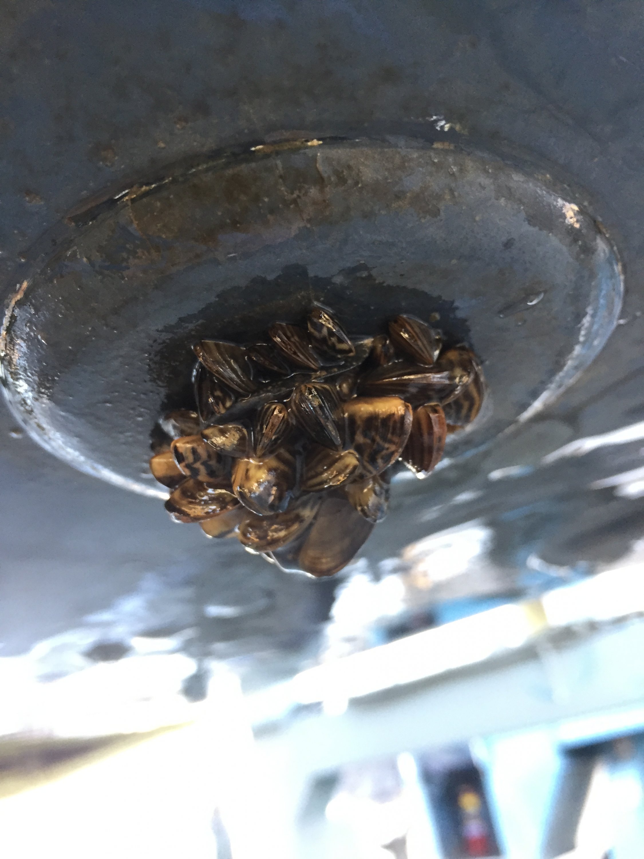

I have a Beneteau 311 with the original Raymarine knotmeter. The sensor for this knotmeter is a paddlewheel that sits in a fitting under the boat in front of the keel and slightly to the side. My antifouling paint does a pretty good job, but I don't paint the impeller. A few weeks into the season the impeller stopped working and at haulout I found this growth as shown in the attached picture (this picture shows the hull as it was at haulout, before pressure washing).
I scrubbed the bottom a couple times during the season from above, but I couldn't dive under the boat to clean it due a bad green algae outbreak (cyanobacteria).
I could try to pull the sensor from inside the boat and clean it while the boat is in the water, but last year I couldn't get it to budge. Before launch I will try to get it loosened up, but it would be better if I could do something preventative.

I pull my impeller when it gets fouled. It let in a surprisingly small amount of water as long as you have the plug in-hand to exchange with it. I have been told (though have never tried) that Desitin cream provides anti-fouling properties without build up. You could try that to decrease how often you need to pull the impeller for cleaning.

I’m not far from you and have had same issue in previous years. Now I just paint the impeller with VC17 when I do the hull, and no problems since..doesn’t seem to affect the impeller plastic at all, and VC17 is so thin it doesn’t affect function.

Thank you for you suggestions. I do use VC-17 on my boat so I could try that, or Desitin. How long does the Desitin last?
With VC-17 the solvent used to be so aggressive that I was afraid to touch anything with it other than the bottom, but in the last several years the solvent has been toned down. I was also worried that the weight of the copper would be difficult to distribute evenly on the impeller so that it would turn evenly. I was also concerned that the copper would interfere with the pickup for the knotmeter sensor, because I am guessing that the paddlewheel has one or magnets that the sensor picks up. Do you have a Raymarine paddlewheel type? Different manufacturers might have different plastics.

In the Chesapeake Bay we don't have those Zebras, but in the warmer weather we get mud shrimp and some other small critters that can build fast enough from one weekend to the next that the impellor will not rotate until pulled and cleaned. After a weekend cruise I pull the wheel out and put the dummy in till the following week.
Edit to add: I do paint the part that sticks out of the hull, but not the wheel itself. Use the same paint you'd put on the face of the depth transducer.

I have had the same problem with Zebra mussels on the impeller, but never that bad. The buildup I usually see are mussels no bigger than a match head at the most. I do not paint the impeller.
I would usually discover the problem as I left the dock and the knot meter not reading. To temporarily correct it, I would just go below and tap on the top of the through hull with the handle end of a screwdriver.
After a sail where that had occurred, I would pull the assembly and clean out the paddlewheel with a toothpick. I never worried about too much water coming in. I could switch out the paddlewheel assembly and the dummy plug easily and a dry towel in the area would soak up the water before it even got to the bilge.

Holy crap! I thought we had a zebra mussel issue when ONE lodged in my impeller and jammed it.. that’s crazy.
Jackdaw, my boat is on the Portage River just off Lake Erie, and we get a lot of farm land runoff, a big problem in Ohio where we have many more pigs and cows than people, and dozens of times more chickens. Also, the river is warmer than the lake which promotes fouling growth. I bought the boat from someone who kept it it Traverse Bay off Lake Michigan, across from you. I think he only put paint on every couple years.
On the positive side, the picture on my original post shows that the VC-17 antifouling paint does a great job on the hull.
