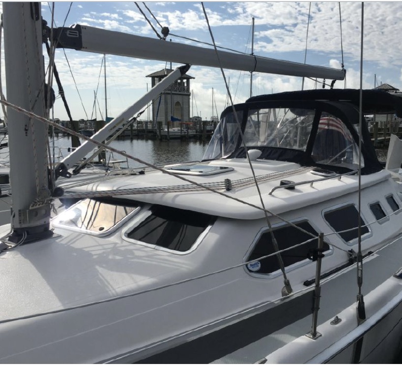

Looking at an image of a 2006 41DS forward window it has similarities to my windows.
Mine have laminated glass attached to the aluminum frame. The frame is set in a hole and sealed to the boat by either butyl tape or 4000UV adhesive caulk.
I took my window frames to an auto glass shop to replace the glass and properly reseal the glass in the frames. I have the windows back at the boat, and I now have to prep the boat decks to reinstall the windows.
