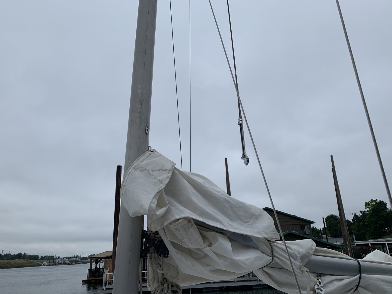

I have a New to me Hunter H26. The guy I bought it from didnt pay any attention to details. Shroud adjustments are all non existent. First off the mast has about 20" of rake measured at the boom. Should be 6". The forestay is too long. Turnbuckle bottomed out. Threaded ends touching inside the turnbuckle. Any suggestions?

I’m thinking that cutting off some threads under the turnbuckle won’t get me the 14” less take I need? But it’s worth a try.

The mast step is fine. Not issues there. Might just need to shorten the stay. Are there fittings that can be used without special tools? What would be used to cut the stay?
