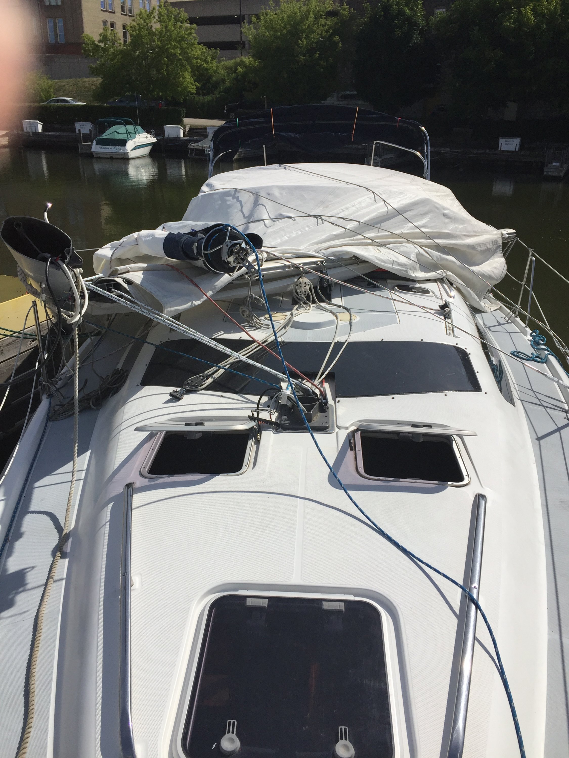

It was a beautiful day Saturday on Lake Michigan as we set sail from Racine, WI with winds out of the northwest at 12-18 knots and 2-4' seas. Out of caution I had a single reef in the main on my Hunter 376.
We bought the boat at the end of last season and I had the main recut, added a Strong track, and all new electronics. I've sailed over 100 miles in short trips this year and this was just one more tune-up before my wife and I began to take longer trips along the lake shore

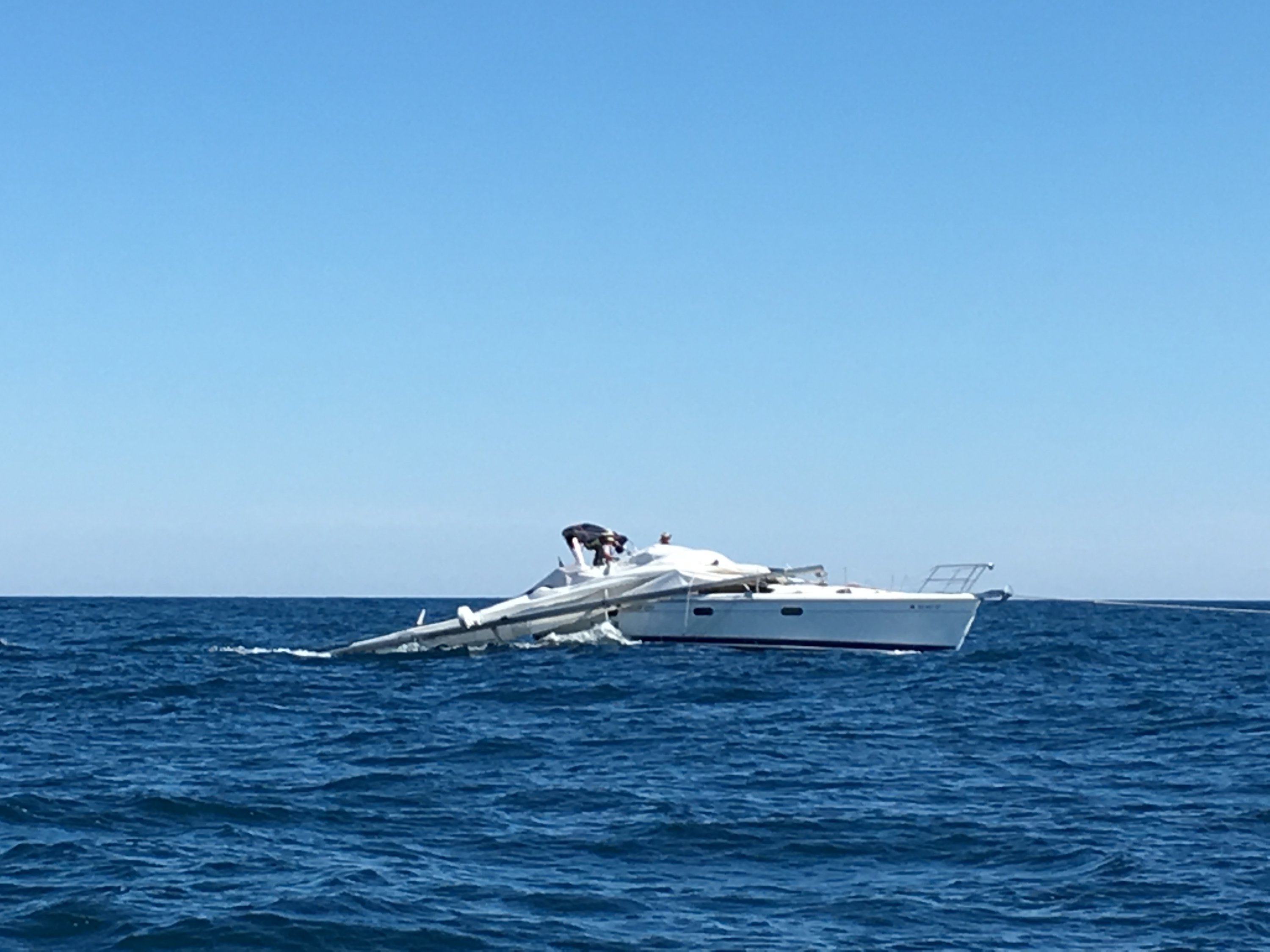

We tacked back toward Racine, after about 90 minutes so that I could get my 3 crew members back for their club dinner. About 20 minutes into the new course we heard the sound of metal screeching and then I saw the roller furling drum swing up to the left and the mast twisted to the right and dropped down onto the deck and over the starboard rail. The dodger frame deflected the mast and protected us from injury. Friends on two different boats heard our mayday and surrounded us until the Racine Sheriff's boat could tow us in.

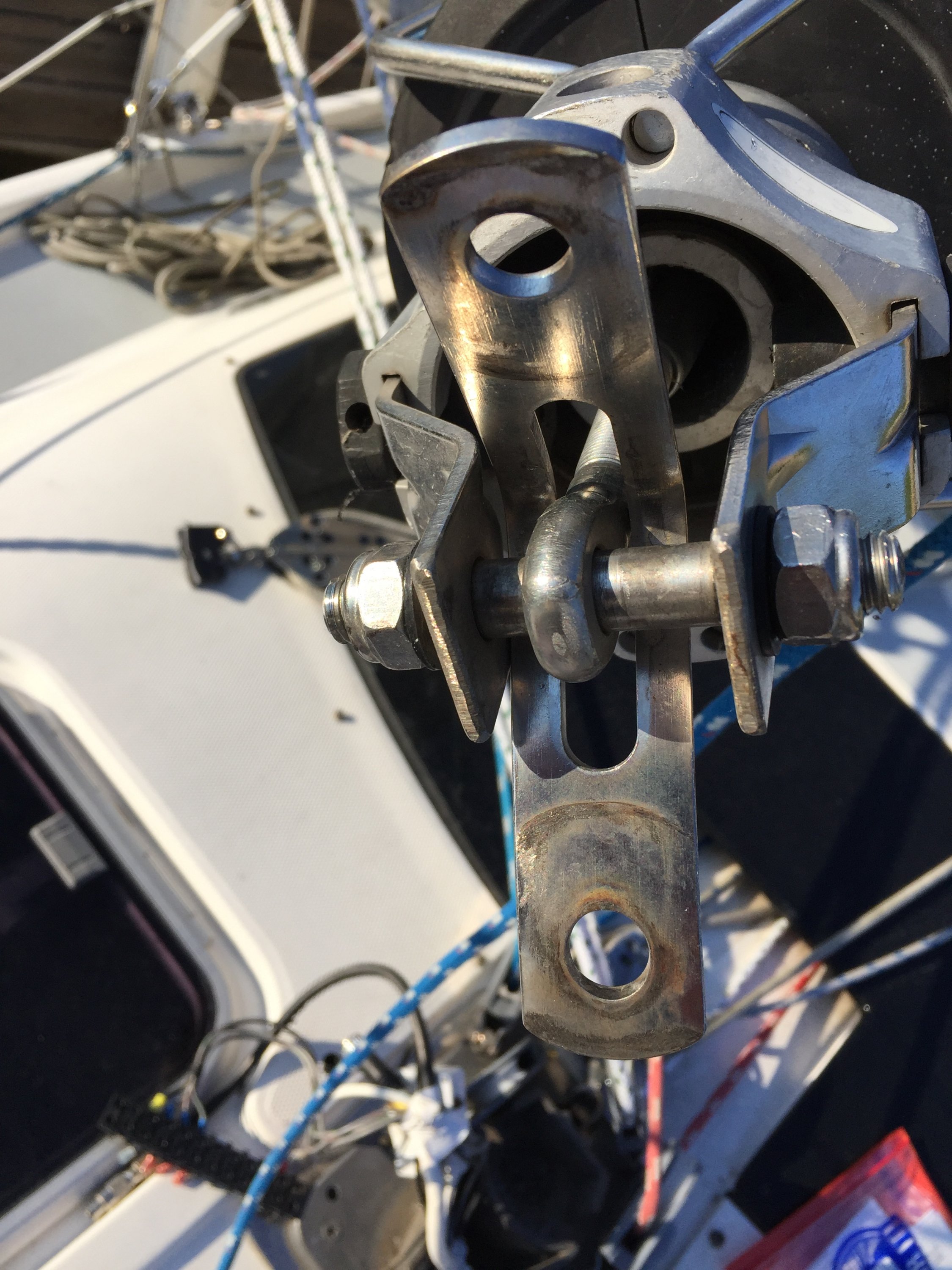

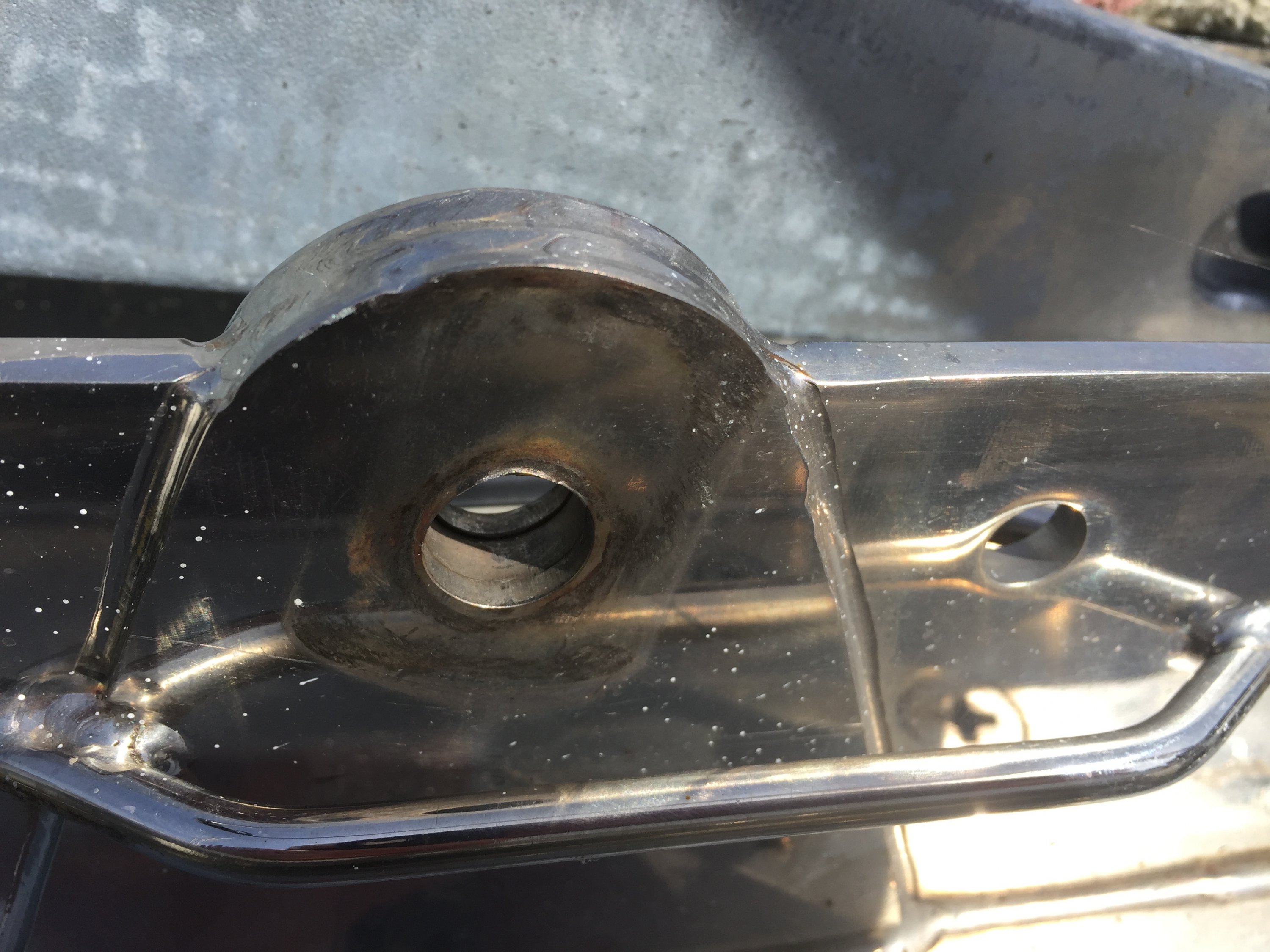

Looking at the bottom of the furling drum I can see that the tang is spread open, indicating that as the clevis pin worked its way out, the stress on the tang caused it to open an then fail completely. My guess is that the yard forget to safety the clevis pin after installing the new radar and wind instruments
BoatUS's surveyor will take a look on Wednesday to assess the damages. I'm attaching a few shots.image.jpegimage.jpegimage.jpegimage.jpeg

Sorry about your mast. The two times I had a rigging failure on my own boats were after yard work. One I caught when I saw the leward stay swinging off the chainplate. The second time was exactly the same. I found the cotter pin on the deck the one time. I have no idea how it came out; the pin itself was gone. The second time, the pin was on the deck but no cotter pin. I had looked over things after the install, but evidently not closely enough.

I hate hearing stories like this. I am an airworthiness inspector in an aviation maintenance repair facility. One of my responsibilities is to ensure that items that require safety devices such as cotter pins ( don't even get me started on those stupid rings folks use ) or safety wire, actually do get the required safety. The mechanics accept as a matter of course that although I trust them to do it, I need to verify since many times it is a safety of flight item with a "SINGLE POINT OF FAILURE". It is extremely rare that I or any of the other inspectors find a problem but it does occasionally happen. Usually it's because it was due to a job not being completed by the end of shift and it got missed during turnover or such. In a boat yard there is no additional layer or oversight for safety so as boat owners we have to provide that by ourselves. That is not to say that the boatyard is not totally to blame. You hired them to do a job and it wasn't completed properly. As a side note, I have noticed so many times that when using a 'split pin' or what I call a cotter pin, the pins are not bent properly to keep them from working loose.

@kimelmore I'll bite. What the issue with the circle clips?
I had to laugh when I read the FAA material on cotter pins: "Their use is favored because they can be removed and installed quickly". Not true in my experience. They are a b*t*h to remove, and to bend properly.

Why the mayday?
I agree - why "mayday" -- lives don't appear to be in imminent danger. PAN seems much more appropriate.
That's kind of the point as I had a circle ring work loose then the pin popped out and down comes the mast. I will probably be switching to cotter pins with the new rig.
8,050
Beneteau 323 Annapolis MD
I have circles all over the boat. If one of appropriate size "worked loose", then there's another story there somewhere.
