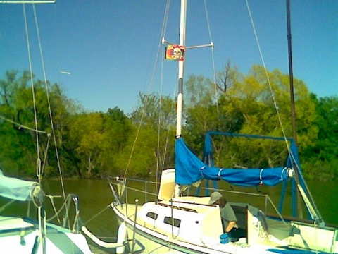

I am attaching a picture of the boat in the water. I think the boom looks pretty normal, not too low at all. I do have to duck under it, but not any more than anyone else I have seen.

looks right to me
Yes, to my eye at least, your boom looks ok.
It's not necessary, by the way, that a main go to the very top of the mast. I'm not sure that it's even desirable. Particularly if you don't have a cunningham, you want a few spare inches at the top. Then you can flatten the luff in a heavy wind, by cranking on the halyard.
