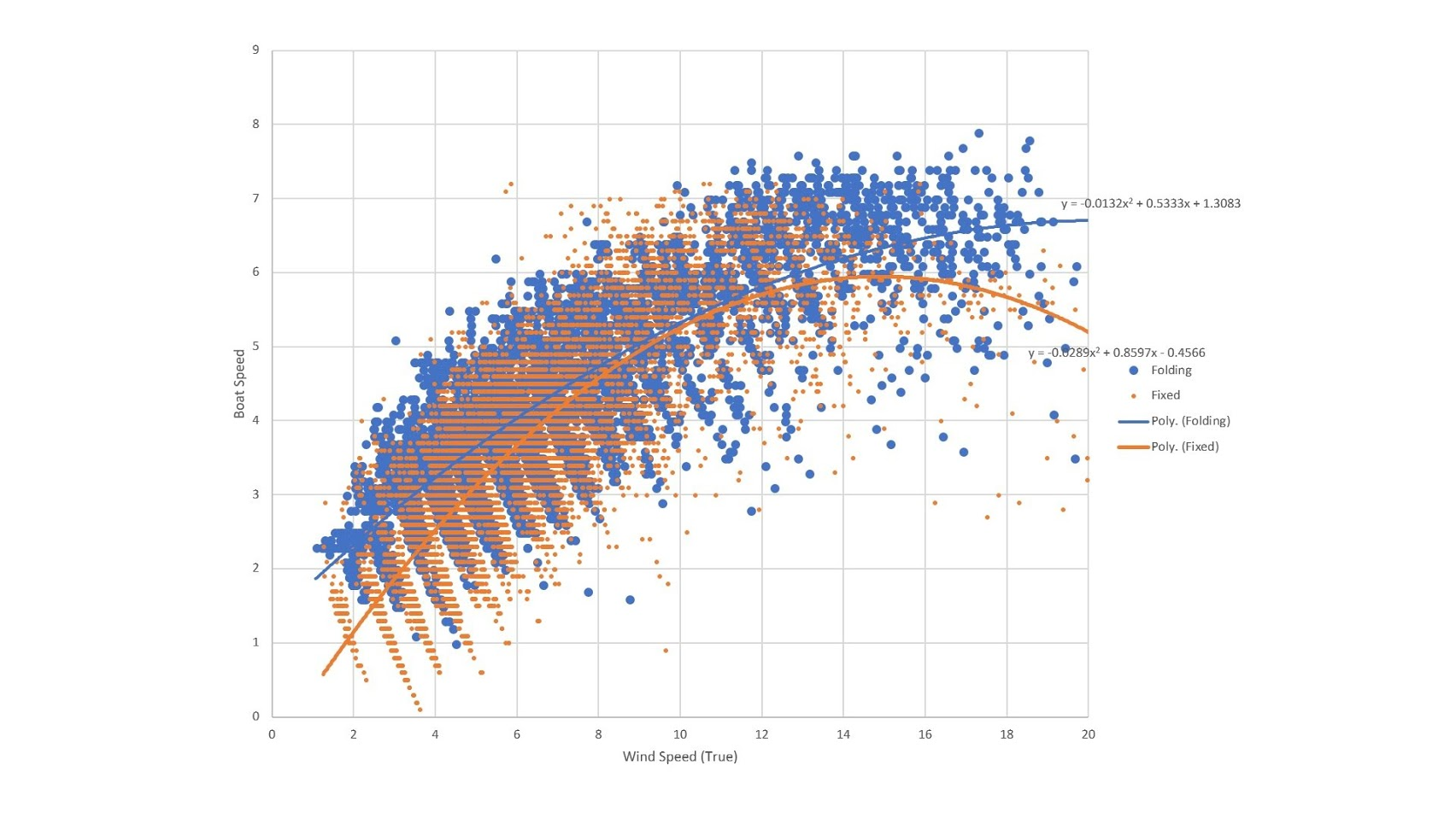

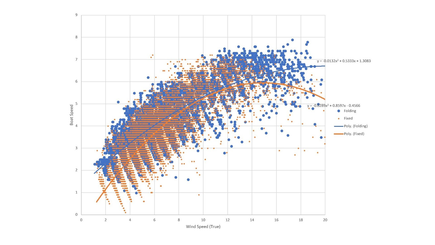

Here's an actual plot of my boat's speed from a couple seasons of 3 blade fixed prop (orange dots) to 3 blade folding prop -
Notice that at low wind speed the fixed prop slows the boat by about a knot. They converge as the wind increases. At higher wind speed the fixed prop created lots of turbulence in front of the rudder, stalling it, but the folding prop lets it continue to work better.
(Data is from upwind legs of races for a few seasons. To be fair we had more experience with the boat after a few seasons, so some of the speed difference might be improved tactics and sail trim, but probably not all of it.)

most sailors do not sail in 3 knt of wind, or 30 knt of wind. look at david's graph. where most of you sail there is not much difference in speed. so you say, "i don't race. i just cruise" and then you are totally happy dragging around your motorboat prop.

I have the highest density of dots (most often sailing) in 4-8 knots of wind. That’s not the range with the biggest speed difference, but it is still significant, especially in the lower part of that range. Plus I have a boat that was already very competitive in higher wind ranges, so the lower wind was really where I needed the help.

I think your graph best represents my theory/opinion. Look on the graph where performance between the 2 prop variables is closest together. It's at the point where you might average over a long distance. Therefore, the advantage would seem to be given to the boat with the larger handicap because the performance is nearly equal to the boat with the lesser handicap. I don't think I agree that a long race helps balance the anomalies, in fact I think it is the opposite. I think that the longer the race, the larger the imperfection of the handicap looms. And I also would suggest that the drag from the prop becomes less of a disadvantage as the boat speed increases, just as you are suggesting that a light boat loses it's advantage as boat speeds increase to hull speed. Intuitively, I think that a folding prop loses it's advantage the longer boat speeds remain relatively constant (also with less maneuvers, typical of a long race) where acceleration is less a factor.
