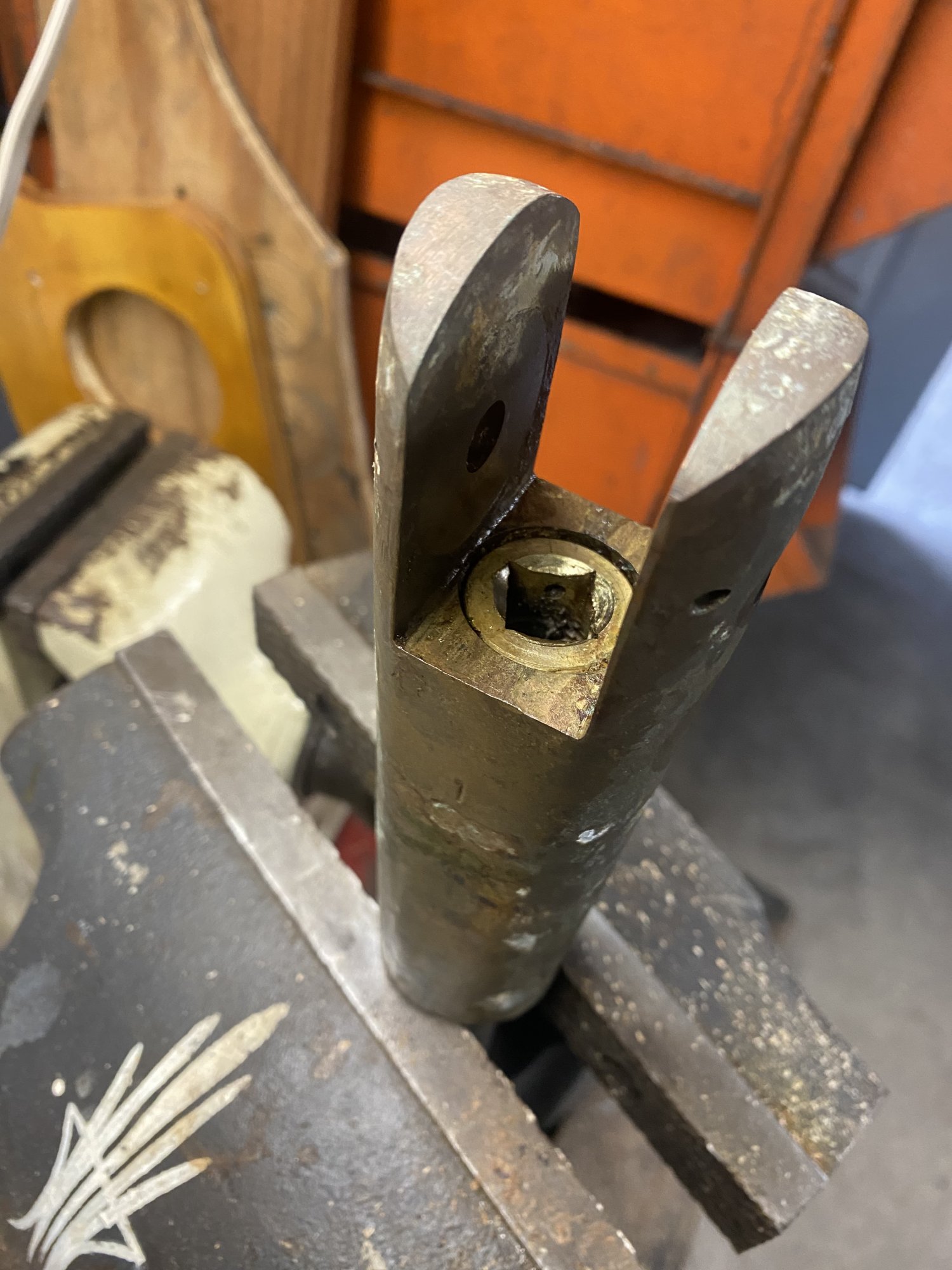

I inherited a Catalina 30 and with it this scrap yard prop. Before I bang on it, what is the correct way to remove the cut-off prop shaft? That square recession has my attention.
Thank you!

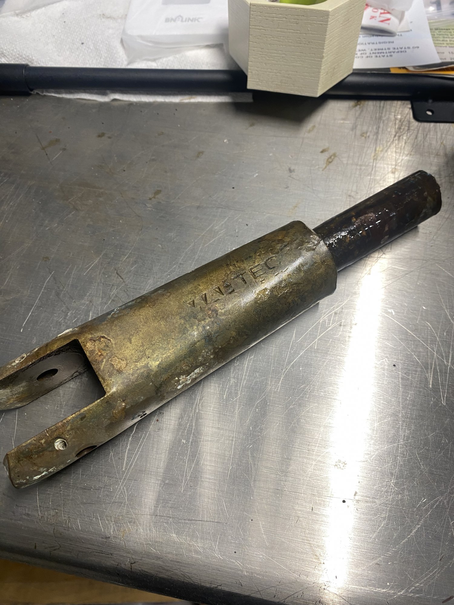

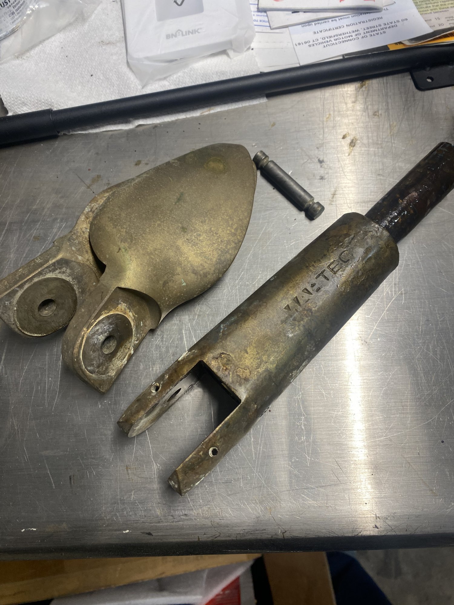

Looks like an Eliptec Folding Prop
24,473
You might want to seek out replacement parts, before you get to deep in the woods on the project. It looks like someone took a hammer to the prop at one point. I would guess an attempt to get it off the shaft.

It would be difficult to service the prop yourself. Part of the service is to fill and re-drill the holes for the pivot bolts and to add more bronze to the worn areas. Mechanically these are really simple props, however, over time the opening of the props causes wear on the hub and on each blade where it mates to the hub. The wear affects the blade angle, so they will open more than 90° and resist opening in reverse.
The "correct way" is to use a prop puller and a 3-inch long 1/2" socket extension. On the workbench you might be able to get away with a 3-armed gear puller.

I'd have someone set it up on a hydraulic press (carefully) with the 1/2" extension like mentioned above.
