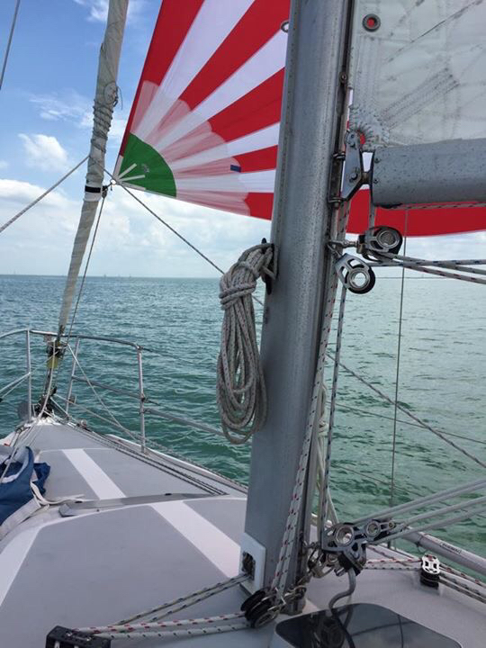

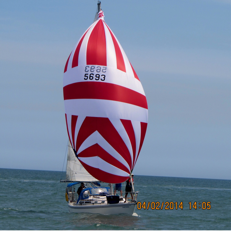

Here's a Geniker (a code 1 actually) moving us at 5+ knots in 5 knots of breeze.
Looks like you fly that sail with the sheets led between the forestay and the code 1, ergo, you gybe between?
Correct, if your spin is mounted far enough in front of your forestay, you can do an inside gibe. If its closer you have to do an outside one, or roll and unroll if its on a roller.
Gee, that looks a lot like ours. Ray driving, the admiral reading, and me wandering around looking for things to video. :)

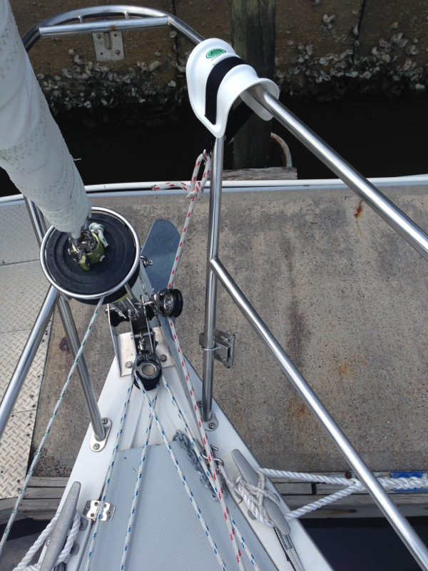

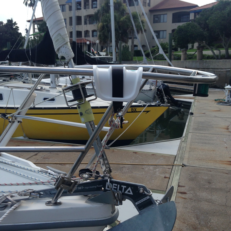

On Catalinas without a bowsprit it's common to put a small block on the tack line which is then shackled to the anchor roller. The problem then is interference between tack line and bow pulpit, with a device like the Tacker from ATN the tack is attached to forestay around the furled headsail. The tack line can then be lead inside the pulpit and doesn't interfere.
http://www.atninc.com/atn-tacker-sailing-equipment.shtml
Likes: justsomeguy
Oct 5, 2010
322
Catalina 30 mkII St. Augustine
justsomeguy said:
Lookin' good. How easily does that Tacker slide up and down your furled foresail? I love my parrel beads.
Very easy. I would say no problems.
