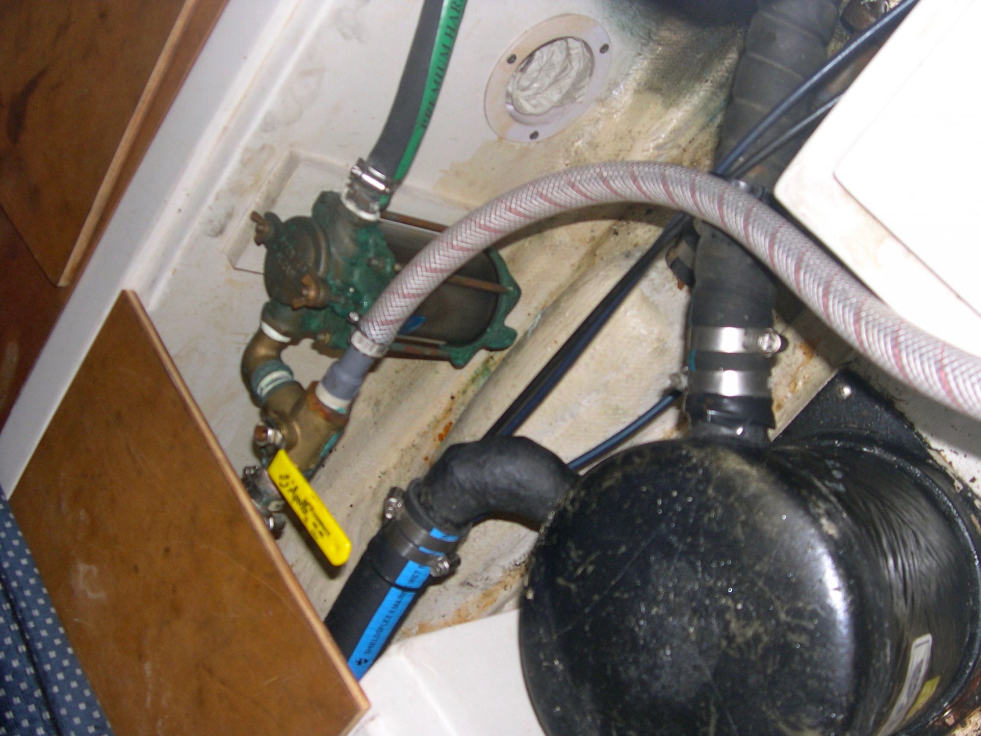

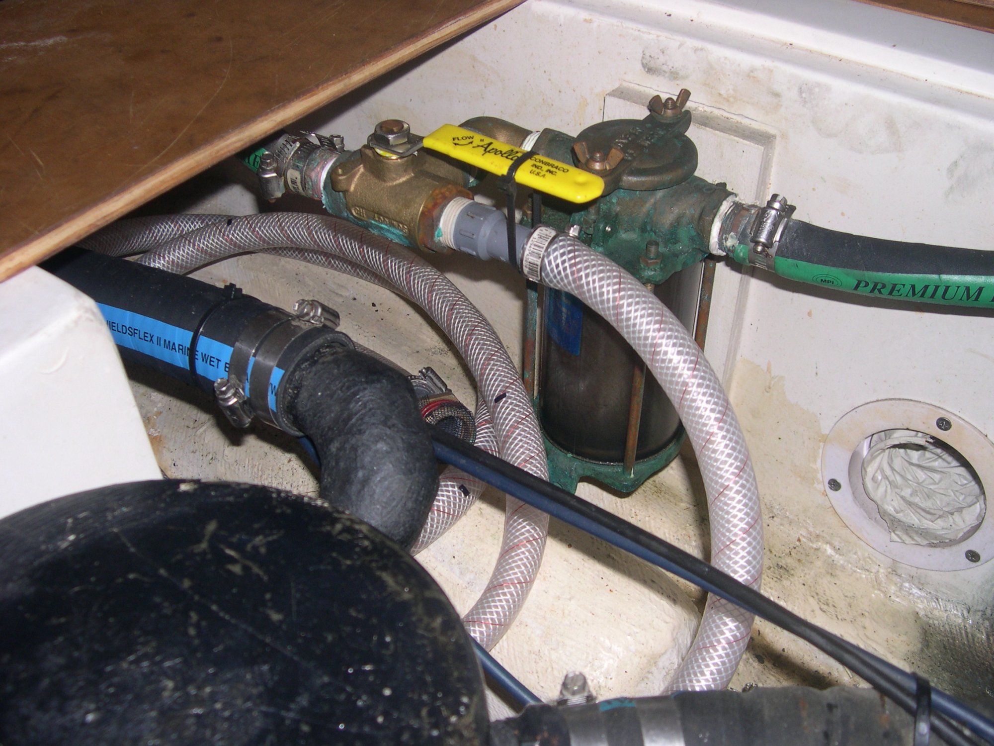

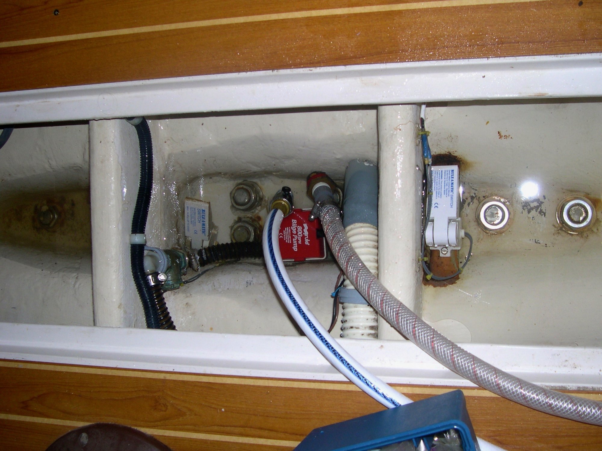

Jul 1, 2010
990
Catalina 350 Port Huron
Our Seaward 25 has a 1gm10 in it. I installed a t in the sea water line with a ball valve and hose on it so I could flush it. I installed a hose spigot near the bottom of a 5 gal bucket so I could quickly hook up the hose end from the engine for flushing. I did this setup mainly for winterizing and running the engine on the trailer, as we kept the boat in fresh water. When we took it out for a trip in salt water, I flushed it when we got home.
Since the 1gm10 is a sea water cooled boat without a closed system, it may make some sense to flush it with fresh water periodically when you keep it in salt water and store it with fresh in the system from a corrosion point of view. Not sure how much effect it would really have on the longevity of the motor, though.
  • Helpful
Likes: SailorElliot
Tom J
Sep 30, 2008
2,325
Catalina 310 Quincy, MA
That seems doable, thanks for sending the photos!
You're welcome. BTW, the Flicka 20 is a beautiful little cruiser. I helped a sailor tie up his Flicka one day, and I was impressed at how seaworthy she looked!
