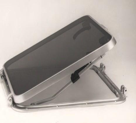

I replaced my original V-Berth hatch with a used Atkins and Hoyle hatch. As you can see in the photo the design allows the hatch to open from the front or rear by reversing the support rod and changing the pins.
