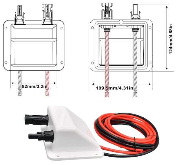

I have two flexible solar panels atop the bimini of our Hunter 41AC. I just ran the cable down the outside of the arch (held in place with velcro cable ties) to the stern where I mounted a solar gland to route the cable into the swim platform lazarette. I bought the gland on Amazon and it looks as pictured in the photo. This setup makes it easy to detach the cables and remove the panels when necessary.

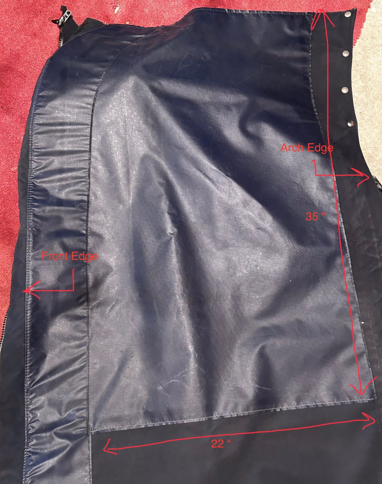

I had to remove my bimini this week to throughly clean it from a very active group of birds. So I had the opportunity to photograph what I did to lay the panel up there.
I mount my old 20 watt rigid panel on the front section of our bimini and run the cable down along the stainless steel arch using velcro ties as dkinzer suggested. It’s a neat clean look and not noticeable, at least no one has ever asked about the cable and what is it for.
I had a vinyl piece sewn onto the canvas and lay the panel on that rather than just laying it on the canvas. This takes the wear from the constant movement away from the canvas a rigid panel can cause and has avoided any holes being made in it. New flexible panels are more forgiving but will still cause wear on canvas.
I can use zip ties to hold it in place as the arch has predrilled holes already in it to feed them through. This keeps it from flopping around in the wind.

Here is a photo of the vinyl piece we have.
