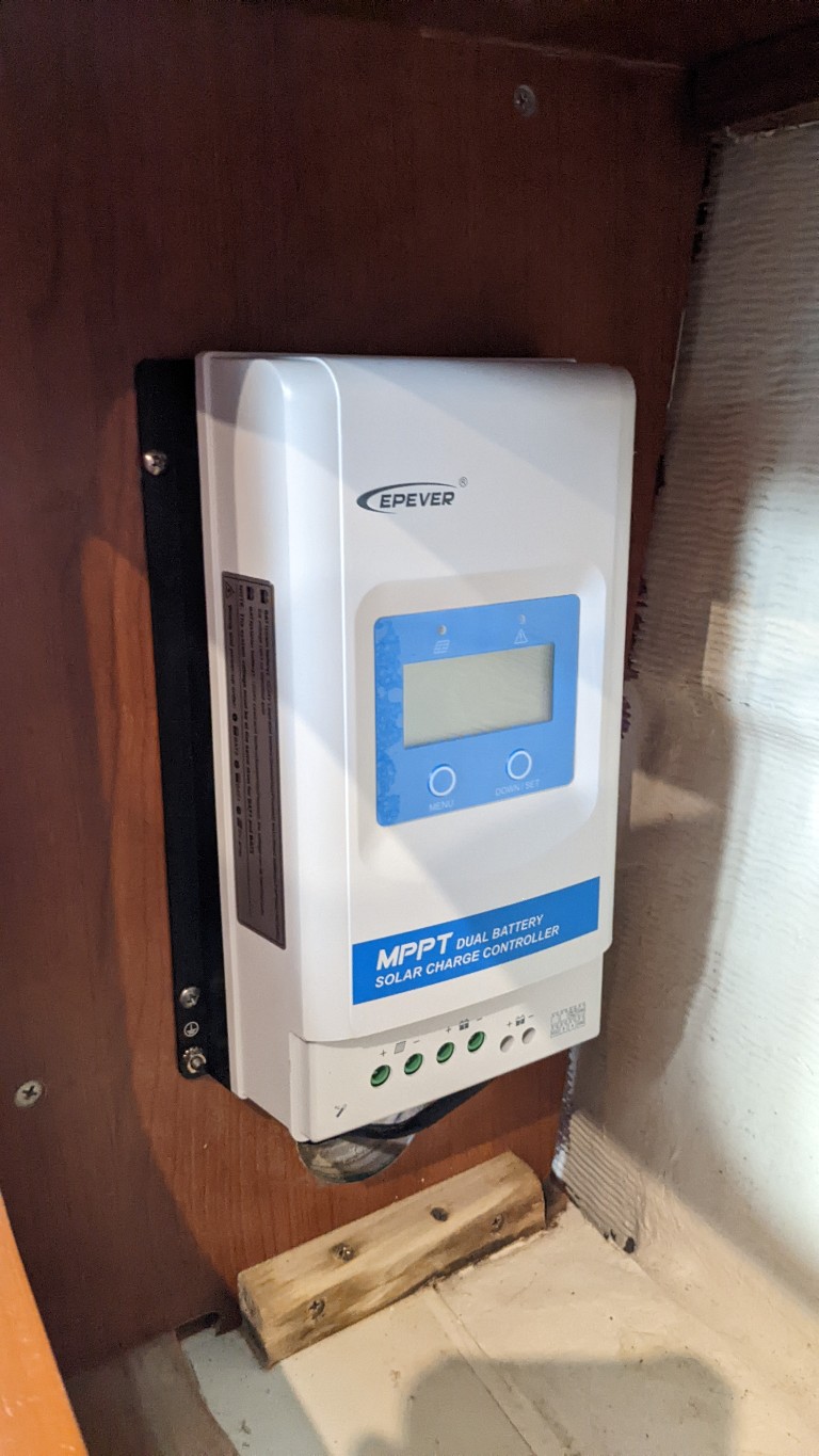

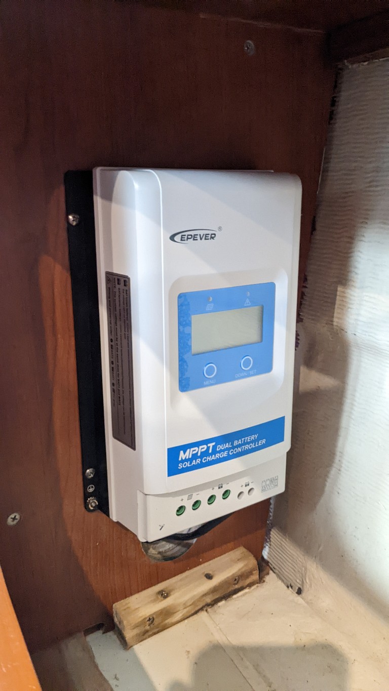

Started my installation. Installed the controller behind the port settee. Cables pass through a 1-3/4 inch hole into the cable locker. I chose this location as the locker under the helm seat didn't have enough ventilation and clearance. Locker below the settee was already occupied with the charger and inverter.

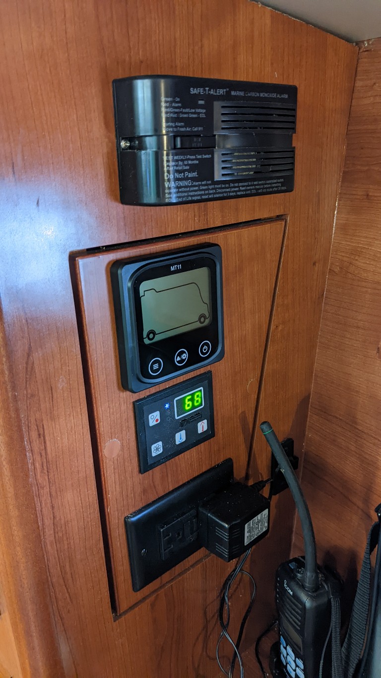

The remote panel for the solar controller was installed above the HVAC thermostat.
