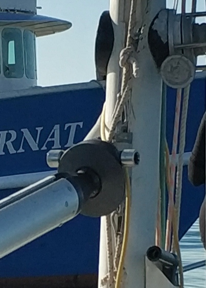

Thank you for your welcome reply. The mast track and the goosneck are seen in the picture attached. I am using original setup, it works, but there is a lot of winding and inserting slides to the mast groove - not conveniant.
Nowdays I use battery drill machine with some bigger torque to make furling fast - the problem is inserting slides to the mast. If the drop is somewhat slower, this is not problem, it can be an advantage: when furling, I pull the sail down anyway it is better not to fall free. Changing the angle of the boom when furling helps getting around the problem with the distance between the tack and the mast, too.

Nice picture of the gooseneck.
It looks like the gooseneck is in a slot in the mast.
Does the slot extend all the way to the top of the Mast?
Do you have sail slugs (the middle fitting) or slides (the metal lower fitting)?
If you have the groove/slot in the mast, you can take your sail to a loft (or you can talk with the maker of your new sail) and see if they can install a "bolt rope" instead of the slugs to fit into the groove on the mast.
The metal slide fits a track and the mast track will not work with a bolt rope.

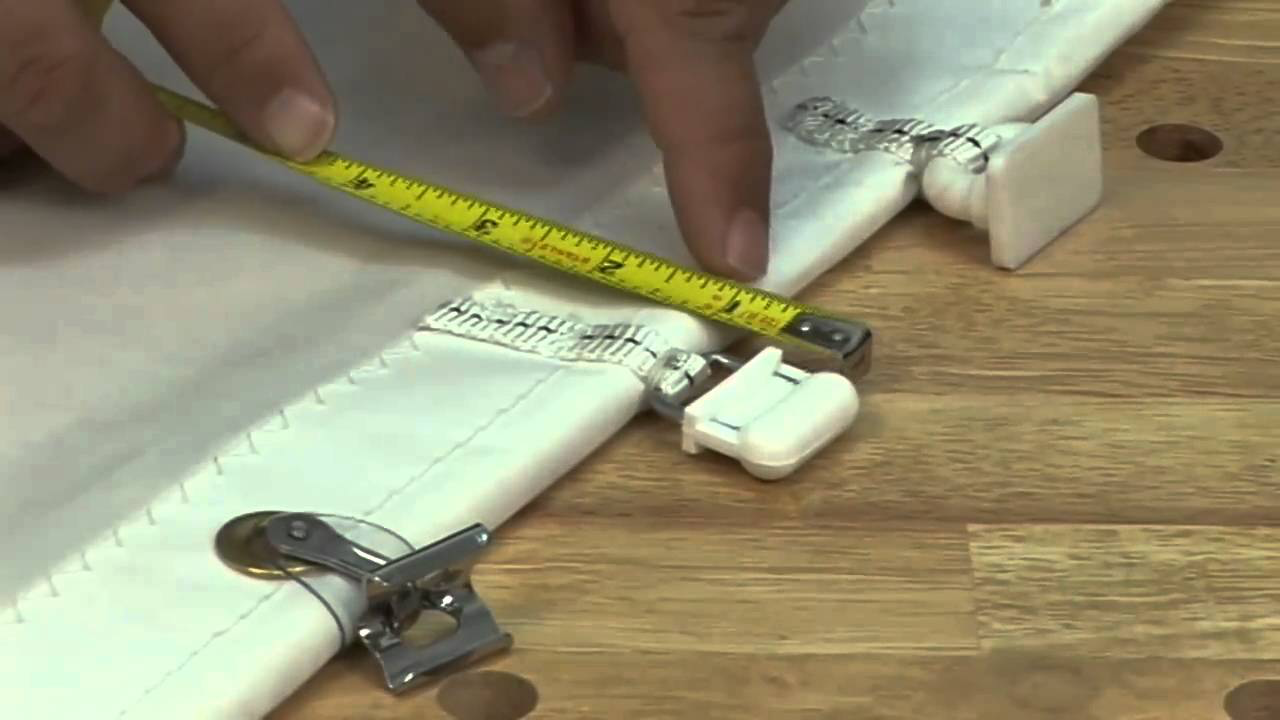

If I understand your question correctly, I don’t think you can do what you want, and a sailmaker can’t help you do it either. Tthat mast will not accommodate a bolt rope, no matter what you do to the sail. You would need a new mast.
If the groove in the mast is flat/ rectangular, it will not accommodate a bolt rope for the luff.
Another way to say it is this: If the mast uses a flat plastic slide, like the flat white one shown in jsalem’s picture above (which I believe should have been credited to www.Sailrite.com) it will not accommodate a bolt rope. You would have to modify the mast and I don’t know any way to do that.
