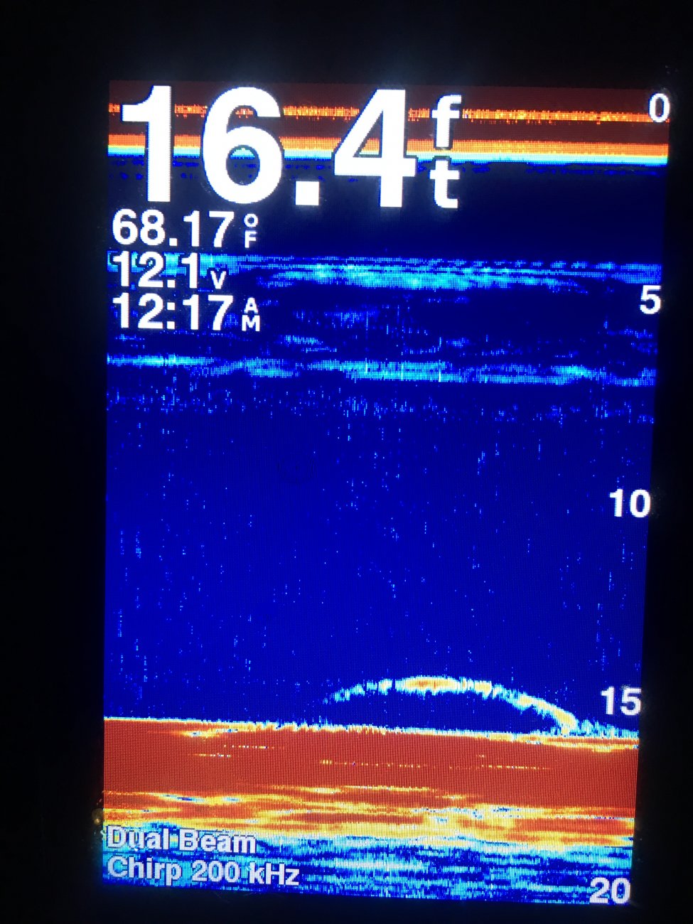

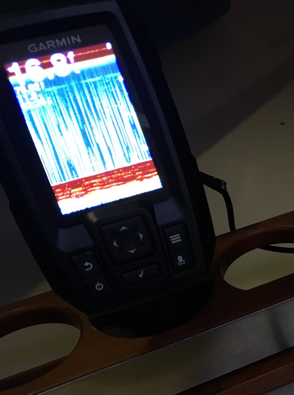

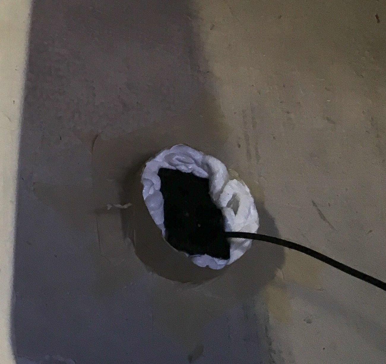

Not a really important topic, but I was messing around with a fish finder transducer in my Cat30, and wanted to glue it inside the hull.
I used one tube of clear silicone then another tube I thought was clear but ended up being white because I wasn’t paying attention.
And I wasnt thinking when I squeezed it out and didn’t think about air bubbles, so being a little too late to undo what I just did, I decided to see how well it would or wouldn’t work. Worst case I’d let it dry and start over later. I pressed the transducer into the blob and tried to squish it enough to try to flatten out any bubbles under it, and the immediate results were really noisy.
I waited a day for it to mostly dry and checked again, prepared to rip it out, but it looks pretty decent today. A bit of noise, but looks good enough to use.
Here’s the install, and the before and after pics of the silicone wet and mostly dry:

Thru hull transducers work fine. I think you got a little carried away with the silicone.
End result is it worked.

I also have an in-hull transducer in my 1980 C30. I picked a spot on the STBD near where the fuel tank is located.
If unhappy with the noise, here's how I found the right spot.
I placed my transducer inside a Ziploc baggie filled with water. I then moved it around while checking the unit for good signal strength minus any noise & marked the spot. It's also possible that the bubbles causing this may in fact be in the fiberglass hull & knot a problem with the caulking..

Those top lines actually look like a picture of the bottom side of your hull. Kinda neat.

I've used wax from a 99 cent toilet ring to stick it down temporarily (for a couple of years and also to locate where it will work well) and it works great. For a more permanent fix a glob of 3M 4200 has worked for me.

I "temporarily" mounted the transducer for my GPS/fishfinder in a glob of toilet ring wax 5+ years ago. Still works like a champ.
