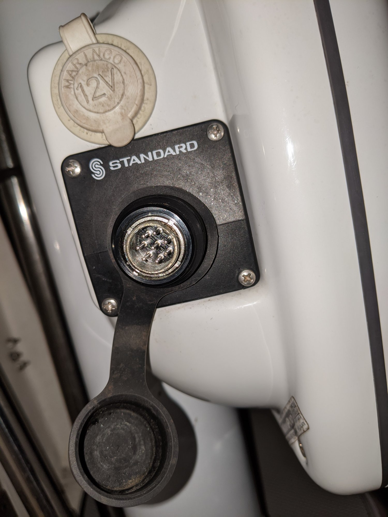

1) What is the socket in the image (the black one below) called? It is to the port side of the helm station. What is it used for?

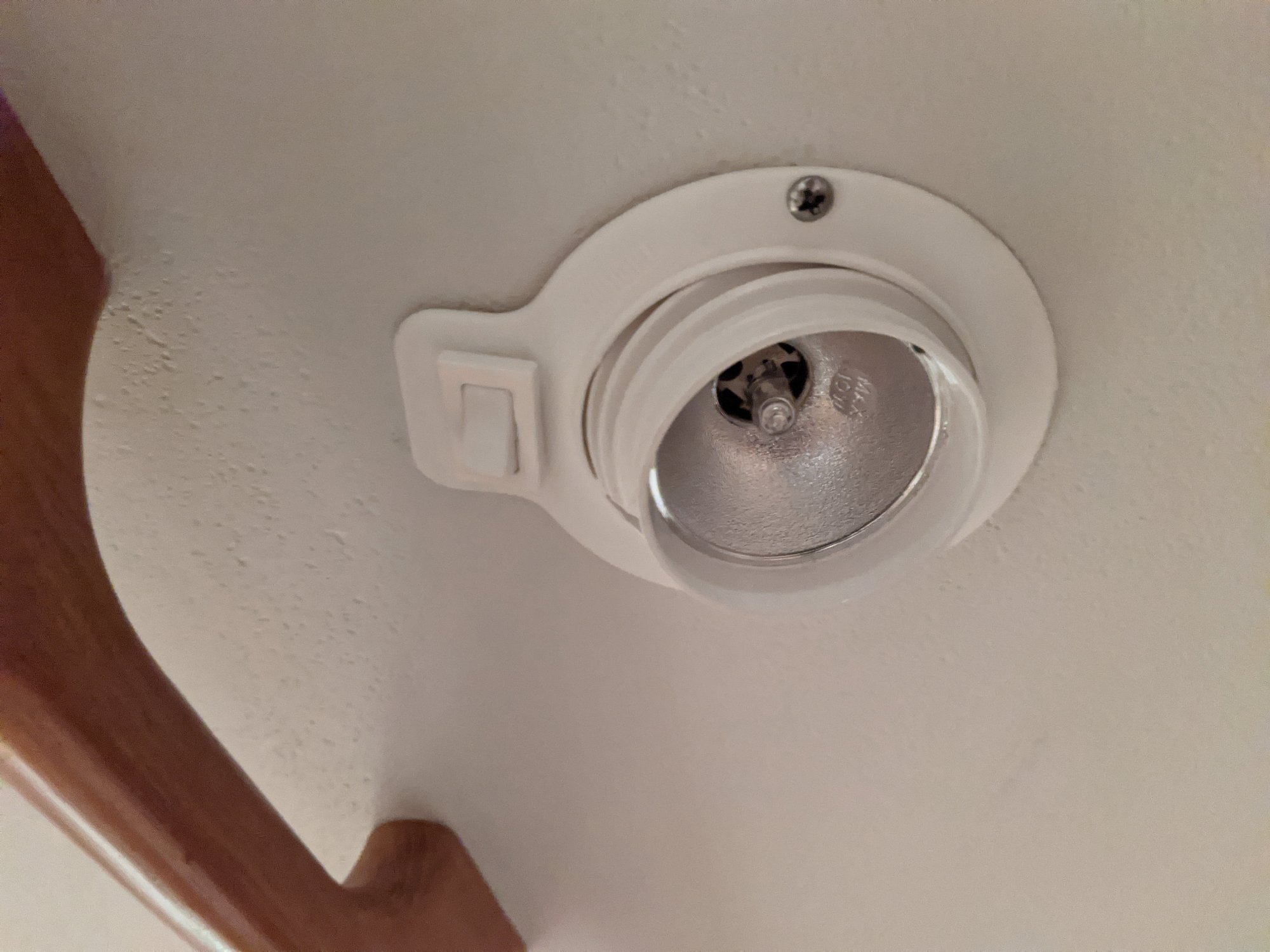

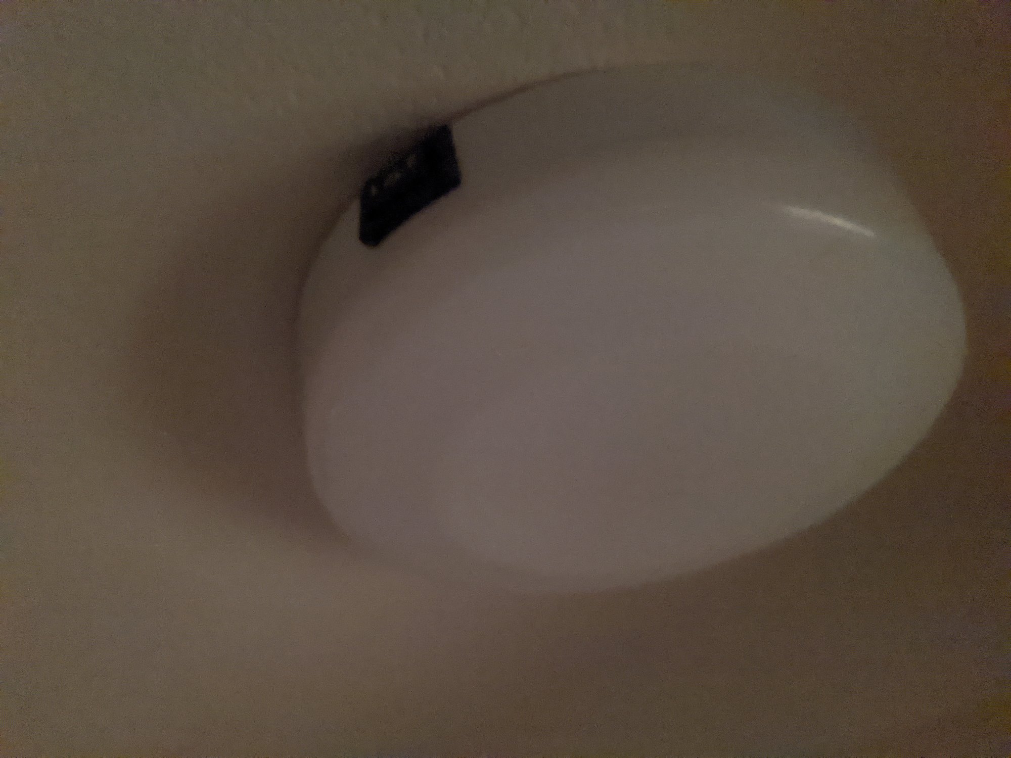

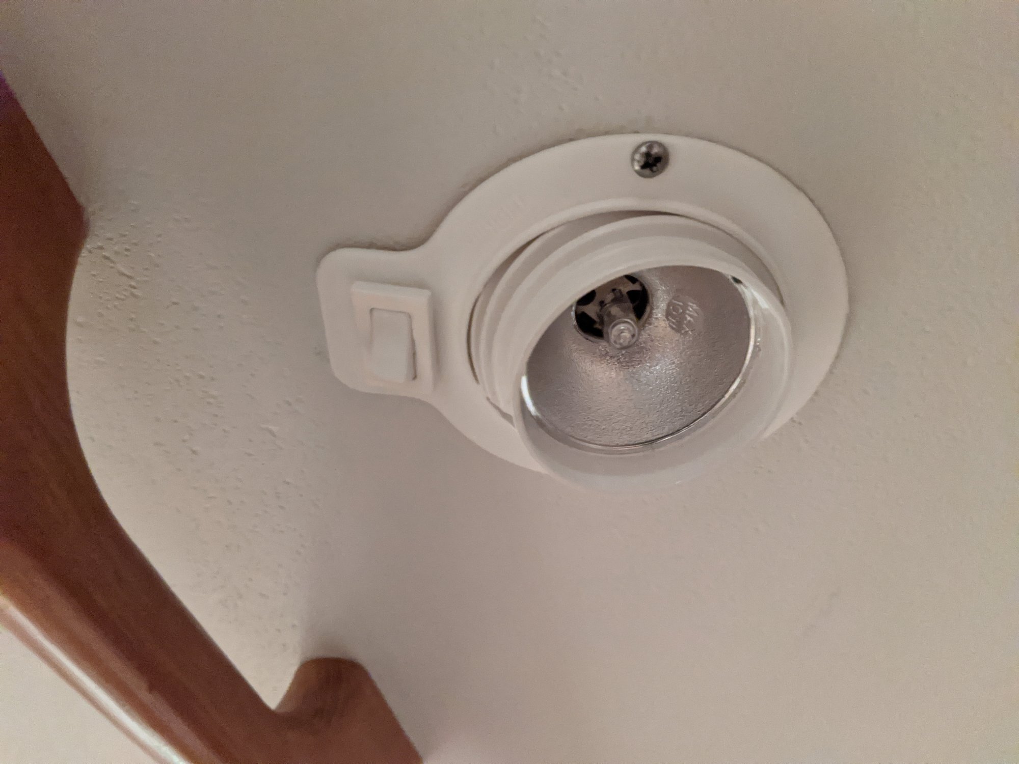

4) I believe the cabin/head lights on the boat are original and probably have incandescent bulbs. I would like to replace these with LED counterparts. Any recommendations for direct replacements?
View attachment 186221View attachment 186222

I recently dealt with all of these same questions. You're come to the right place for answers. The RAM mic for that black connector is for the remote speaker/MIC for your VHF radio. Depending on the model of the VHF radio, the RAM mic optional unit may no longer be available new. Look around for it in the boat, because they are a little hard to find on eBay. I would note that the RAM mic is good to have as you really can't hear the VHF radio from the cockpit while sailing (especially with the engine running even if cranked up). I recently restored mine and it was well worth doing.
I also replaced all the lights in my 310. In my case, most of the switches were bad and I had to replace the entire ficture (came with LED bulbs). I ordered them from catalinadirect.com and they worked well and fit using the existing holes from the old ones.
Good luck

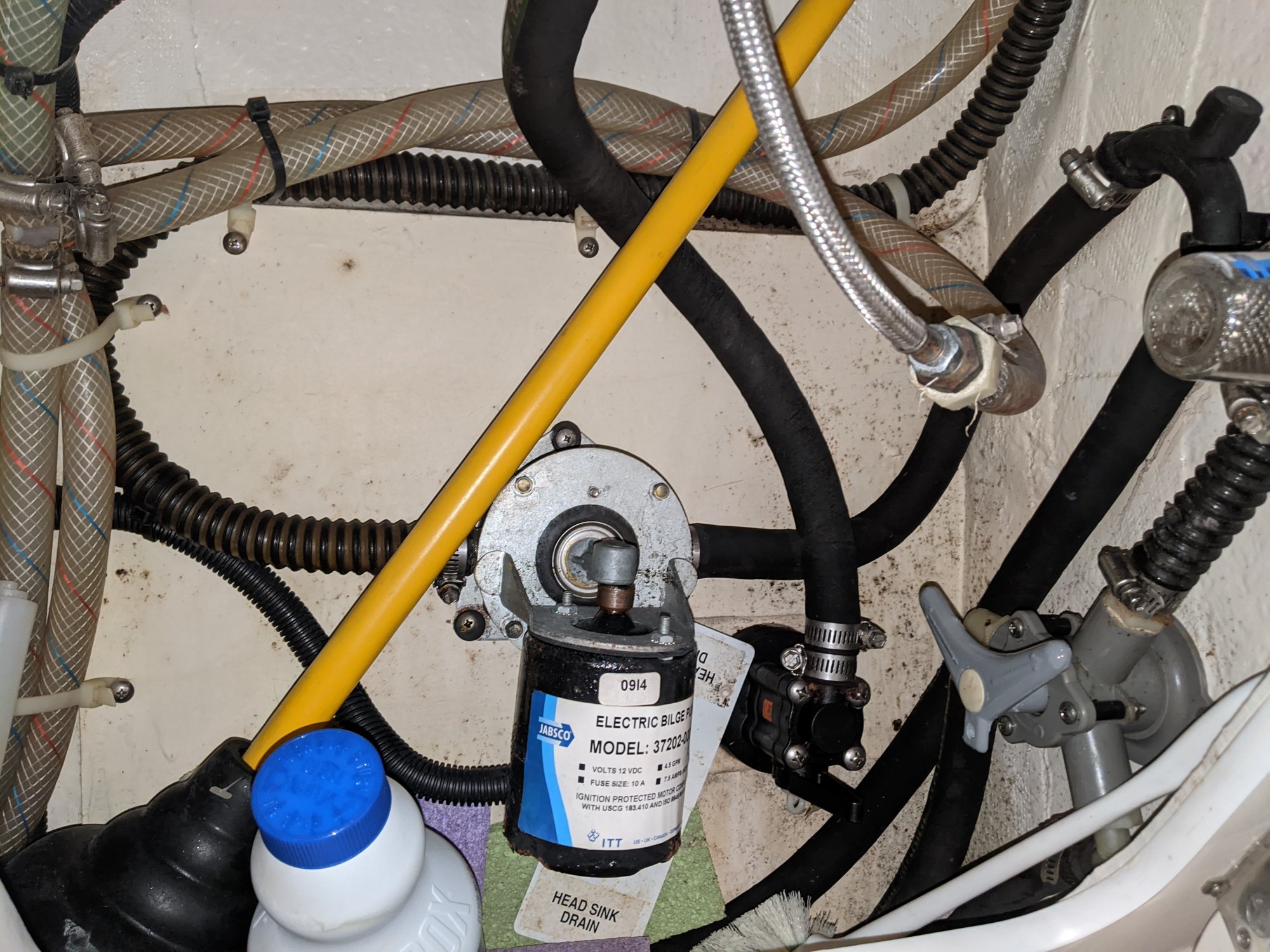

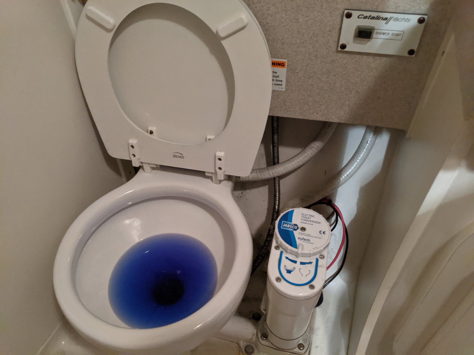

Oh dear....NOT a good idea! Except for toilets designed to use onboard pressurized flush water, all manual and electric marine toilets are designed to PULL flush water in. Pushing water through them can misalign seals, gaskets, o-rings and wet/dry cams in the pump. Plus, unless a sump is cleaned at least weekly, water being pushed through it is full of body oils, dirt, and soap scum that can foul up a toilet pump.
There's a much easier and SAFE way to supply clean fresh water to the toilet that I've recommended since the mid-90s:
Sink drain thru-hulls are below the waterline on almost all sailboats. So re-route the toilet intake hose ("Reroute" means "disconnect it from the head intake thru-hull and tee it into the sink drain line, it does not mean "tee a new line off the head intake line! ") to tee or wye it into the sink drain line as close to the seacock as possible because the connection must be below waterline to work.
--Peggie
These 310's have a shower faucet right above the back of the head. It's easy to just run water directly from that faucet right into the head.. We always flush with fresh water shot directly into the bowl from that faucet. it gives you the added benefit of shooting the stuck turds off the inside of the bowl too for added fun.

Replacement LED bulbs are easy to find. Consider using a few that are red/white combos. Very convenient for night time sailing.
i went with a mix of red/white and blue/white that looks really nice at night.. blue's along the sides of the boat and red's on all the overhead lights.
bought all of the LEDs from Marine & RV LED Replacement Bulbs
A possible alternative to a RAM mic:
Many VHF radios have a RX Speaker mode. When this function is turned ON, the received audio can be heard on an external speaker. That way you can monitor your VHF received signals through cockpit speakers. Of course if hailed you will need to use the mic below decks to respond.
But that doesn't provide you with a way to flush all the sea water out of the system with fresh water before the boat will sit, nor does it make winterizing a snap by just pouring antifreeze down the sink (with the thru-hull closed, of course) after you've pumped out and thoroughly flushed out the tank.
You can eliminate the stuff stuck to the inside of the bowl if you add water the bowl--a couple of beer cups full from the sink--ahead of solid waste deposits. If the water drains out of the bowl before you have time to use the toilet, your joker valve is waaaay past due for replacement!
--Peggie
--Peggie
I never open the seacock to let it in and only flush using drybowl each time since the flush water rains from above. So sea water never gets a chance to make smells..

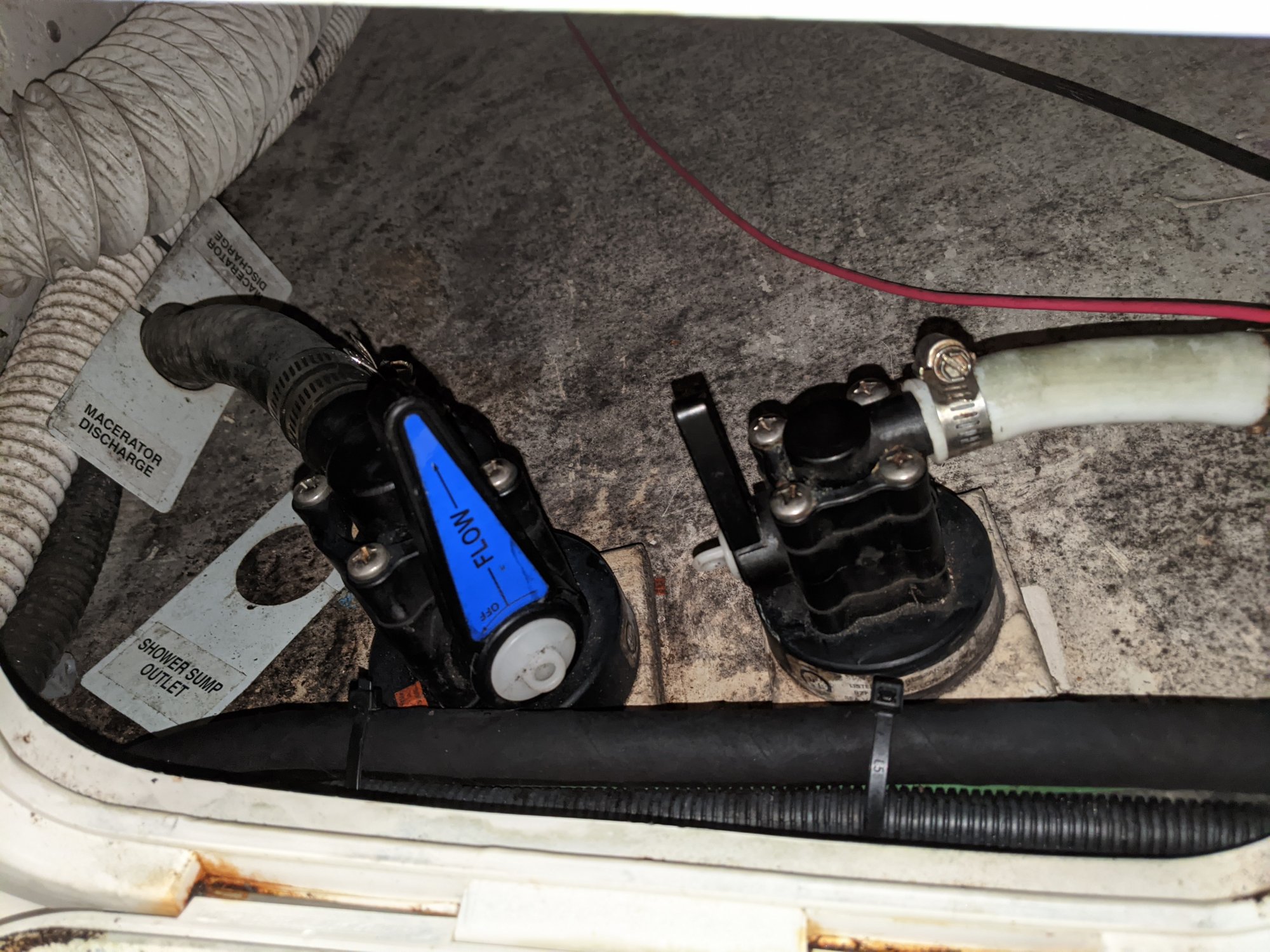

Peggy, there appears to be confusion regarding the freshwater flush. This was discussed between you and me a couple of years back on a threat in this forum. (I have your book). There is a T in the sink drain, above the seacock that drains the sink overboard. This seacock remains closed. The T hose goes to the toilet raw water intake on the toilet pump. In my case, I capped off the raw seawater hose with a plug and two clamps (see later discussion). To flush, put water in the sink. Add water to the bowl, as desired from the shower fitting. Turn valve to wet flush. Water from the sink goes through the toilet pump, into the bowl, and flushes. When bowl is empty, turn valve to dry flush, and pump to push everything into the holding tank.
Raw water seacock in the C-310 had two functions:
- One, let raw seawater into the toilet. This no longer occurs with the above modification.
- Two, the inlet hose is T'd to the shower drain / refrigerator drain pump. This connection remains. Open the valve, turn on the shower pump, set the valve under the sink to either shower or refrigerator, turn on the show drain pump, and drain away.
Nothing from the toilet can back into the fresh water system. There is no connection between them.

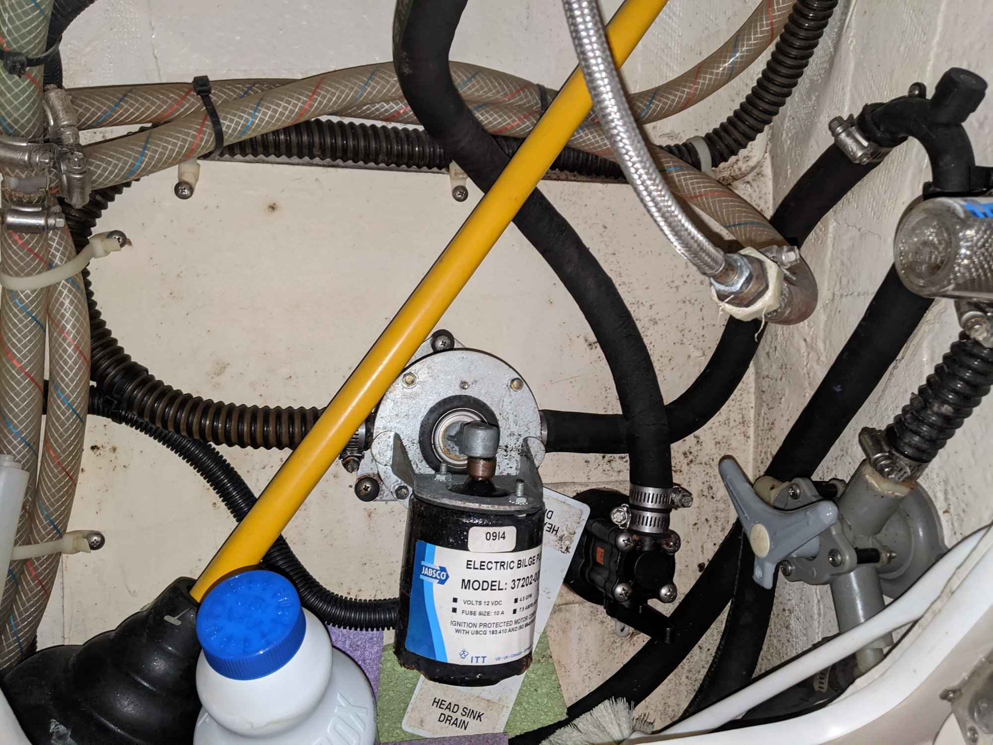

How does the toilet pull anything out of the shower sump? There shouldn't be any connection between them.
--Peggie
Don't underestimate the creativity of previous owners.
Our 310 came with a fresh water bladder tee'd into that hose so that only fresh water would flush the toilet then go into the holding tank. The broker spoke of it as a "feature" and it was noted so on the survey.
Due to the excess "head smell", I have pulled out ALL of the waste lines and also the fresh water side.

3) Previous owner installed an electrical toilet. I have attached images of the toilet, the plumbing under the head sink and the plumbing next to the shower in case it helps. Very basic question: What is the basic steps to operate this electric toilet? Currently it doesn't flush. I'm sure I need to turn on a switch somewhere. But before that I also want to make sure I have all the valves in the correct position to send the toilet contents to the holding tank (and not to the ocean).
View attachment 186224View attachment 186225View attachment 186227

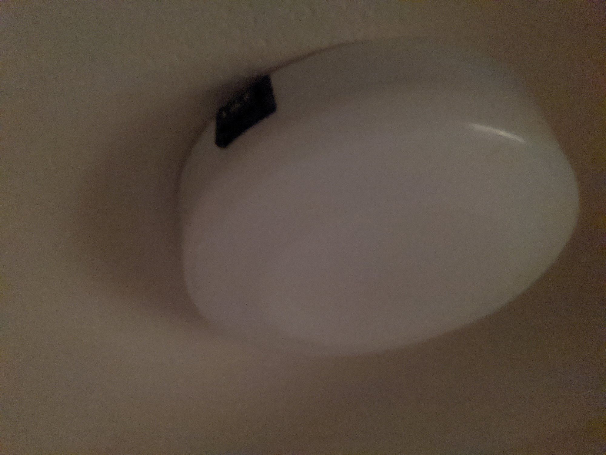

Catalina 310 Annapolis
Hope you don't mind, but it looks like one of the seacocks in your photos (maybe one in the hatch in the head that provides raw flush water to the toilet) appears to only have one house clamp on it. As a basic safety issue, you will probably want two hose clamps for any houses stretched to seacocks below the waterline. You might also want to check them for fit (sea if any are loose) and any corrosion.
