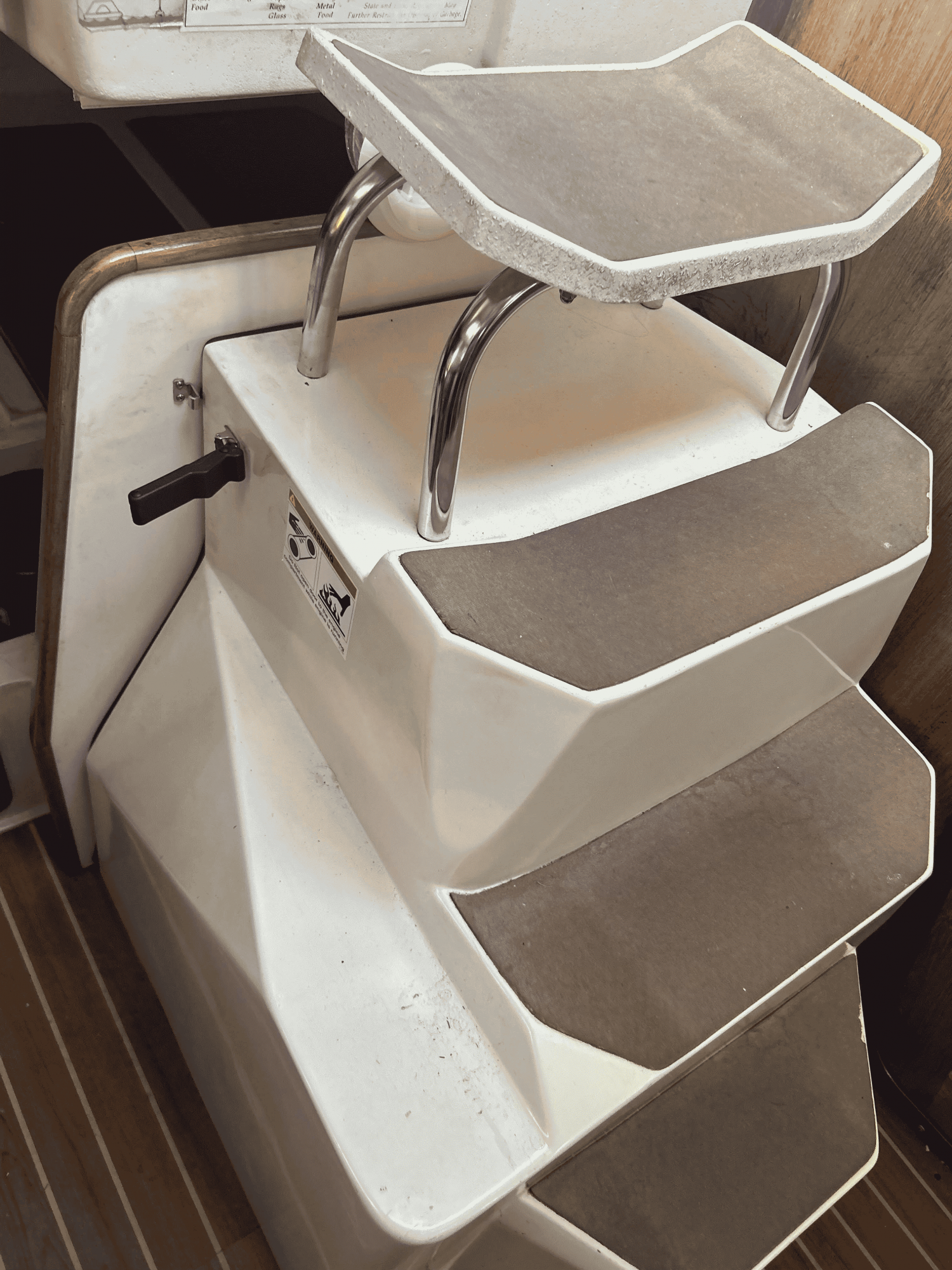

Catalina 310 242 New Orleans
I can't speak directly to a Catalina 310, but mine is installed on the front cover of the engine bay.
On the 310, the front of the cover is also the companionway steps. Putting a port in the steps might make it hard to align a fire extinguisher vertically.

Do you have a photo you can share? On my boat, the steps have to be removed in order to remove the front cover of the engine bay, so I don't have the same limitation.
Nov 15, 2023
14
I don't have a photo. The cover is a large fiberglass box with steps molded into its forward side.

Nov 15, 2023
14
Here's a photo of the 310's engine cover / companionway.
Maybe the triangle area on the aft end would be a good place for the port. Low enough to get to the base of the flames. Extinguisher could be almost vertical. Or right under the latch.
