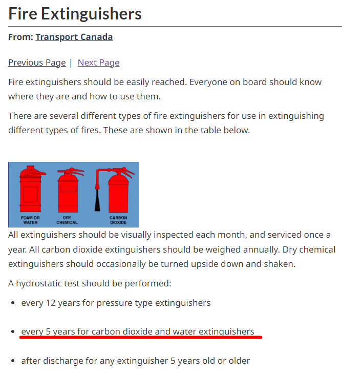

Hate to admit it but I became curious about re-certifying CO2 extinguishers. Transport Canada says :
I thought I knew how to read, but apparently not. Every five years they require a hydro on :
(1) carbon dioxide extinguishers
(2) water extinguishers
(3) carbon dioxide and water extinguishers
None of the big names manufacture "carbon dioxide and water extinguishers" so I'll take that as a faux pas on their part.
I do have to go along for with a hydro after a specified period of time for CO2, propane, and other bottles as there is no way to determine what the exterior condition of the cylinder is, hence everybody gets tested.
My CO2 is in new condition so screw them (pardon my French).
Agreed.
5 years for CO2 pressure test ?
I would think the 12 year rule would be ok with CO2 with visual inspection. Wonder why they say 5 years.

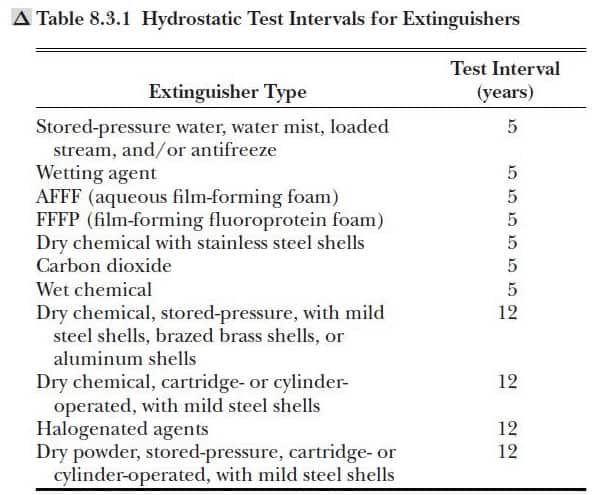

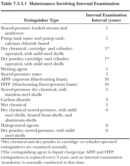

For those interested, here is a link to National Fire Protection Association (USA Trade body)
Here are some NFPA 10 pages related to inspection and hydrostatic test intervals.

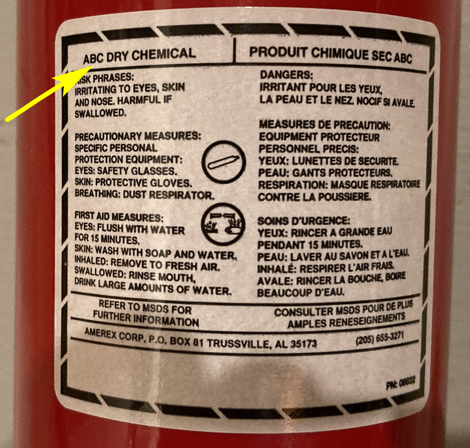

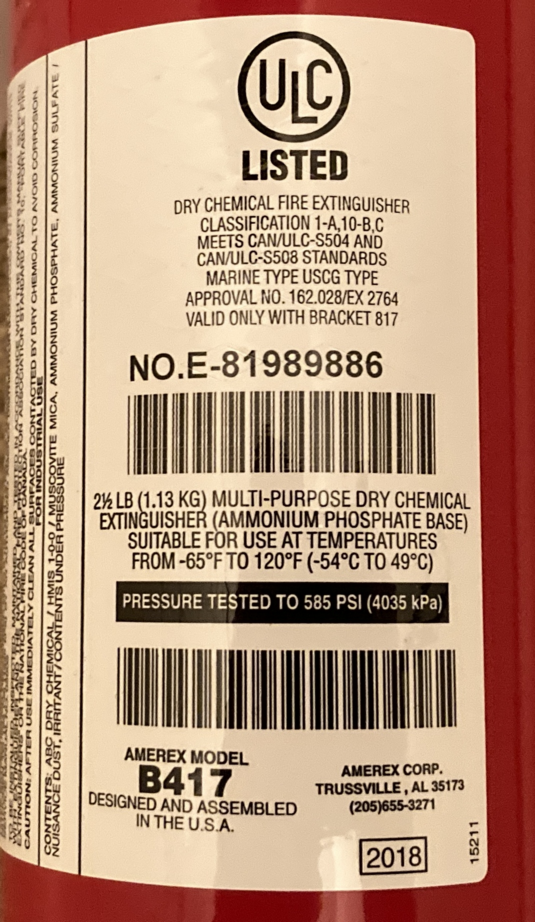

Don't all vessels require an ABC extinguisher ? This is my latest one(s) which is rechargeable :
Apparently a CO2 is not acceptable as a primary on any boat (except as a backup) as they are only rated as BC. They can't handle A fires because they require a wetting agent or a material which coats the combustibles.
Mar 20, 2015
3,306
C&C 30 Mk1 Canada
That was my understanding.

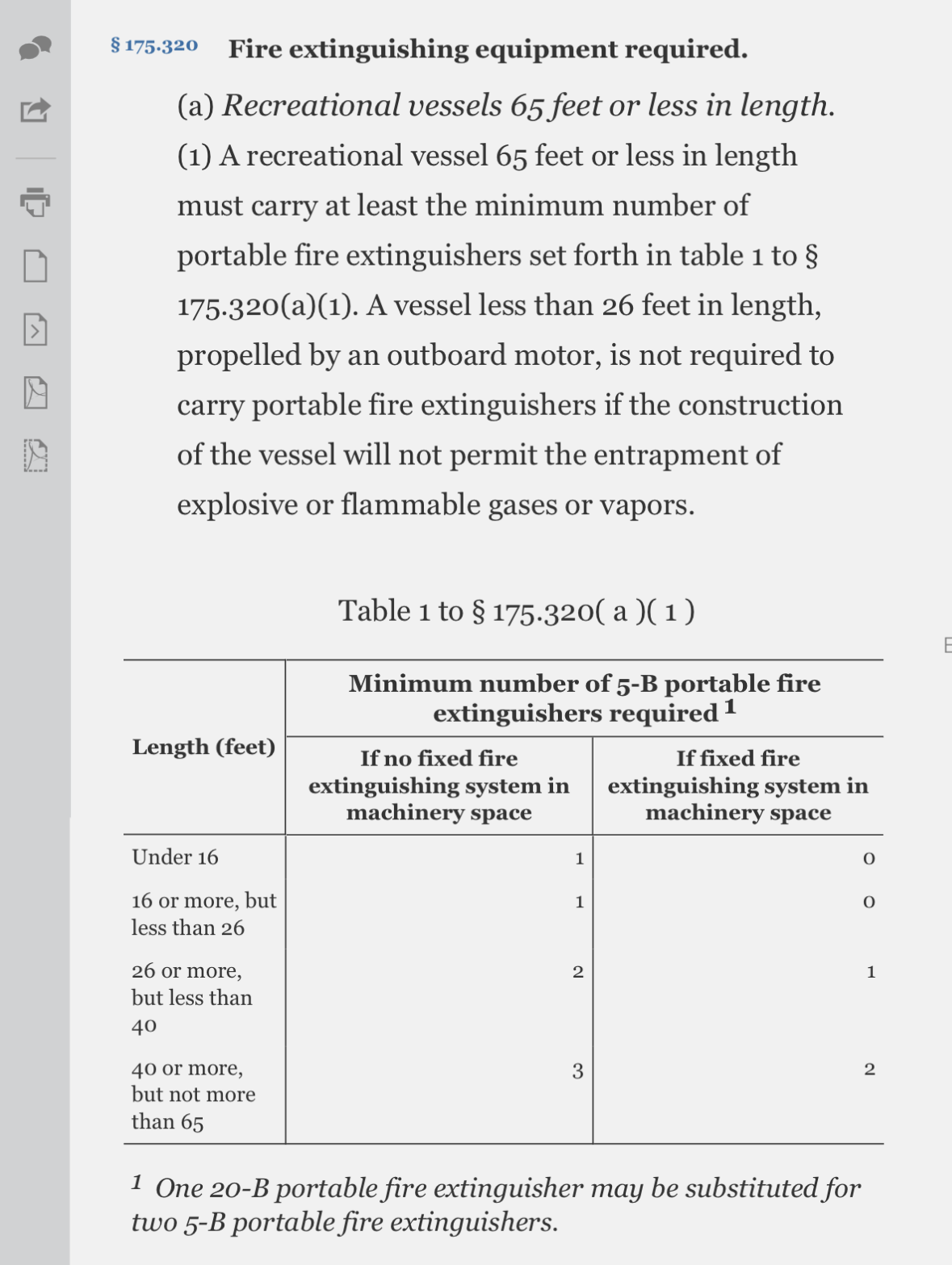

Put this in Google:
change in uscg fire extinguisher requirements
Bottom line is that the requirements changed in 2022 and are different for pre-2018 boats versus newer.
And I missed that you're a Canadian - All good
