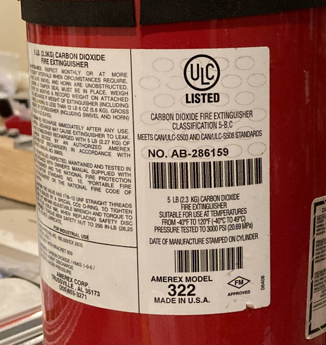

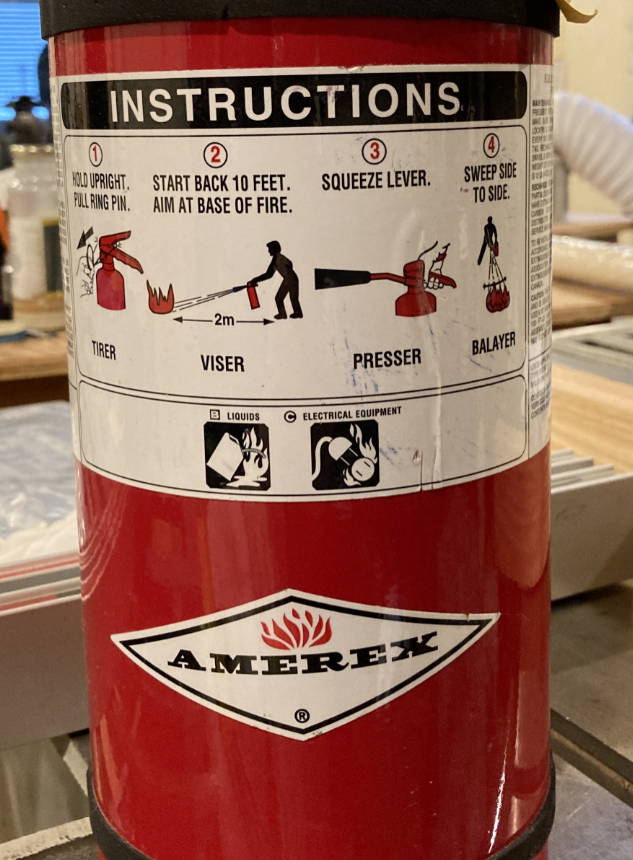

Jan 4, 2006
7,870
What CO2 extinguishers are you using? Quick search reveals prices over $200 for a 5 lb CO2 model.

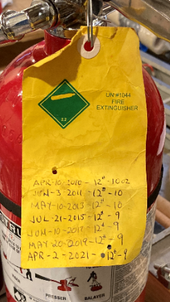

Finally dug this up. It's an AMEREX and if memory serves me right, it was well over $200.00 CAN when I bought it 13 years ago.
I keep a check on the weight semi-annually (when I remember) to avoid the cost of taking it into the supplier for a weigh-in at some obscene cost. Only lost an ounce since 2015 and holding steady so not too worried.
At the steep cost of these, this gives you an idea how much I am against releasing a dry chemical ext. on board. I wouldn't hesitate a second to discharge a CO2 at some small fire but without it, I'd rather try to beat out a fire using the body of a dry chemical ext. rather than discharge it on board. The CO2 is always kept in a dry location and is presently in as new condition. Not sure if they require recharging and too lazy to look it up. It does eliminate the need to have the dry chemical recharged every 6 years (Transport Canada).
