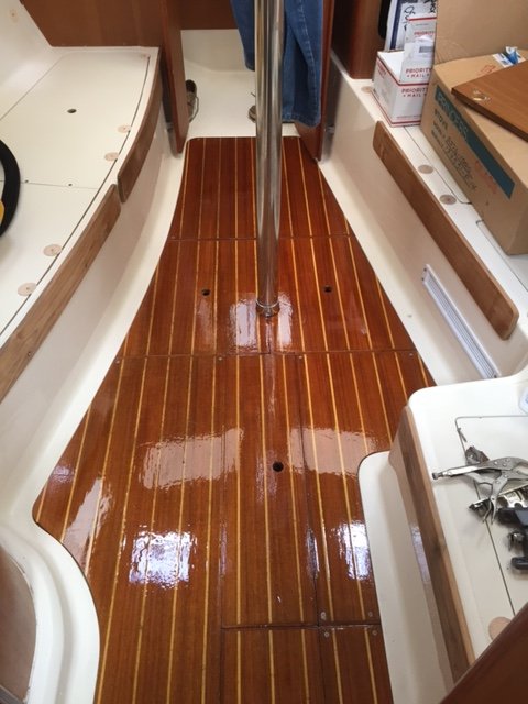

Finishing cabin sole on light duty cruiser (Hunter 310). Will use man of war. Question is do I seal underside or just topside? Bilge gets wet so Im not sure if finishing underside will help trap water in wood? Or just the opposite? Top wil get coats wiped not brushed basically to keep the wood from absorbing dirt (again).

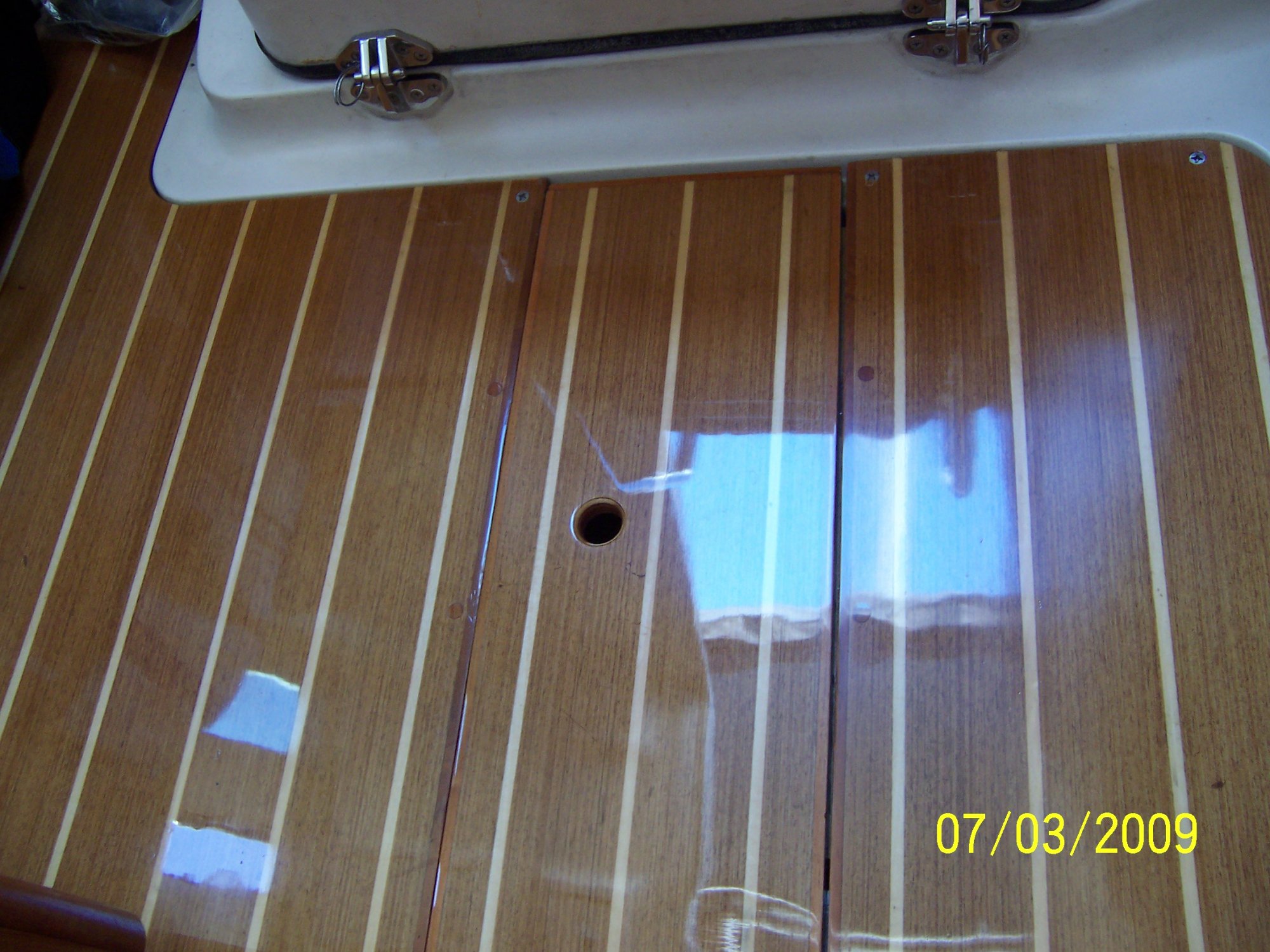

Did the same to mine after 10 years of use. I can only presume the factory finish was about one coat of varnish.
I had let all boards sit in the basement for the winter to insure the moisture content was as low as possible. Slapped two coats of varnish (30% thinner) on the underside and edges. Nothing fancy and no sanding. The top side was different with sanding the old varnish to #220, primer coat of 50% varnish and 50% thinner, next 75-25%, followed by six coats of 100% varnish. Had a buddy with a hot box and stored them on edge for two months at 105 deg. F. Finally sanded to #1000 and then used a polisher with Meguiars:
Now just haul them out on to the dock and polish it every 2-3 years.

Thanks all for the tips. I much appreciate you taking your time to chime in. A lot of different options here. Originally I planned on full epoxy shell then varnish or poly for walking surface. changed my mind for a couple reasons. If there is any breech in epoxy it will seal all moisture in. Other finishes will breathe slightly and owing to the placement of these boards I prefer this. Read that spar varnish is not durable for flooring but then remembered that's what I did the floors in my house with 20 years ago. Don't like a gloss or even a homogenous look and this boat sees light use. My main interest is in sealing against dirt while keeping a look that most closely resembles the oiled teak in the interior. I have started finishing, wiping not brushing MOW thinned 50/50. Interesting the ply bottom (which looks like mahogany) is taking a long time to cure as expected but the teak & holly veneer is drying in an hour or two. I chalk it up to very dry teak (22 yrs) absorbing the finish. Was able to coat the top twice in a day. Tomorrow the bottom will be dry so all sides get another coat.

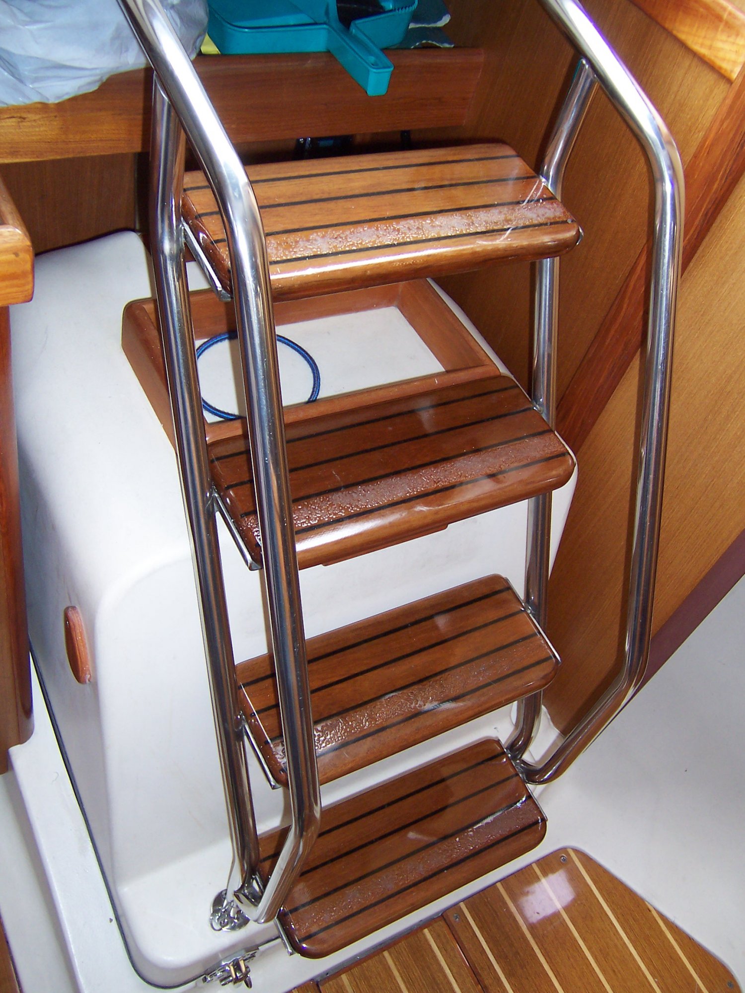

I finally went all out and covered my steps with clear epoxy and glass cloth. The cloth disappears completely in the epoxy because they have the same refractive index. Another three coats of clear epoxy and your ready for the varnish. There's not a dent in them after 10 years and no further varnish.
