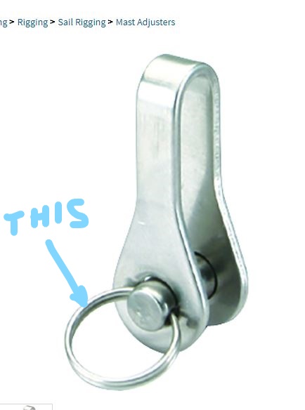

Also I was told that I should get some type of ring pins for my turnbuckles on the standing rigging. He said it will prevent them from twisting loose. Any one have a idea as to what type of pin this gentleman was referring? Speaking of turnbuckles the lifeline going to pulpit port side needs a new turnbuckle because the PO used rope to hold it up. Not sure how I didn't notice that when I bought it but in all fairness that would not have swayed me from buying it.

Ah, I was thinking that may have been what he was referring to but I was overthinking it. I guess I assumed it was some mysterious boat piece that I have never seen before. The elusive turnbuckle ring that will come with another nautical term to learn. In this case nope, just a normal split ring. Thanks everyone.

Get yourself one of these sets or similar. Keep it on the boat.
For your shroud/stay pins, use cotter pins instead of split rings. It's on my list to swap out. Cotter pins tend not to move/come out.
Buy what you need and a couple spares, as most of the kit will go unused. I have used the biggest cotter rings that would fit for 12 years on my B323 for the shouds and other connections. I can stand in one spot on the deck and see that they are all in place.

I use stainless wire and safety wire pliers to twist. I just didn't like the rings. And the wire is inexpensive. The rings shown above are the norm.

Second vote for not using cotter rings (also known as ring dings). I nearly lost a mast sailing a Precision 16 with three passengers. Someone spotted the leward shroud swinging in the wind and asked "Is that supposed to do that?". Only some quick thinking by the admiral saved the day. She quickly lashed it down with some 1/4 inch double braid that we happen to have laying around and I was able so sail back. Later found the mangled cotter ring in the cockpit. My best guess is that it got snagged by a dock line and twisted off but the friction on the pin was enough to keep it in place until the first tack. No more cotter rings for me.

It depends on the size of the hole in the turnbuckle. I would say the 1/16 will do fine. The primary purpose is to keep a fine tuned rig at the tension settings. I tune the Hunter by feel, but would be thrilled if someone had developed a tuning guide.

Thanks Dfed, I'll order me some.

I use stainless cotter pins, can't recall size. Try to get short ones, or if not available, bend the wings back and cut them off so you don't snag the sail. If you have turnbuckle covers, all you need to do is bend the wings back enough so the cover slides down. I did not realize the split rings were so prone to failure, I don't use them just because they are kind of a pain to split open to install.

Split rings are no more prone to failure than stainless wire or cotter pins. There should be no load whatsoever on these things as they simply secure the fixture.
