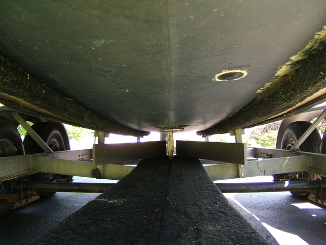

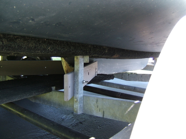

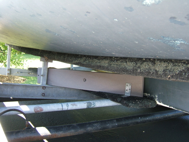

Tom,
My trailer probably had about 2 miles put on it after it was delivered to Wisconsin. Although I checked them before bringing it home, I think I actually overheated the bearings on the way home. If I were to replace the lights, I'd spend the extra money and put in LED's, they'll last forever. If you're replacing the bunks, add these pieces to the bottom to guide the keel on, they really help.
John

John, I believe my trailer already has those on it. This is not too good a picture, but it shows something similar.
I plan on replacing them as well.
