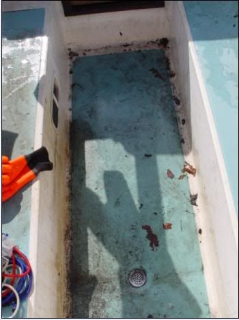

SailingDog, I see what you mean. When I look at my cockpit, it could definitely do with being raised several inches. I don't know how many gallons mine holds, but I am sure it is a lot. I will have to measure the cockpit volume and get the cubic feet.
Thanks for pointing that short coming out. I would have never noticed. Being a newbie to sailing.

I would highly recommend adding a full bridgedeck to your boat. It will help prevent water from entering the cabin, and is a relatively easy project to do on most boats.
If you sail in the ocean where there are storms with big waves.... well, it's a good feature to have should you get pooped. However, I notice you sail on a lake.... so a bridge deck would be a pretty low priority for a trailer sailer. More better to enlarge the existing cockpit drains, or add another.

Lakes can actually be worse, since the wave height is related to the water depth...and wide shallow areas of some inland lakes and places like Pamlico and Albermarle sound can generate really nasty, high, short period chop that will dump a lot of water into the cockpit. Drains only help so much...

I've never seen the chop on Lake Pepin get above 2'. I've been out in the worst weather our area has. No boat has ever pooped on this lake.
Rain in the summer downpours are a bigger threat to the cockpit. The drain must keep up or the accumulation will flow over the bridge deck.
