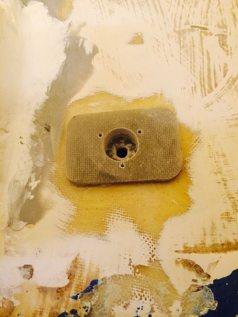

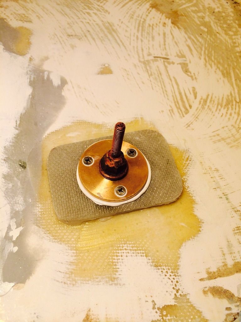

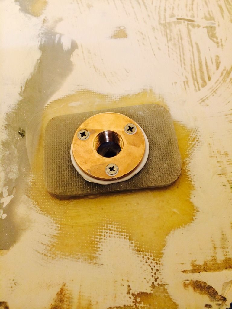

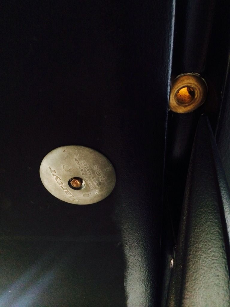

Here are some pics of the remote anode system I created using a Groco TD-500 Garboard Drain Plug ($11) as the base fitting to mount an anode on the bottom of the hull and electrically connected to the Keel Winch.
I have not added the wire yet, and still need to get some small hardware pieces (bronze lock washer), but you get the idea; I will do a more detailed write up in my resto thread.
