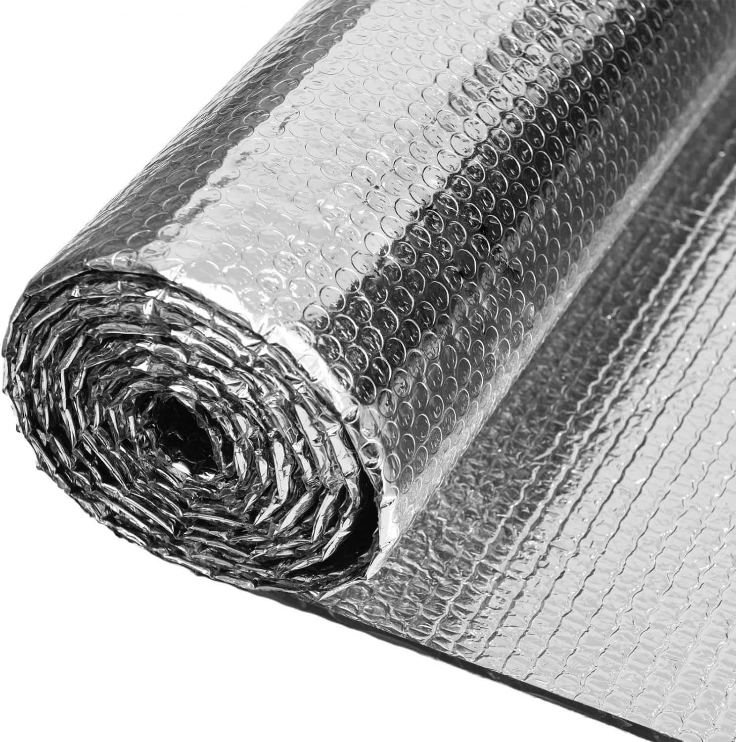

I love my diesel heater. Sleeping the boat a couple winters ago when temp outside was 11F and the storm raged. I was a cozy 68F in the salon. This past winter was mild, temps ranging from 38-51F. I have an oil filled electric heater that keeps the boat at about 65F. Very comfortable. It takes some time to raise the boat temperature as the hull is cold to the touch. I used some rolls of bubble insulation on the hull in the V Berth, over the hatches, and the salon ports, which helps to reduce the chill and saves the heat during the night.

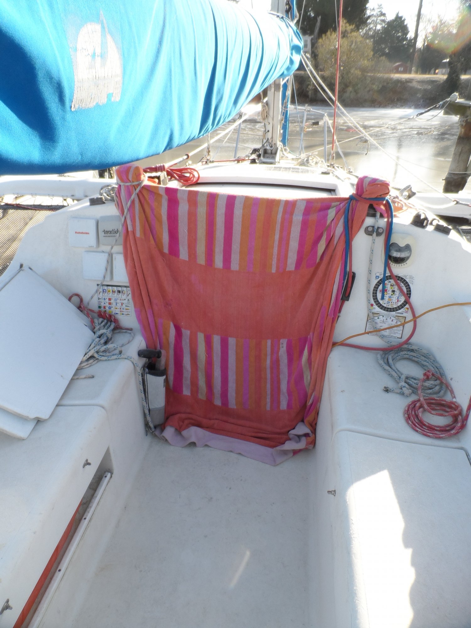

Throw a large beach towel over the companionway to reduce drafts. Easy. Often, you can secure it with the winches. This worked so well that I later built a two-layer (inside and outside) version with a window that replaces the drop boards. Very warm. I can typically heat-up my 24-foot boat in 15 minutes or so. If your house was 20 degrees, furniture, walls, and all, and you turned on the heat it would take several hours to warm up.

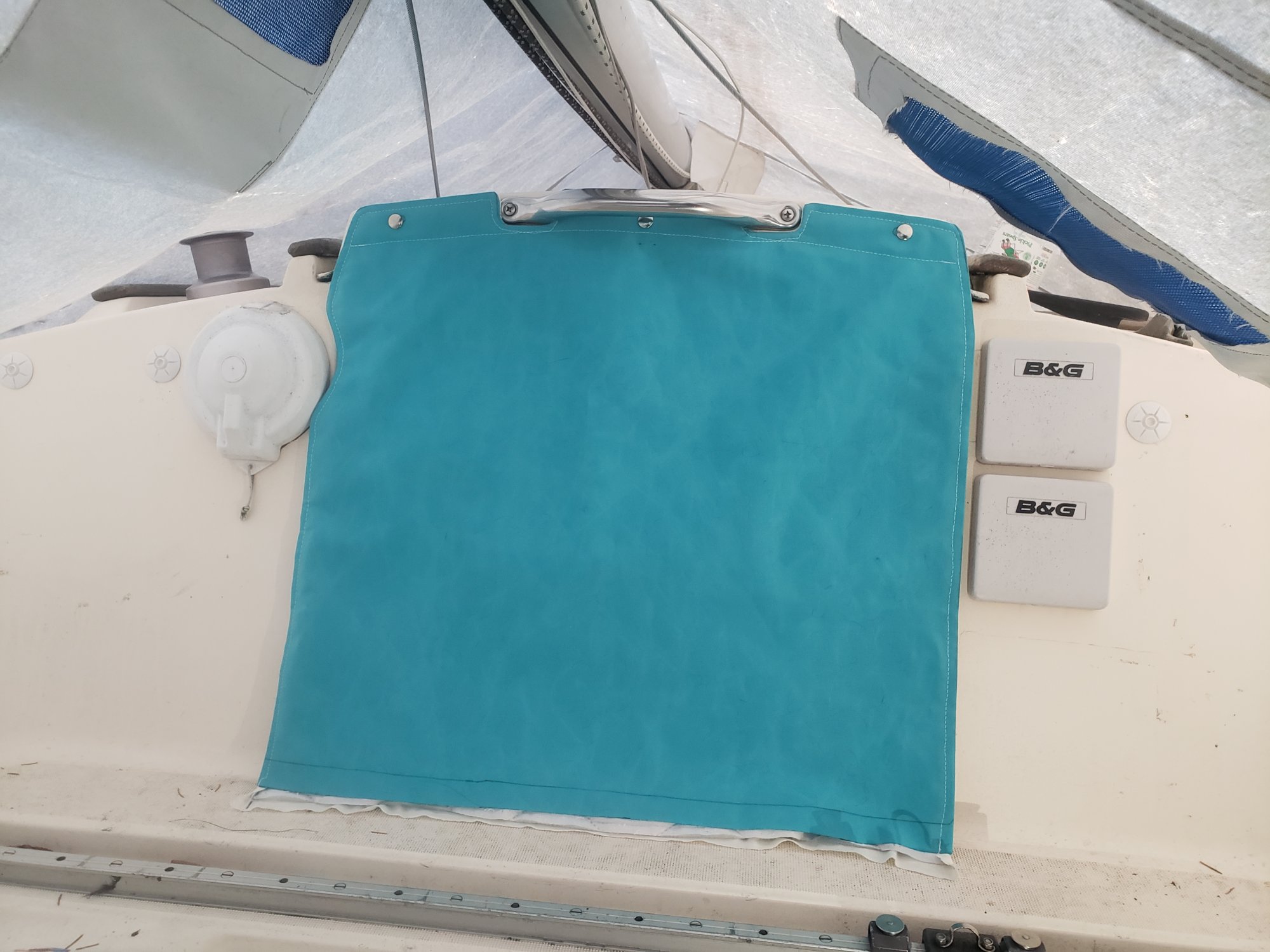

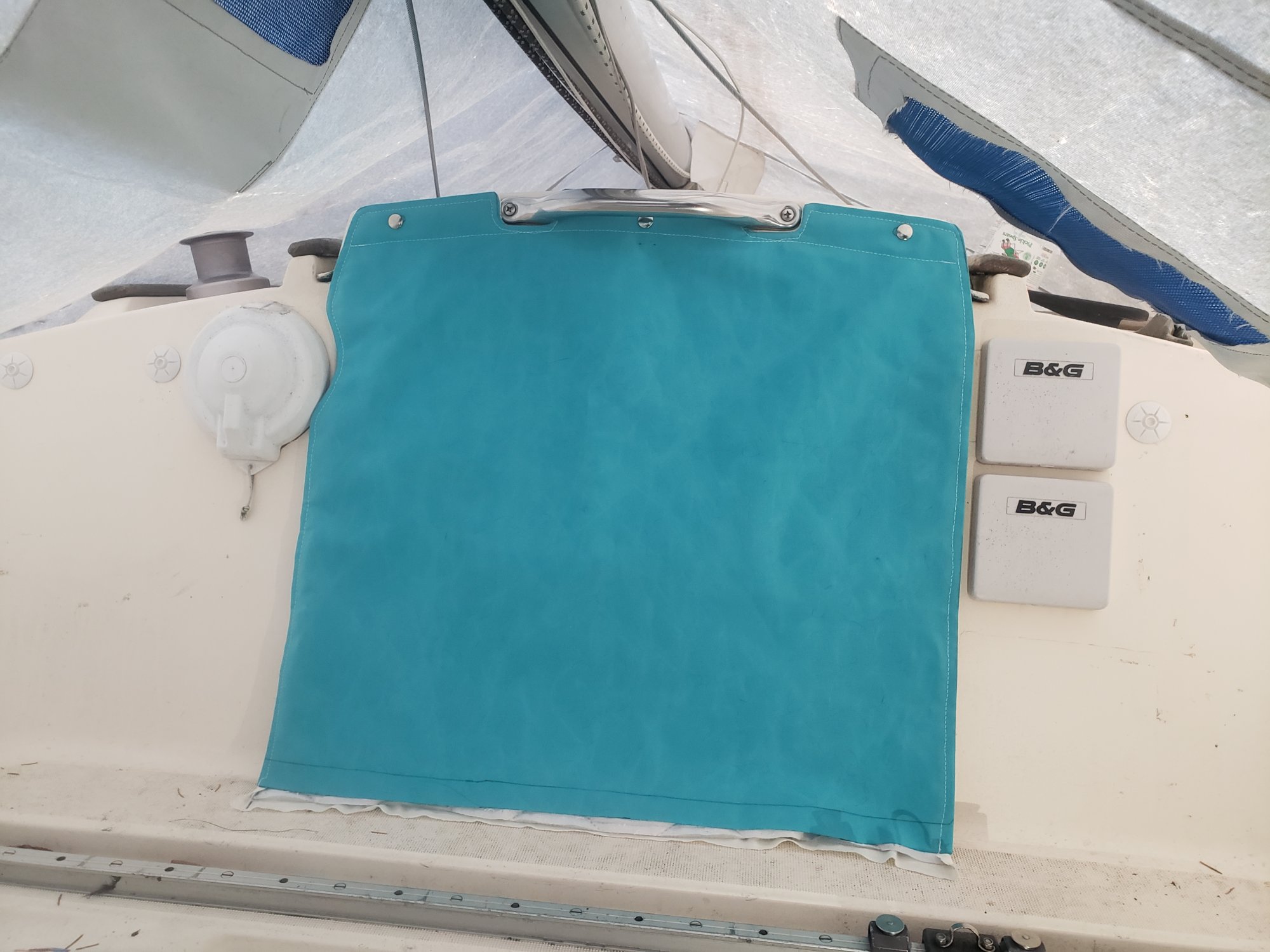

A few years ago I made this companionway cover to help keep the boat warm. Sunbrella on the outside, polyester insulation, and some random canvas for the inside. It turned out to be extremely handy in other situations too. If it's raining or cold but Ineed to go in and out frequently, I can use the cover alone and leave out the washboards. It's easy to go in and out and yet the rain and cold air mostly stay out. I modified it from the photo to put the snaps on the inside of the sliding hatch to keep out water dripping between the gap.

I too have a snap on companionway cover. It's much more convenient than hatch boards when you have to go in and out frequently. Even though mine isn't insulated, I didn't notice much difference in leakage. Unfortunately it's on my repair pile but thanks for reminding me about it. Perhaps I can get the stitching wrapped up today

My beach towel suggestion was a get-it-done solution for the OP's current problem.

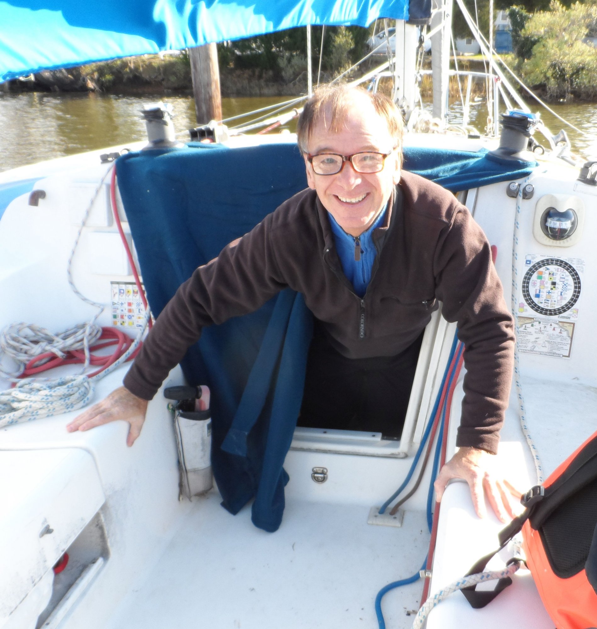

A week or two later I made this one, with reinforced holes to drop over the winches and a chain in the bottom seam. Fast to slip in and out, without chilling the cabin. Later I added snaps, so that I could use it when sailing. I also added a window. Mostly, I just drop it over the winches.

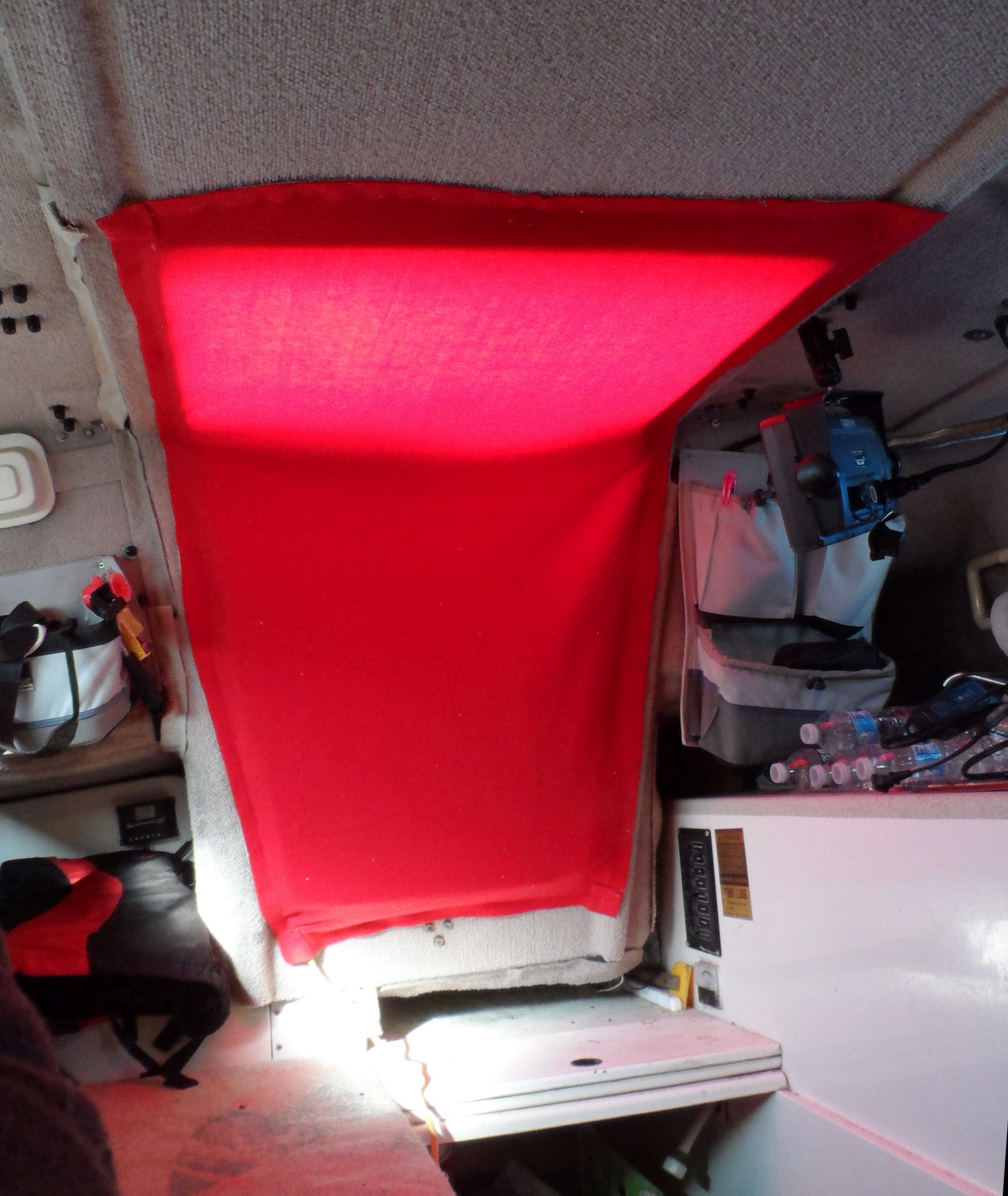

Later, I made an inner blanket to make it really snug. Not used when coming and going. Zero draft, but it still breathes enough to prevent condensation without needing to crack a window.

The headliner in the photos is 25 years old, and I have not been easy on it. They clean well with the proper cleaner and an upholstery vac.
If you don't want to drill holes, YKK SNADS work quite well. Good on the deck as well. The all-plastic ones are best.

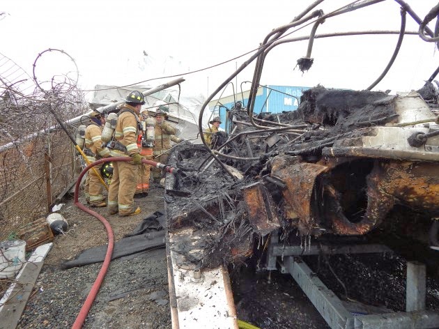

Don't forget the fire hazards of portable heaters. A fellow formite went to the chandlery for some parts. 15 minutes. He came back to this. Something fell on the heater. Turn them off when you leave and place them very carefully.
