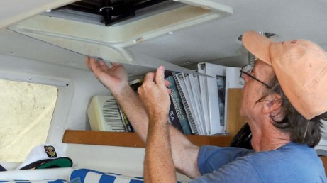

External canvas (Sunbrella) covers block light, but they can be light colored. They help the hatches last longer, so all of my hatches and windows have removable covers. However, they also provide considerable insulation, including the frames.
Bubble wrap is also a fast, cheap insulation expedient. What with Amazon shopping, we all have too much. Cut to shape, spray the window with water, and slap it on. It will stick and stay. Really. Ugly, but warm.

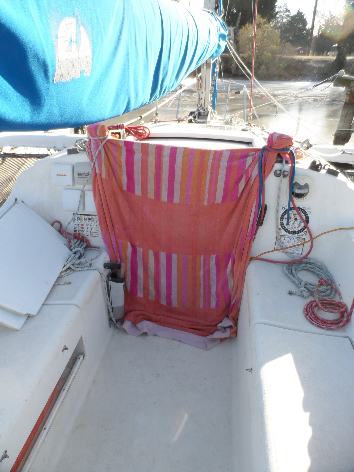

Throw a large beach towel over the companionway to reduce drafts. Easy. Often, you can secure it with the winches. This worked so well that I later built a two-layer (inside and outside) version with a window that replaces the drop boards. Very warm. I can typically heat-up my 24-foot boat in 15 minutes or so. If your house was 20 degrees, furniture, walls, and all, and you turned on the heat it would take several hours to warm up.
