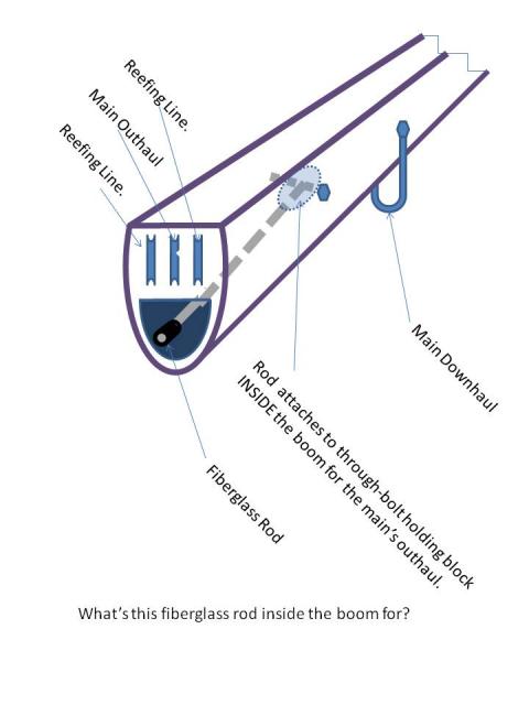

GOOD TRADE is a 1978 Pearson P-31, hull #14. Looking from her stern, into the back of the boom, you can see a small, 1/4 thick, fiberglass rod with a 1/2 to 3/4" botton end.
See the diagram, please. Getting a good picture did not work out as the rod is inside a very dark area.
What is this rod for?
I add on 6 July, I tried to move the rod but it "seemed" stuck. I will return Thursday (& July) and try with more force. Also, note, I tried to get a decent picture but no luck do to sunlight, shadow, cheap phone camera, and poor photographic skills (sorry).

It's probably where the previous owner stored his extra battens. It's a common practice for those skippers who change their battens as wind conditions change. Windy conditions call for stiffer battens. Inside the boom is a convenient place to store them.

The rod is part of a batten holder?

No, the boom is the holder for the battens, loran antenna, man overboard pole or boom tent. Remove the fiberglass rod and post some photos. We're just guessing here.

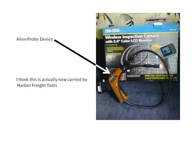

I have a friend who also posts here but as he did not tell me to drop his name, I mention him by reference only. Apparently, he was lucky not only to have contact with aliens from outerspace, but he actually saved their "probe."

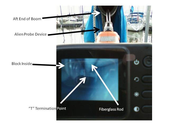

So, with a lighted device that men of a certain age might remember from a vist to the proctologist, we were able to push a camera deep into the boom to discover . . .
that seeing the termination point does not end the mistery. . .
rather . . . the rod "tees off" into the through bolt noted on the first diagram. This through bolt holds a block. The block is part of the main outhaul.
Now, I thought for just a moment that the rod might be an indicator to show how far back the block moved, but no, it is attached to the through bolt, so there is no movement.
I have a new diagram. and yes, the alien probe does, supposedly have, someway of taking a picture but I did not have the where-with-all to take one.
Also, I was told to contact HALL SPARS as I have a "Schaefer Spars" boom. I will post the new diagram and yes, will provide an update. I am thinking that this rod may be a "convenience" item left to place the block over the through bolt.

EXCELLENT !! (harbor freight has the alien probe on sale now for $79)

Any other attachments on the boom?
Can't think of any reason for a "T" that just hangs there free in the front, but if it was a longer rod that extended past the pivot bolt, it could be a release for something farther back in the boom

Can't think of any reason for a "T" that just hangs there free in the front. . .
The head of the T is hollow and accepts a through-boom bolt that also secures a block.
Please go back to the top and look at the four pictures.
The first JPEG was a diagram if what I thought I saw. Note on that, where I saw a through –bolt I noted that I suspected the rod might attach at this point.
The second picture shows the very tip of the rod, the white dot.
The third picture shows the end of the boom (in the background) and in the forefront, a picture as displayed by the alien probe. The top left hand corner of the screen is the “block” and in the center, the T intersection of the rod and the portion of this device that holds the rod at the through-bolt point.
The last picture (far right) is the probe itself.
