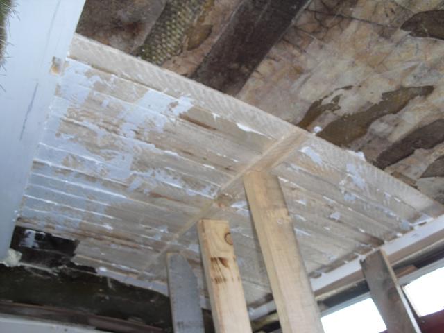

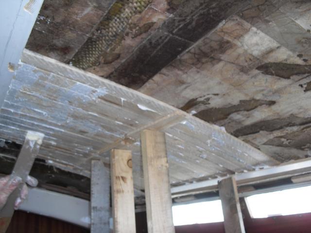

merlin here is my first layer, I am going to glue up a second layer of 7/16" T&G the oppisite direction front to rear. Question is should I glass now then install second layer, or install second layer then glass. Red
